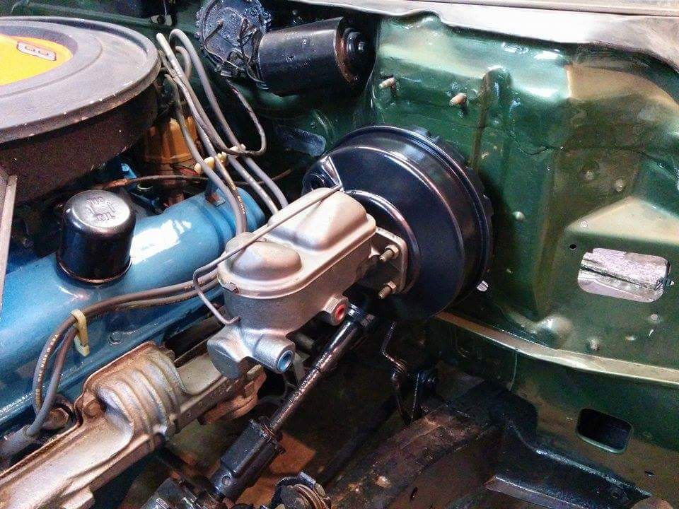

Despite what anyone may say, the arch of the brake pedal is completely different, I did this exact conversion and had to go and lay under the dash of a car in a swampy wrecking yard to get a pedal.
In the photo I was test fitting the assembly so the plate wasn't on yet.
