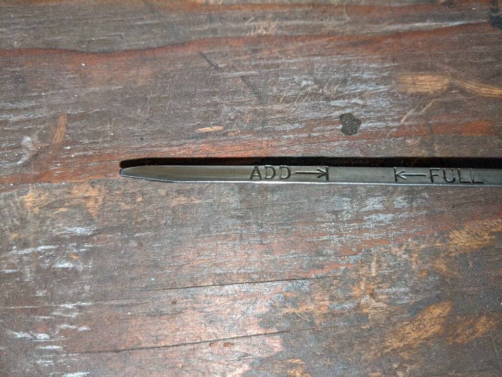

OK. I spend $8 per quart of Joe Gibbs Break in oil, 10W30. I run it for an hour in my 440. It looks like this, level slightly above Full mark. It has 2200-2400 ZDDP parts per million, non-API rated. Sounds like a perfect oil for flat tappet cam 440 engine like mine. Yet because it's break in oil, I'm advised on most websites to change it after 400-500 miles. Why wouldn't I change the filter (to get rid of the assembly lube), pour in another quart, and run it for 3000 miles, then change it? IOW, what makes break in oil bad for engines after a few hundred miles? Thanks, Ben
