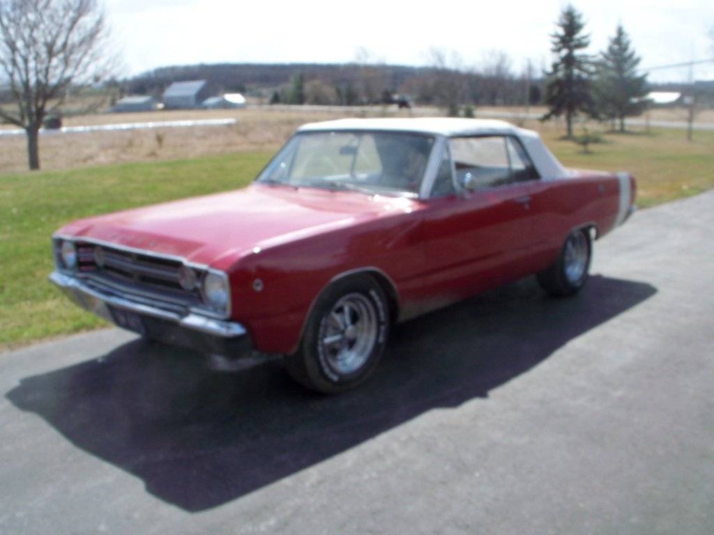

Folks,Meet my good friend Serge. I worked on his wife's 68 Dart GT 'vert back in 2016 .
Serge is a great guy and hails from Quebec Canada so excuse his English and keyboard grammar.
So let's help him out when we can with his car...and maybe some spelling,LOL!!!
Sorry for blurry pics.
hi Mr cbarge.. how are you...yes..Sorry for my english..i Will put picture of the transformation. should recived the kit soon ..thanks again for your help for thé dart.., was really appreciated.
Will keep you posted.
serge
serge
