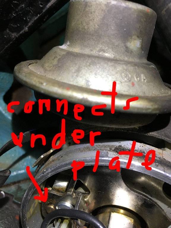

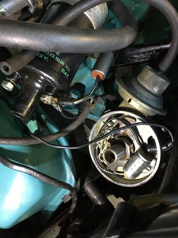

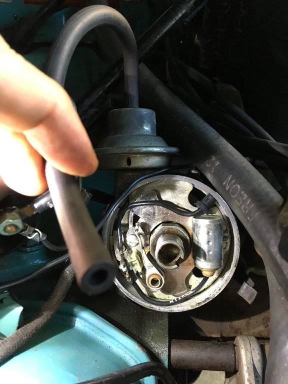

I'm finally back at the garage of my 67 Plymouth Fury VIP after a month away.. GG needs mechanical work.. plenty of top end diagnostics to be done. I want to drive her for at least part of this lovely summer! So I've decided to start at the ignition system. I disconnected the battery. Removed distributor cap and detached vacuum hose from carburetor. Then sucked on hose to check vacuum advance.. and nothing moved. Like I was trying to suck air from a stone. Hose is clear and solid. As I watched for the breaker plate to turn a bit, nothing. It is stuck. Solid. I cannot even jiggle it a little by hand.
This might explain why she has no power under load.. she can't even get up to 30mph. No advance? She doesn't jump forward when put into gear/drive like she should. And in gear she can't get out of her own way.. and I hear this poofy, popping from the carburetor when I get on the throttle a little like it's sucking too much air or not getting enough fuel. She starts up easily and seems pretty good at idle.

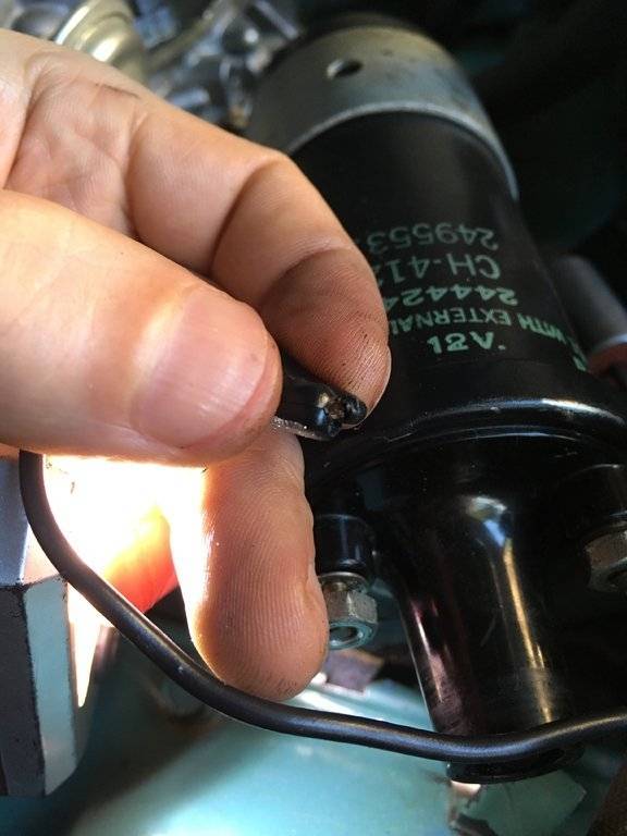

I also found that the insulation is cracked and exposing the copper wire right where it connects at the coil(lead points contact wire).
Can someone please tell me why the breaker plate won't move, and how to remedy this?
Btw, the vacuum hose is pliable, and not clogged or broken in any way.

Yes the breaker plate is still in the dizzy, I haven't removed anything but the rotor and vacuum line.. there are zero signs of moisture or corrosion so I don't suspect that's what's seizing it up... Should I start removing things one by one.. not sure how to do it without damaging something.. btw, Do my symptoms fall in line with the ones you experienced when your breaker plate seized up?
It seems to be binding but no clue how or why.
IIRC, once you remove the little clip from the arm of the vacuum canister, remove the screws holding the breaker plate, it should lift right out. If it doesn't, be careful and don't force it. The last time it happened to me, it wasn't stuck completely but sticking enough to affect performance and make the engine run eratic. If I hadn't caught it when I did it would have siezed completely.

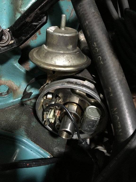

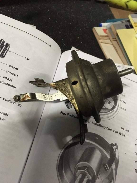

Ok, I got the vacuum chamber clip screws removed and the canister is now loose, but still attached to the breaker plate.. and when I move the canister back and forth the breaker plate rotates.. it is only when the vacuum canister is affixed to the distributor body does the breaker plate freeze up... so, if the little arm coming from the the canister is supposed to have movement, no luck. Must be frozen in the canister somehow? So maybe I just need a new vacuum canister.
Any idea how i remove the canister arm from the breaker plate safely?
When applying vacuum to the canister does it move at all? If not that most likely is your problem. Got a pic of the vacuum canister? WHat engine is this for? 383 /440?
If it goes under the plate like my 440 you are going to have problems finding one.

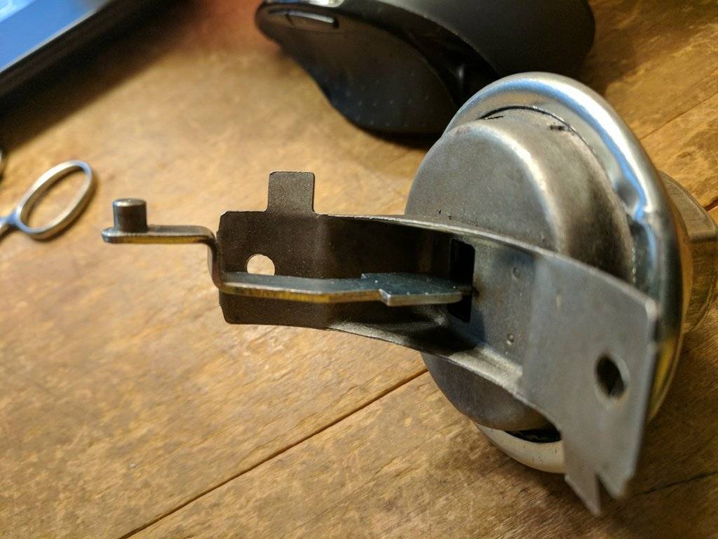

Hi, Yes it's a 383 commando.. and no, nothing moved when i applied vacuum. I attached a pic of the canister hanging loose but still connected to the plate..
will that just pop out?
Ok it's out, and it does not move at all.. is there a trick to revitalizing this or is it trash now?
And have I completely messed up my timing by removing it, and or the breaker plate?
Where did you find your replacement canister? Bad idea to get an NOS unit? Just thinking diaphragm might be dried out in an old stock unit.
I will tell you an option. Cardone has rebuilt points distributors believe it or not. They are cheap but I found the cheapest price at 38 dollars for a complete dizzy for my points car at AutoZone. Anywhere else can be 80 bucks or more. Order one up, pull a vacuum on the new reman dizzy and if all is well put it in your old dizzy. It should hold a vacuum with no leaks. Reason I say that is because my reman Cardone dizzy vacuum canister DID NOT hold vacuum but the dizzy itself was much better as my old one had a few cam lobes worn down. Another option is Tonysparts.com is coming out with this vacuum advance to fill the void but won't be out till at least August of this year. I went through all of this a few months ago. Luckily my old dizzy I kept had a good vacuum advance.
