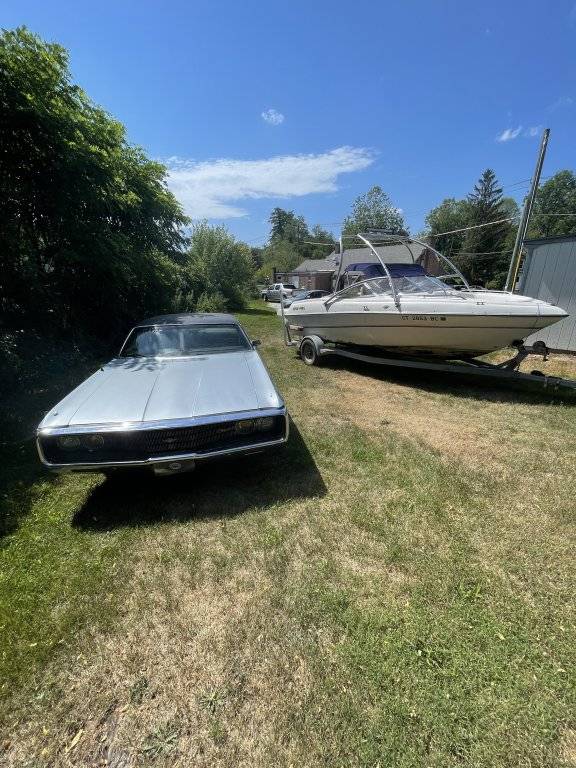

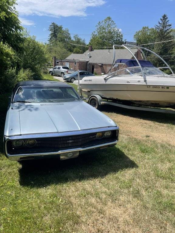

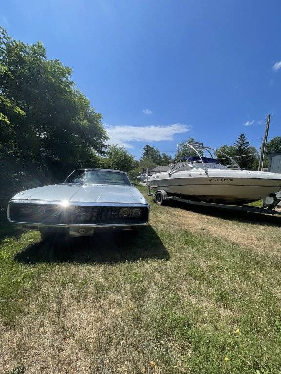

Well my Newport royal coupe (which might I say I have only seen maybe 5 others online) had sat for over 2 months. Being 17 I lacked the funds to rush into a gigantic restoration of the car but I never once forgot about the car, anyways now I have my license and the car still sat so we tried and tried and finally just after we had given up hope she cranked to life (she wasn’t picking up enough fuel) anyways I noticed that after a lil bit of backroads driving at night once I parked it, the cars engine was running incredibly hot and the contents of the radiator sounded like they were boiling. I must ask is this normal? I’ve been told I should do a 50/50 water and antifreeze mix into the radiator but I currently have no clue what liquids are in there now. Looking for any help I can get, thanks guys for being so supportive. (Here’s a picture of 2 boats, both currently land bound)

And as everyone is looking at what might be happening to cause the problem, I would like to comment what a great looking car and a great color combination. I'm sure everyone noticed but wanted to help so you can show it off.

Thank you, it’s the semi rare (atleast on e and b bodies) gb2 blue (glacial blue 2) this is why I call it my “baby blue” also a nod to a song I love by the band badfinger which was made the same year my car was

G in this case is the Mopar code for the year in which the color was introduced. E is 1969, F is 1970, G is 1971, etc.
B indeed stands for blue.
2 is an indicator of how dark the color is, running from 1 to 9.
I love GB2 (called « Glacial Blue » at Plymouth and Chrysler, « Light Blue » at Dodge) — and it’s a great fit to your car.

Man you are always good for teaching something new about these cars lol I never would have known
