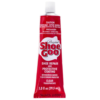

If using glue to glue it on,,
epoxy is not a good choice.. It get very hard and in time cracks.
And if it ever needs to be removed is a major pain and pretty much messes up any painted surface.
Better choice would be to use Shoe-Goo..
Bonds well, stays sorta flexible, and is reasonably easy to remove if need be..

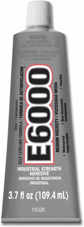

IMHO, E-6000 is a better product. It's thinner so it spreads easier and doesn't set up quite as fast. Basically the same stuff otherwise as far as strength etc.
I'm not quite convinced that it's the way to go with the emblems, but I have used both Shoe Goo and E-6000 as "problem solvers".
