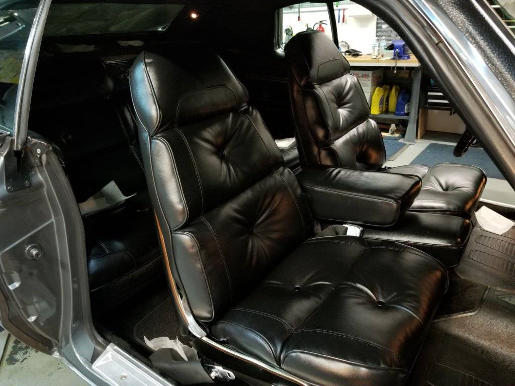

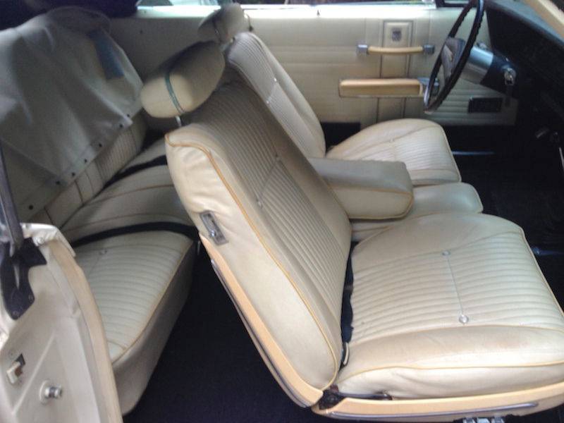

Bought my seat buns from PG Classic Restoration Parts. Not a exact fit, but very close. Had to and a little foam to the rear seat back for a perfect fit. First pic is before new seat buns.

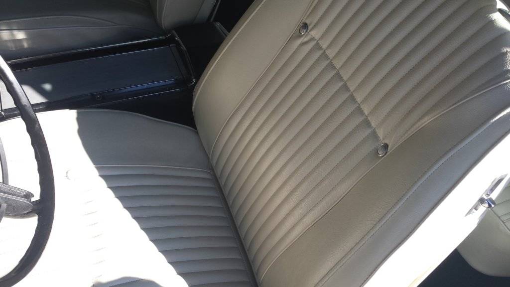

@Mark McD , Just a suggestion, but before spending the extra money on the new seat foam, try using a steamer to your existing foam. You'd be amazed how it comes back to life.
I just had the seats reupholstered on a set of bucket seats, using the old foam before the seats were covered, and after sitting in them, they feel like new again.
The upholstery guy said the original foam is much better quality than the stuff produced today, and no need to make any modifications to the foam.
If your current foam have any large chuncks missing, you can cut new foam to fill in the gaps.
