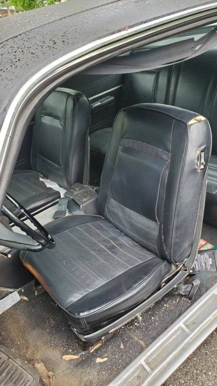

Here is a pic of the buckets in my 69 Newport, manufacture date Nov 7, 1968. Hope that helps.
The '66-'67 Charger buckets might be neat, plus the back ones fold flat for a flat cargo floor on the Chargers, which might match-up reasonably well with the C-body load floor?
