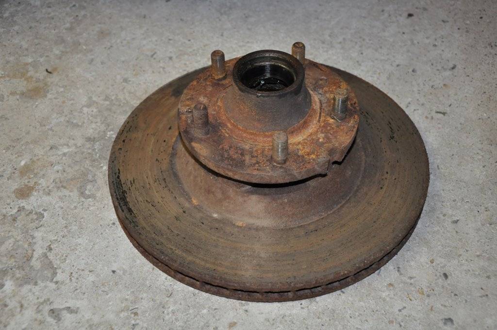

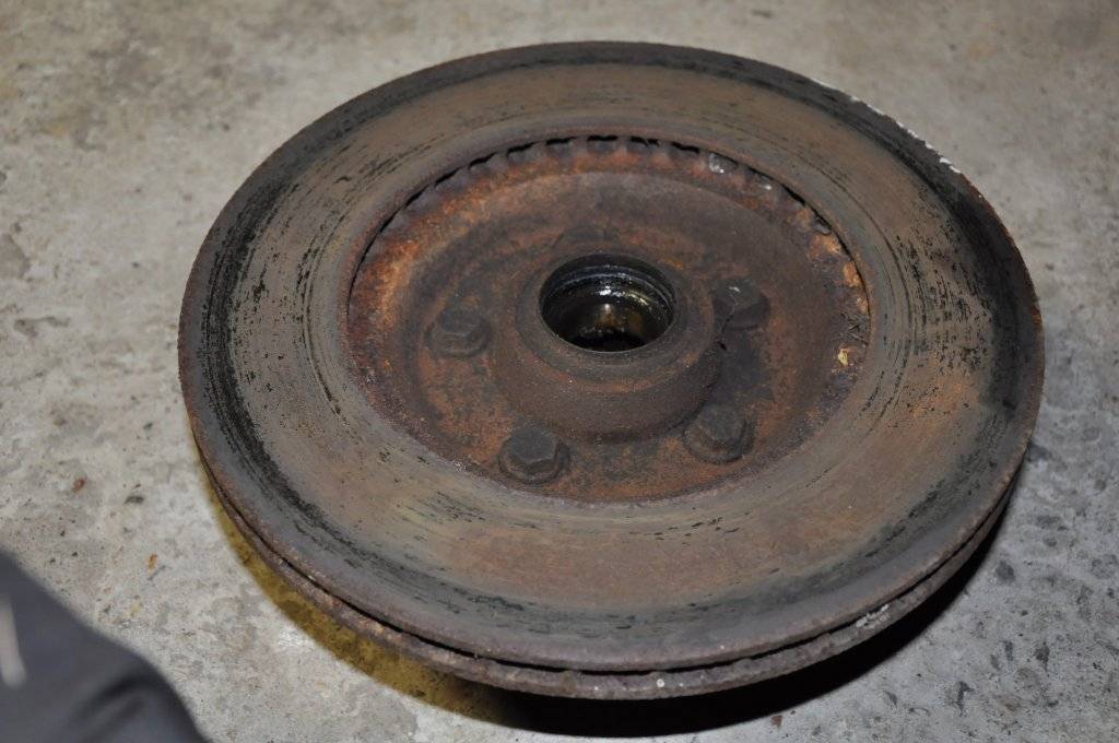

What do you mean by Rotor hat? There is the one piece rotor and the hub?
