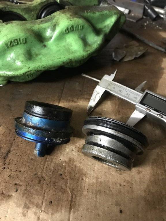

Mine leaked while sitting. they where "rebuilt"
I just disassembled them, cleaned everything and reassembled. It does not leak anymore.
I was surprised by how thin the piston bore seal was. Much thinner than smaller calipers I have rebuilt. If any debris gets in there, I can see where it would cause a leak.

I’ve just started taking mine apart I have to kinds of piston in one caliper I suspect it’s incorrect
