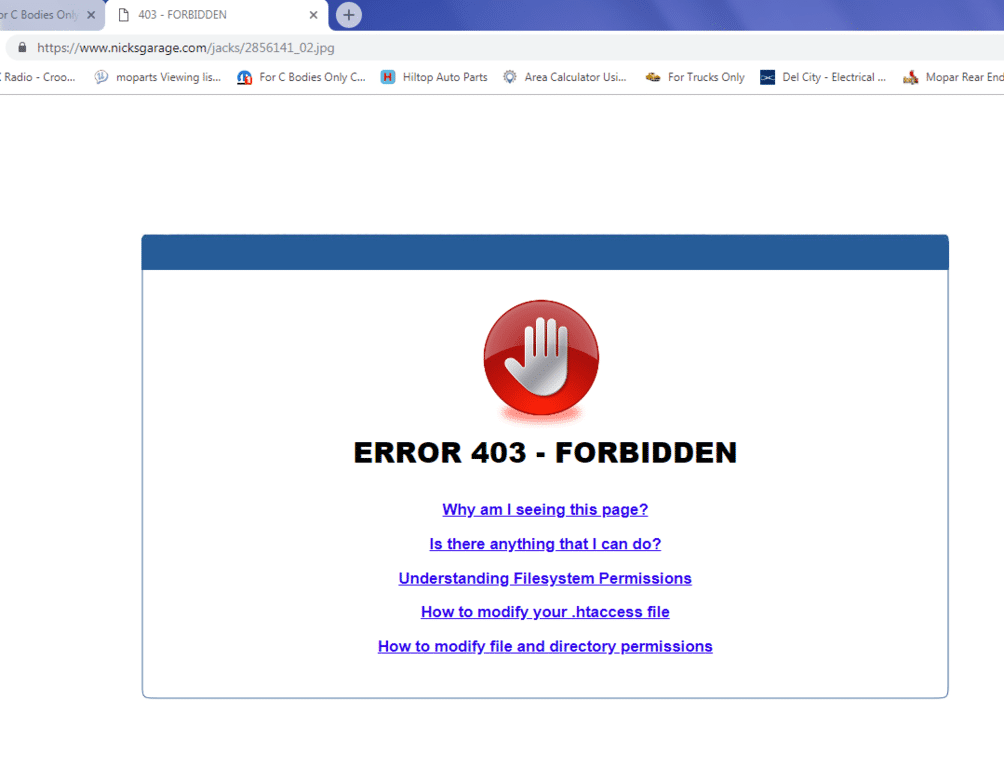

This might be a result of your local security settings, even with my highly restrictive settings at work I have no problem with this link.
Alan
Try clicking on the pictures though. That's where I got the same error, but then I reload the page, and it works fine. Somethings awry.
