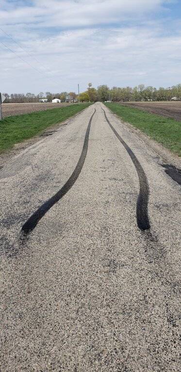

I've made 318-2bbl cars with 2.76 gears fry the tire.
You can't ease into it. Lightly press on the brake pedal, then mash the gas pedal to the floor. One quick "smack"
