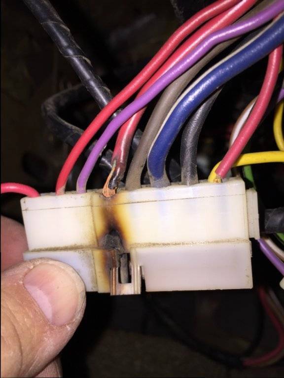

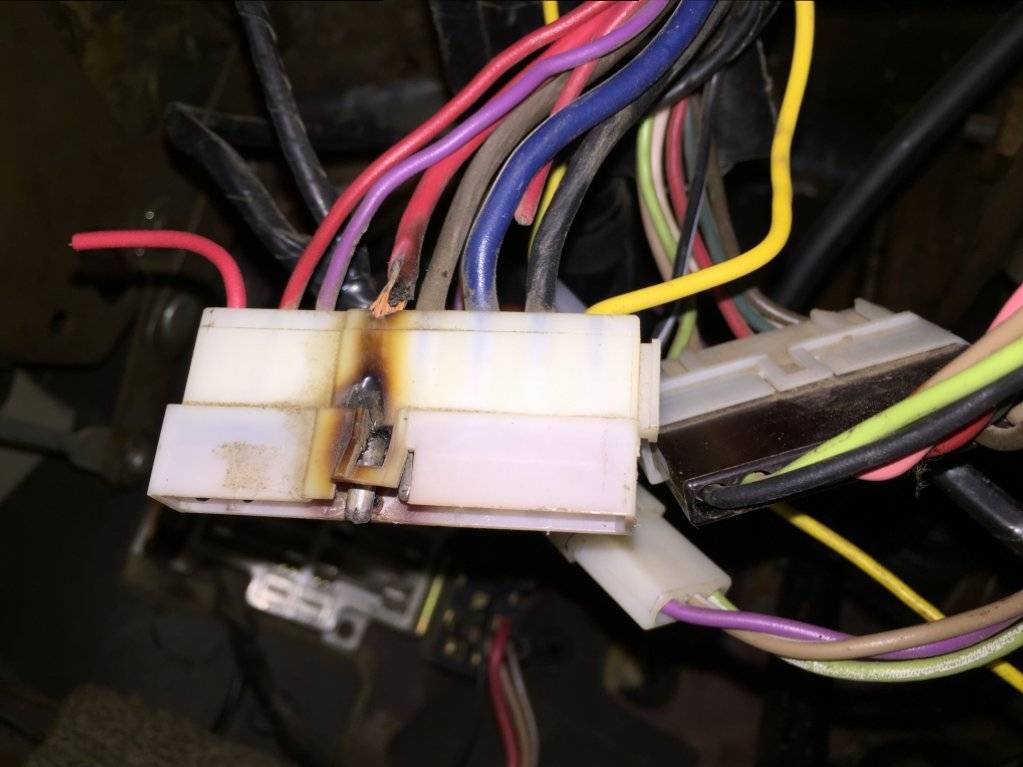

So I was crawling around under the dash and saw this. This wire gets hot hot hot. Ill be looking it up in the FSM wiring guide shortly but has anyone seen this before? Steering column connector. Everything works except horn, Flasher and headlight doors. Red heavy guage wire. It's obviously getting too much current or has too much resistance. '70 Chrysler 300 with Tilt/telescopic cruise (havent tried it yet)What say ye all?
Loose connection. Loose connection causes arcing, which causes heat, which then loosens the connection more, causing more arcing and more heat. It's an endless cycle. New tight-fitting connectors are in your future.
Exactly what my tech said. Bad connection causing arcing arcing burning insulation - bare wire gets corroded increases resistance- increases heat etc etc. So I'll trim it back and "linesman splice" it and watch for excessive heat.

That condition is standard equipment on virtually all C bodies of this era - 69-73. If you want to see it really get hot, use a 60 amp alternator and/or keep your blower motor on high when running a/c and headlights at night. The wire isn't nearly big enough for all the current it has to pass. Really skimpy design, but then the electrical pieces/system on fuselage cars at least are their biggest weakness IMO - like Stan said above.

This is not an uncommon problem. Best fix is to replace the entire wire while eliminating the connection. (You don't see any other hot spots in the wire, just at the connection). Drill the connector straight through and string the wire through.

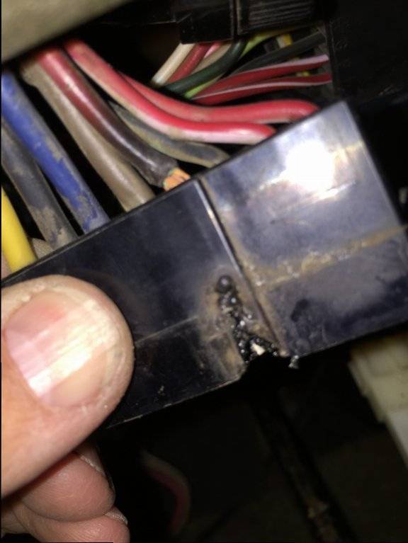

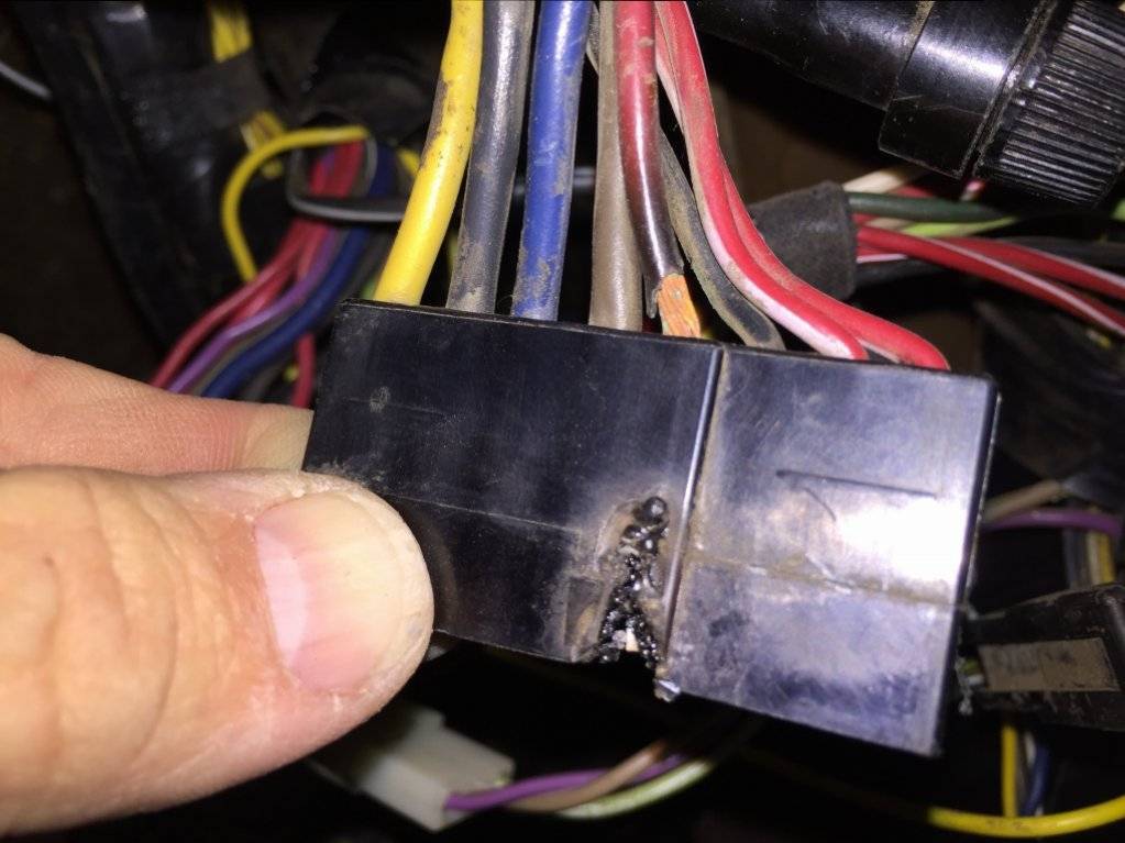

Btw that is the ignition switch connector and that wire is the battery power feed coming into the switch. If it is getting that hot make sure you check the bulkhead connector. I am sure it is starting to melt as well.
