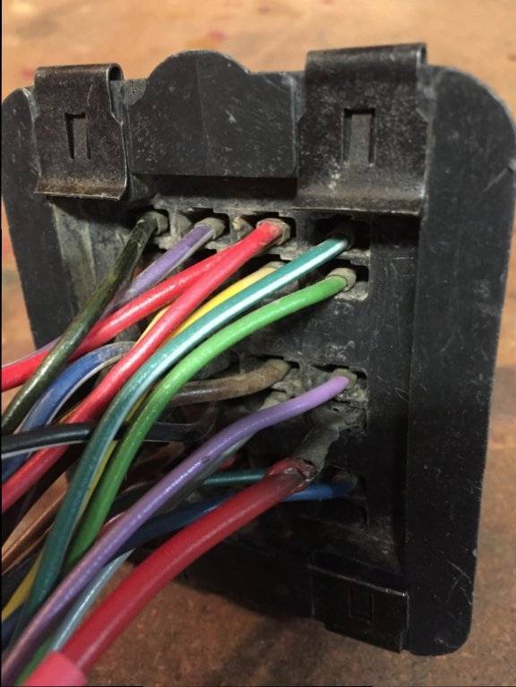

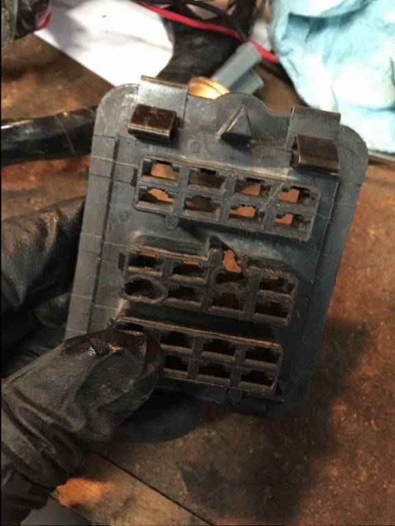

As I was cleaning up my harness (68 Polara), which thankfully is out of the car and on the workbench, I see some melting on a couple of my main power supply wires at the bulk head connector. I found a new replacement bulkhead, and am changing it out, but am wondering the root cause.
This is the circuit which runs through the J and P terminals on the bulkhead connector.
Circuit starting in the engine bay:
Battery +
A1A-10-R through Starter relay (also branches to horn relay and Starting motor) through A1B-10R to connector. Connects -A1C-16-DBL fusible link to J terminal on bulk head disconnect engine bay.
Bulkhead disconnect Dash -J terminal (signs of melting)- A1-12-R to Ammeter terminal 1 (Q1-12-Rto Accessory Circuit Breaker also connects to this terminal)
From Ammeter terminal 2 - R6A-12-BK (left terminal) - to splice / connector going 4 places(would also provide power for clock if equipped)
-Wire 1 from splice - R6-12-BK to P terminal (signs of melting) on Bulkhead connector - P terminal R6-12-BK to Alternator BAT terminal
-Wire 2 from splice- J1-12-R Feeding the Bat terminal on Starter switch
-Wire 3 from splice - L1-16-BK feeding Headlamp Switch B1
-Wire 4 from splice - Q3-12-R feeding fuse block for Brake lights, tail lamps, dome lamp, cigar lighter, and emergency flasher
My theories are:
1. Loose connections at the bulk head connector causing arcing between connectors creating heat and melting. ( I have seen oven wires do this)
2. Over voltage due to bad voltage regulator ( voltage shouldn't melt things, amperage could)
Looking for any thoughts.
That's the terminal that always fails on these bulkhead connectors and a big part of the reason everyone is bypassing the ammeter so they don't have to pass all current through the bulkhead.
Heh, Big John beat me and gave you a link.
Perfect, thanks guys. I can see why there were issues. Now to figure out what direction I want to go to keep it as original looking and functioning as possible. I might go with the pass through on the firewall (as was recommended for fleet vehicles and taxis). I have some time to think it over before reassembly. Now that I know that running the majority of the car's electrical power through the smaller connectors at the bulkhead were the root of the issue I can work around it.
I had this same issue with the Silver Custom. It included a small fire at the voltage regulator. I ended up tearing the entire dash apart and fixing/replacing everything suspicious/not original.
While I understand and agree with the ammeter bypass upgrade, the purist in me just can't do it.
The original design is flawed, but if you think about it, these cars can go years or even decades before catastrophic failure. With zero preventative maintenance.
I removed and cleaned every single wire from the bulkhead block and the three connectors in the engine bay. Anything that was borderline was replaced.
Reassembled with some electrical grease and have not had any issues since.
When you get into it, check the ammeter itself for compromises/melting/loose connections.
