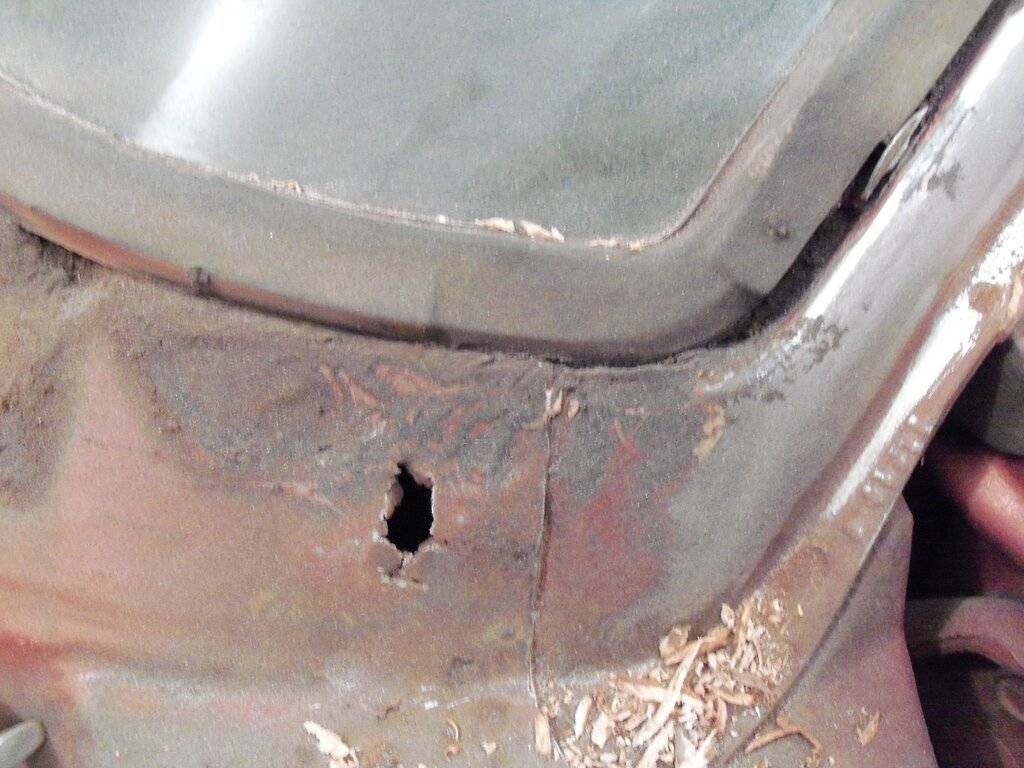

    Repaired mine..
    Also pulled the windshield and repair rust holes at window channel.

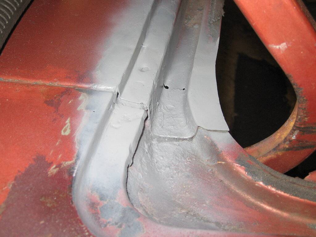

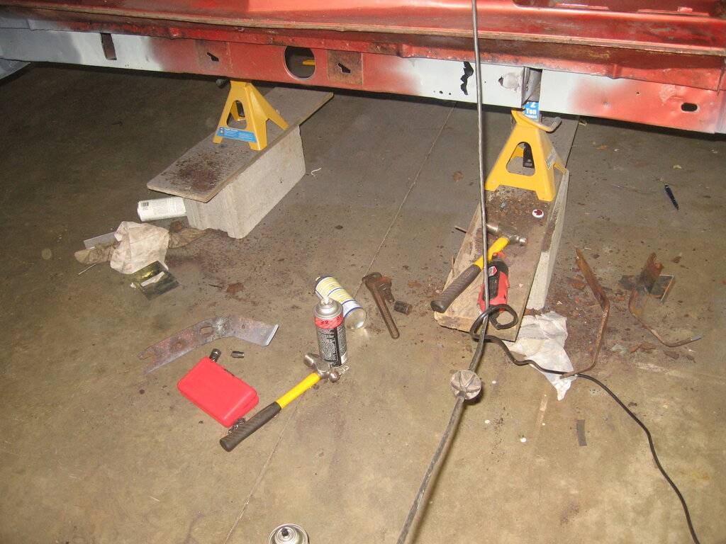

    Other common areas that you have to look closely..
    Couple areas were uncovered after taking things apart.
    BARGE ON A BUDGET 069.jpg BARGE ON A BUDGET 016.jpg BARGE ON A BUDGET 004.jpg

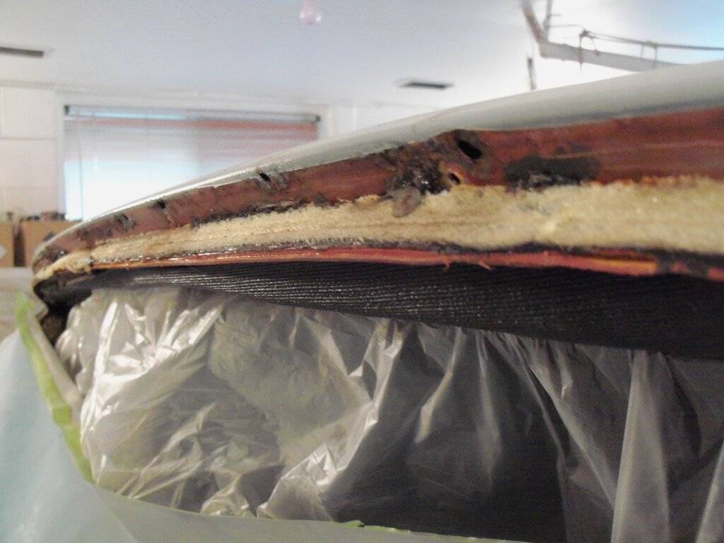

    Typical rear window damage..

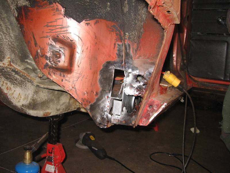

    Check the rear wheel wells at the rockers...

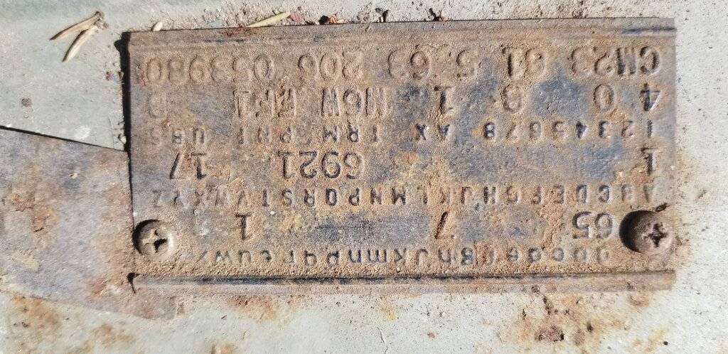

    81 = 440TNT! (correction, 81=350HP 440, 83 = TNT)
    The frost green & some other things don't seem to add up, further investigation required.

    Had a black stripe too originally. Sometimes the Frost green can look silver but this one looks very silver and has a red stripe.

    So I have looked on line to figure oot the fender plate and had no luck, I was told it was 68 - is that correct?
  18. PH27L7
    PH27L7 Active Member
    Messages:
    479
    Likes Received:
    366
    Joined:
    Mar 10, 2020
    Location:
    Pittsburgh, PA
    Definitely '68 data plate, built 6-3-68. Maybe mistaken but I'm looking at frost green body & roof with no vinyl top. Maybe data plate for a different car, perhaps inner fender was replaced?
