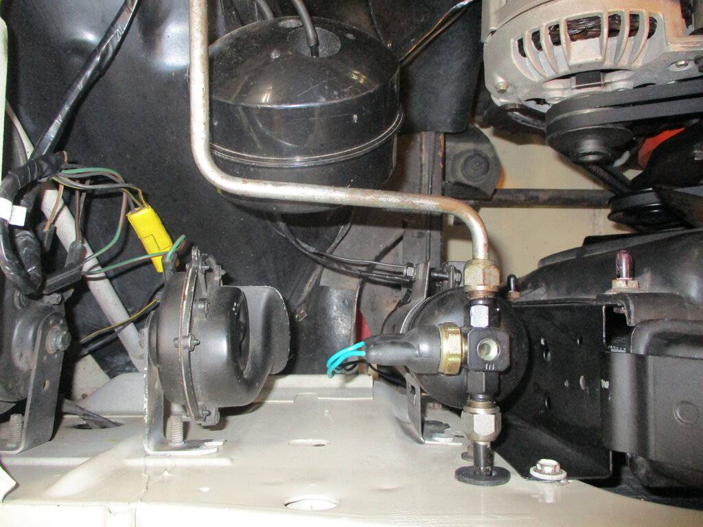

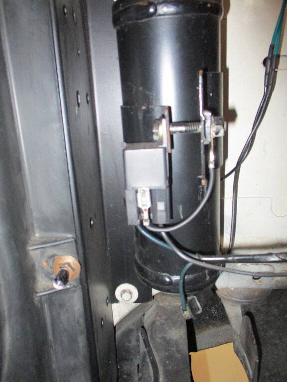

Oh....I also put in a relay for the AC clutch, taking power for the clutch off of the alternator stud. This further reduces the current thru the ammeter (and the AC switch!) by about 5+ amps.
Here's the relay, mounted at the dryer and all-but invisible to "hood open" showings.
From the top, this is all you see.

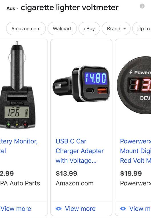

We were talking about this mod a while back and these came up. The group generally approves and say they work. I still haven’t bought mine yet but i will sooner or later.
Cheap and easy way to watch the charging system.
Depends on if you want to read the voltage from that circuit. Generally a decent reading of whether your alternator is functioning. My meter off the fuse box is no better, reading the same basic bus. One COULD run some #18 AWG right off the charge stud to a meter if one wanted a slightly better reading I reckon, but I don't think its worth it.
