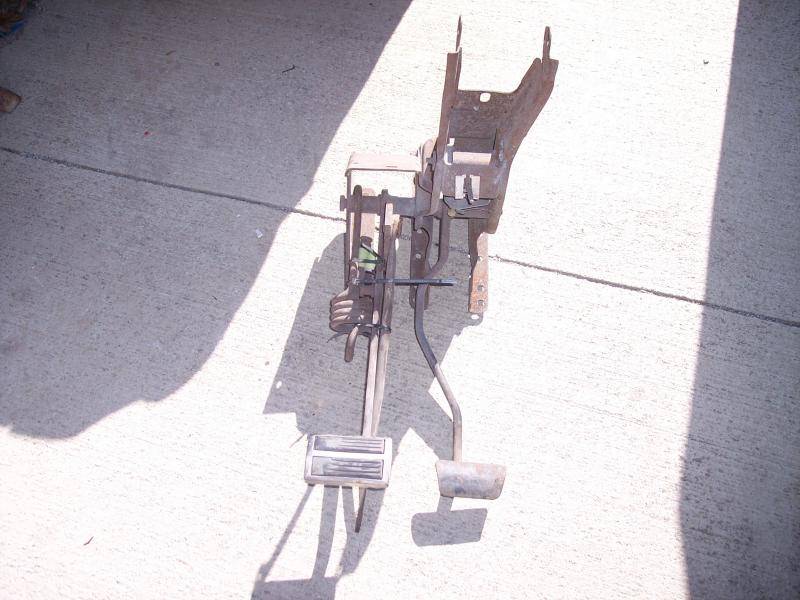

4 Speed Pedal assembly believed to have come from a 68 Chrysler, but will fit other models and years as well. Includes over-center spring and pivot and clutch rod. What is shown in photo is what you would get. Listing for a friend. Asking $150 or offer.

65-68 C-BODY 4SPD PEDAL ASSEMBLY:
I'm wondering if this is a C-body setup in the first place:
Looks more like what came in a 64 Sport Fury I stripped out. Doesn't look like what's in my car and doesn't look like the power brake ones on the shelf either.
I think your right Stan...the pedal geometry just doesn't look right.

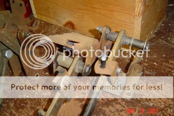

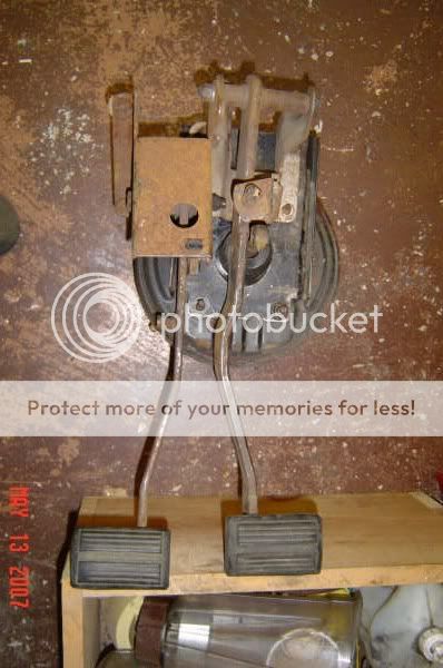

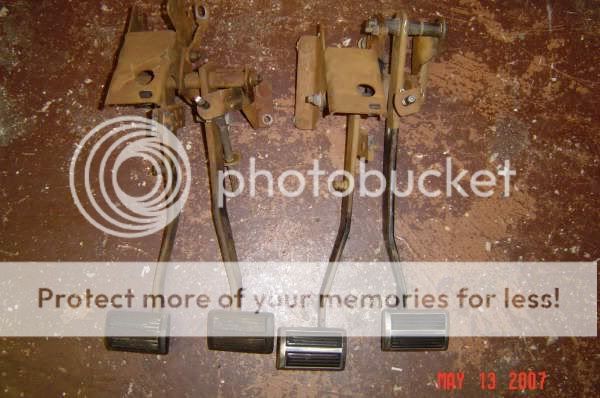

Here are the pics I have of 65-68 manual vs power brake C-body 4 speed pedals....I saved these from a C-body board member who posted these up years ago.
Manual on the left...power on the right...
Power in the fore front...manual in the back ground....
Power brake set-up on booster...

The only diff is height. Manual needed more pedal effort so pedal was higher @ same height as clutch.
Power was @ 2" lower than clutch, I.E. Less effort/leverage.
I have both for 67 Sport Fury. Hdtp is manual brakes and steering! Brake is same height as clutch. Convert is power brakes and pedal is @ 2" lower than clutch. Also have 65 Chrysler 300 L 4 speed that has power brake and pedal is lower than clutch on this one too. Tks, Tom Denkler
You're da man, Tom.
So talking strictly brake pedal arms now, the manual arm is two inches taller (higher/longer) from the pivot point where the clutch arm attaches to the bracket.
I may be totally confused by now, but it seems the first photo from thrashing cows shows the correct setups, which doesn't seem to match the text from tdenkler (because tdenkler doesn't acknowledge the difference in arm lengths between manual and power brakes) and the drawing from commando1 doesn't seem to match either the text from tdenkler or the photo/identification of arms from thrashing cows. In any case, I believe the pivot point of the clutch arm is the same as the manual brake arm pivot point and the power brake arm pivot point would be higher (as shown in thrashingcows photo). tdenkler I believe is only saying the power brake pedal is 2" lower than the manual brake pedal as installed in the car (or in other words, the power brake pedal is 2" closer to the floor than the manual brake pedal) which is correct.
In evaluating the pedals and bracket assembly that I originally posted for sale, I took a look at a 69 Polara bracket assembly and it is identical to the bracket assembly of the pedals I have, so I am concluding that the setup I originally listed is for a 69-73 C body manual transmission-equipped car with manual brakes, rather than 1965 - 68. The B body brackets are certainly not anything like the bracket assembly I have. So I think I now understand what is going on, but then it may well be that someone messes me all up again! Thanks for all the input guys.
