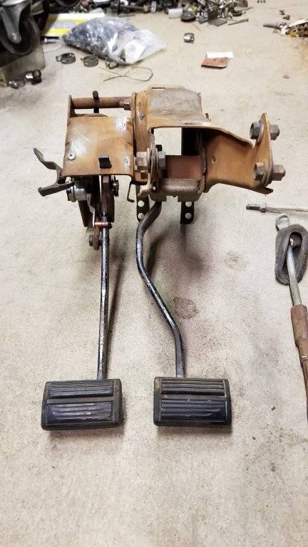

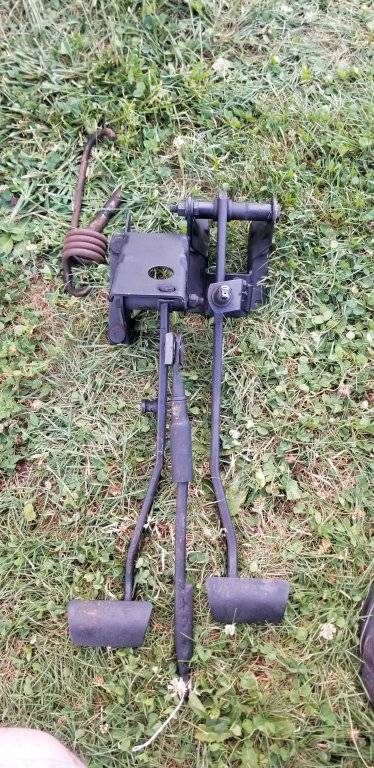

'65-'68 Slab pedals; note the pedal pivots are on 2 different plains meaning this is for power brakes:
'69-'71 Fusy pedals; note the pedal pivots are on the same plain meaning this is for manual brakes:
Power brake Fusy clutch pedals are a unicorn. I have only ever seen one car supposedly equipped as such and it was in Europe.
