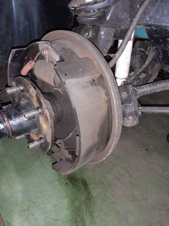

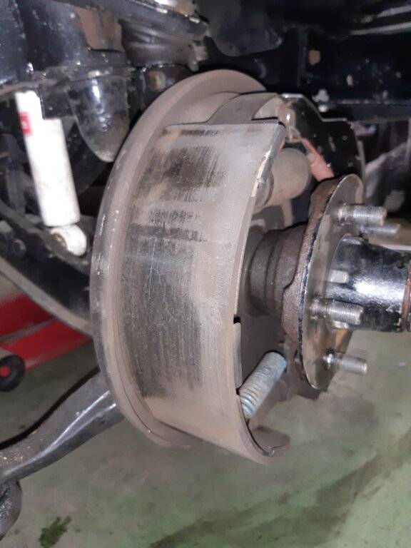

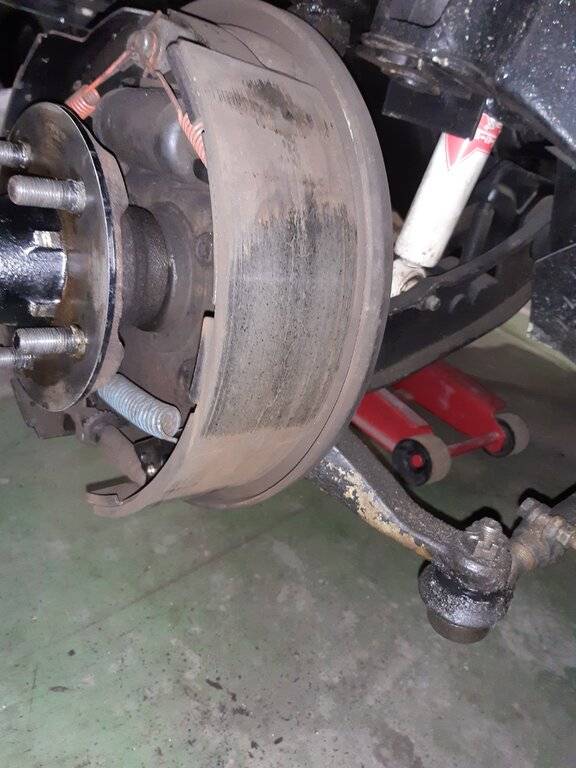

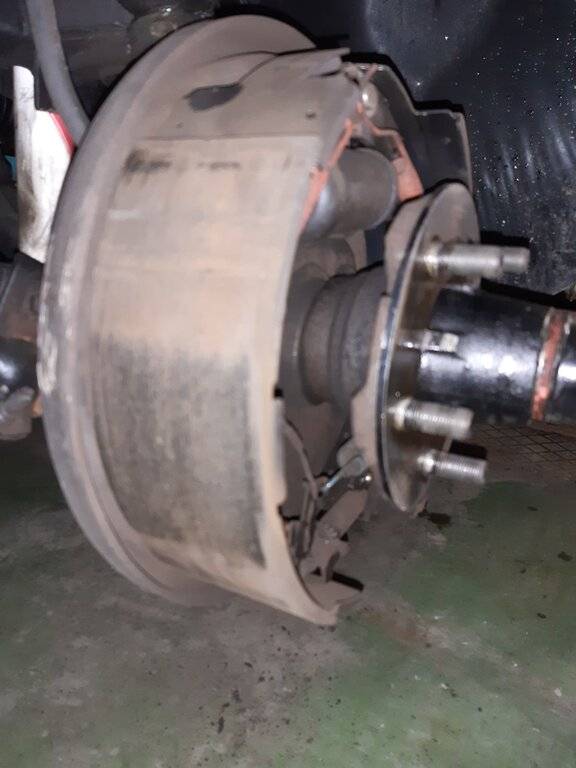

I will continue with this thread since it's on topic. I have power drum brakes all around on 69 Polara and checked the shoes in front drums today while changing the tires before the new season starts. While the brakes perform equally and the car does not pull to either side, they are not exactly grabby and the pedal is quite soft at the beginning, especially compared to new daily drivers.
Reading in the other thread, there exists arcing of drum shoe method, something I probably should benefit from. Checking the shoes today, they seem to work with just a partial area available. I switched from the finned drums to standard drums a while ago because of Magnum 500 wheels and shoes were replaced also. All parts sourced from Rockauto, the drum shoes are likely WAGNER PAB336. Not sure if they are good or junk, just what was available. I can still lock all 4 wheels if intended and passed a roller brake tester all OK last year.
Please check the pictures below and confirm, the shoes arcing need to be adjusted, don't they? The only black parts of shoes, are getting in contact with the drum itself, correct? Or is it the drum not being round? Thanks for your advice.
It appears that they are not arched properly...

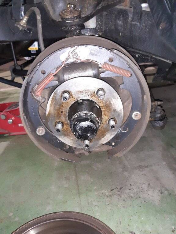

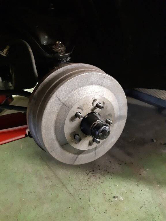

I was adjusting the front brakes recently (11x3 drums) and noticed there is a spacer ring with the holes for the studs fitting the bolt pattern, which is good 1/8 inch thick. Perhaps it's leftover when the car used finned drums many years ago, which do not fit well with my Magnum 500 rims. I now realized I should try to rotate with the drum to see/feel any interferences without this spacer in place, but it's worth asking there first. What could be the reason to use this spacer, other than not allowing the drum to slide in way too deep? Service manual does not indicate any usage of spacers. Below are pictures with and without the spacer. The adjusting cable on one picture is out of the track but I fix that. Thanks for your tips :steering:
