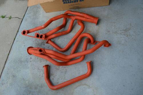

i never heard of such a thing, and found these - Vintage Mopar Headers | eBay
i dont think these are for a 383 tho. but i bet there are some. somewhere. interesting design to me - they floated 1 tube totally its completely by itself.
Those are for a small block (center ports shaped differently), but I seriously looked at doing some for my car.
