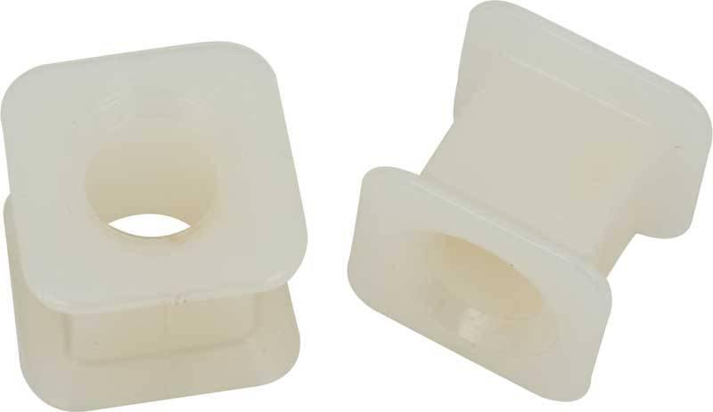

I found these on eVilbay...
These fit "63-74 A B C body trunk lid sliders", as per the description...if the center holes are large enough, they just might work.
They don't look much different than the E body versions:
Rob
That looks like one of my originals, except the center hole looks a bit smaller....I'll have to measure mine to see what size it is.
