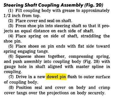

FYI, the FSM states that a new roll pin be used. I'm guessing that has never, ever happened in the entire history of Mopar steering column work. :)

I will have to see what the manual calls these pins, but they are not roll pins, they are spring pins. A roll pin is made up by rolling up the sheet steel, and is basically a solid pin. The only place I have seen them used of late is on farm eqpt....and had some there. But, to agree with points on materials, I was rebuilding an old 3 spd truck trans from a 49 Ford. The shaft on the idler gear was totally worn, so I ordered from the new supplier. When I got it, I ran a file across it, and it cut in. The OEM was hard. So, luckily for me, I found a NOS on ebay that was correct. The seller said, no sweat, no one will drive these things much anyway. Also, on the reuse of something like this, I am always cautious to ensure that it is still very tight....just as mentioned here. Thanks for info on the hole size, I do not recall which way I drove it out.....old age again.
