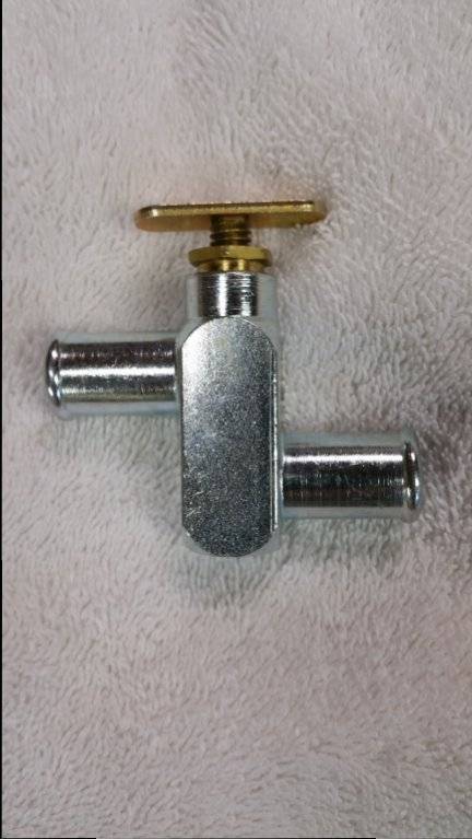

This doesn't answer your specific question but my new to me Plymouth didn't have a heater control valve even though it was supposed to. It was gone. My heat was on all the time. And full blast. The specific control valve is kinda hard to find and expensive but I will buy one sometime after I get a few other things done on the car. In the mean time I bought this and installed it and while not convenient it does the job for the time being. You can crack it open slightly and get less heat. My control valve was vacuum operated.

The heat was either OFF or fully ON. I, then too, put in an inline valve.
Years ago I had a leaky heater-control valve soaking the carpet in the passenger footwell. After pricing the big-buck replacement valves, I found out that a 70s-80s Dodge pickup truck in-line design works perfectly spliced into the heater hose IN THE ENGINE BAY. If I remember correctly, it was less than $20 (in stock) at the local parts store. I did have to pirate a slightly longer control cable to reach it. No, it's not in the factory location . . . but if it ever leaks, I won't have to rip out the carpet!
