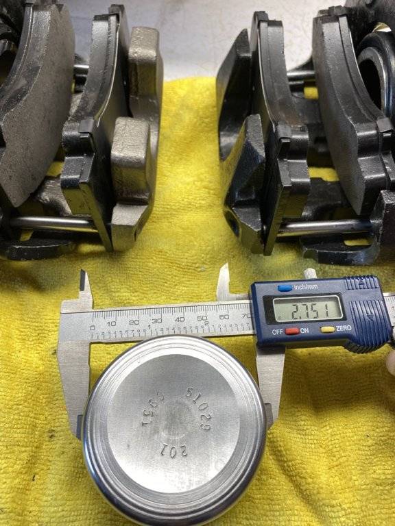

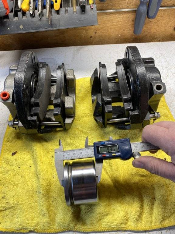

so - ordered replacement pistons. size delivered was shallower than what i have.
I need 2.75dia x 1.92 to match (original KH).
Know of a match?
They are single piston calipers. The caliper brackets and spindle are stamped 0761 if that helps. Going on a 68 fury.

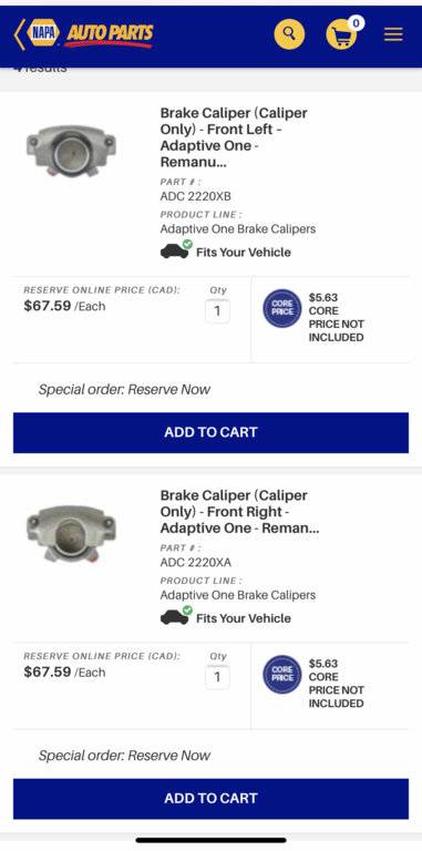

Why not get reman calipers and save a lot of grief?
have they become non-available?

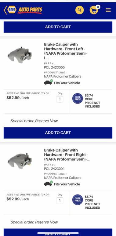

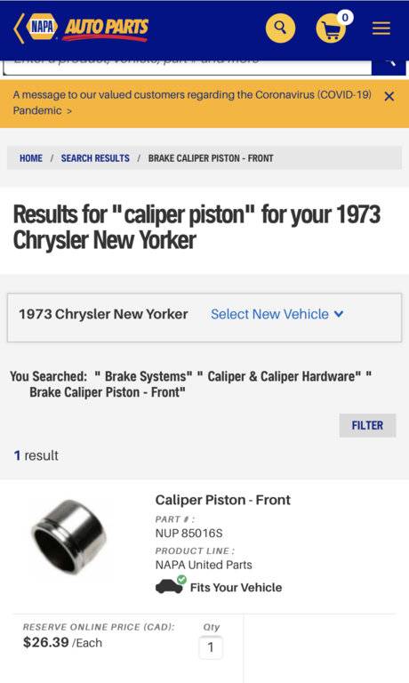

NAPA sells the piston and Calipers BUT as I found out last month they couldn’t supply the right side caliper . If you can’t source a piston I have a very good used one but shipping from Edmonton Alberta would be more than the piston. I just rebuilt the RH caliper myself, it’s not that hard at all.

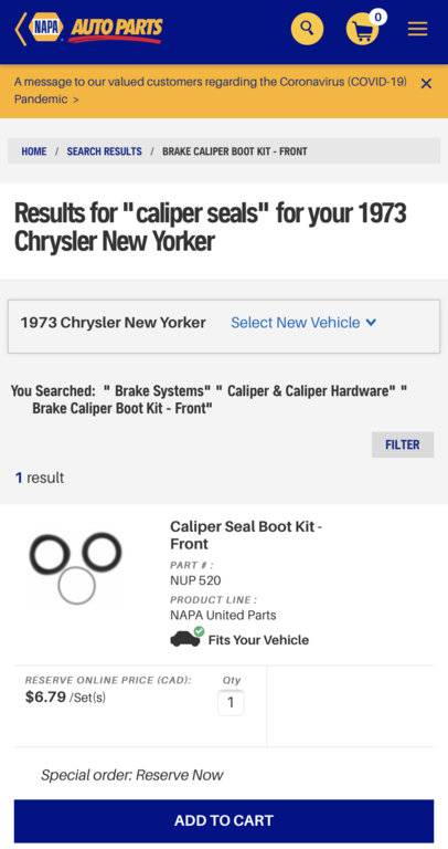

Always use new seals never, reuse the old ones. If your old rubber bushings are starting to crack change them too , They’re cheap and easy to change out .

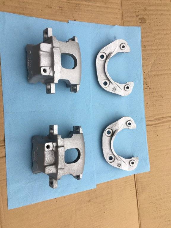

@welderguy. I Forgot to follow up with you. Thanks for your assist. Was able to get the parts and rebuild the calipers. Smooth and easy to assemble. They look great.
