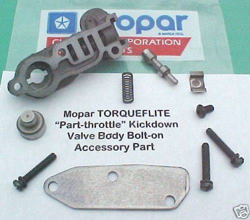

Light stall nothing agressive. I think 2250-2500 if I can remember..but in a big heavy car feels like stock.
However,I added the part throttle 3-2 kickdown to my trans and a shift kit. Very efficient and works very well with the torque curve from the motor. This mod alone even with stock convertor is a huge improvement.

Which shiftkit did you use. There are a lot of them. And is it hard to install a shiftkit?
So I'm either buying a 268H cam on the cheap to keep the same valvetrain, torque converter etc.
Or I'm buying a bigger cam, possibly springs/lifters? and different converter which adds quite a bit to the total cost?
How big is driveability difference of swapping the stock TC to a 2000-2400 stall TC?
I've bought this "Part-throttle" kit from Pat Blais :)

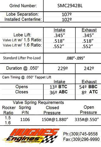

I've also talked to Hughes Engines with my specifications.
They've recommended two camshafts for my use with stock or 2400 converter and 3.23 gears.
The 383 low deck whiplash. Interesting cam but I'm not sure if I find the idling too extreme...
And the SEH2832BL-10
The SEH2832BL-10 seems more promising. (It's pretty nice that is has a noticable idle but not as extreme as the whiplash)
I'm not sure how a cam like a SEH2832BL-10 affect power brakes.
And I'm wondering how a SEH2832BL-10 cam hold up with a stock TC or if a 2400TC is a must...
I am planning to change the stock single exhaust to dual 2.5 H exhaust with stock manifolds btw.
Any thoughts on these combo's anyone?

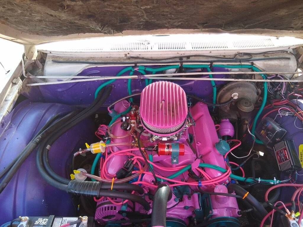

i have a 65 Polara/383/9.2-1 and just recently fired up my complete engine rebuild.
after lots of research about a year & a half ago...matching 383 commando specs as close as i could find, i went with a Howards racing cam with new Lifters & new TrickFlow push rods slightly different length vs OEM.
its runs really good, very responsive power and a sweet rumble with headers (TTI Style long tube), 2.5" Y pipe into 3" exhaust,
3" stainless magnaflow and 3" tail pipe.
if you're interested, i can get the info & send it to you perhaps this weekend. im currently in my big rig & away from my ride.
