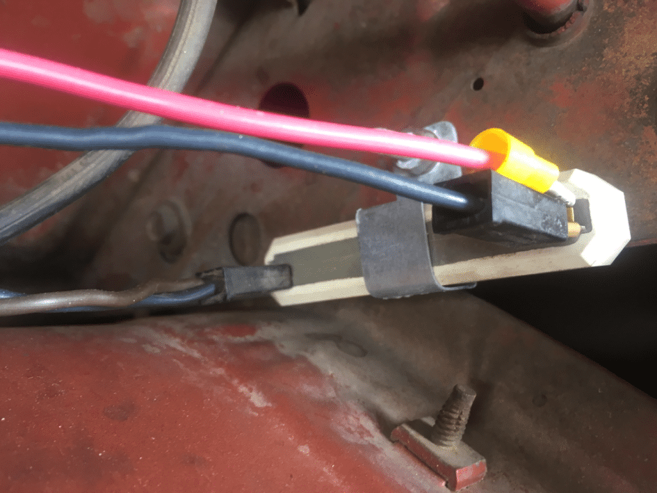

    Your cars all appear to be restored to factory spec. How did you deal with the wiring for the electric choke?

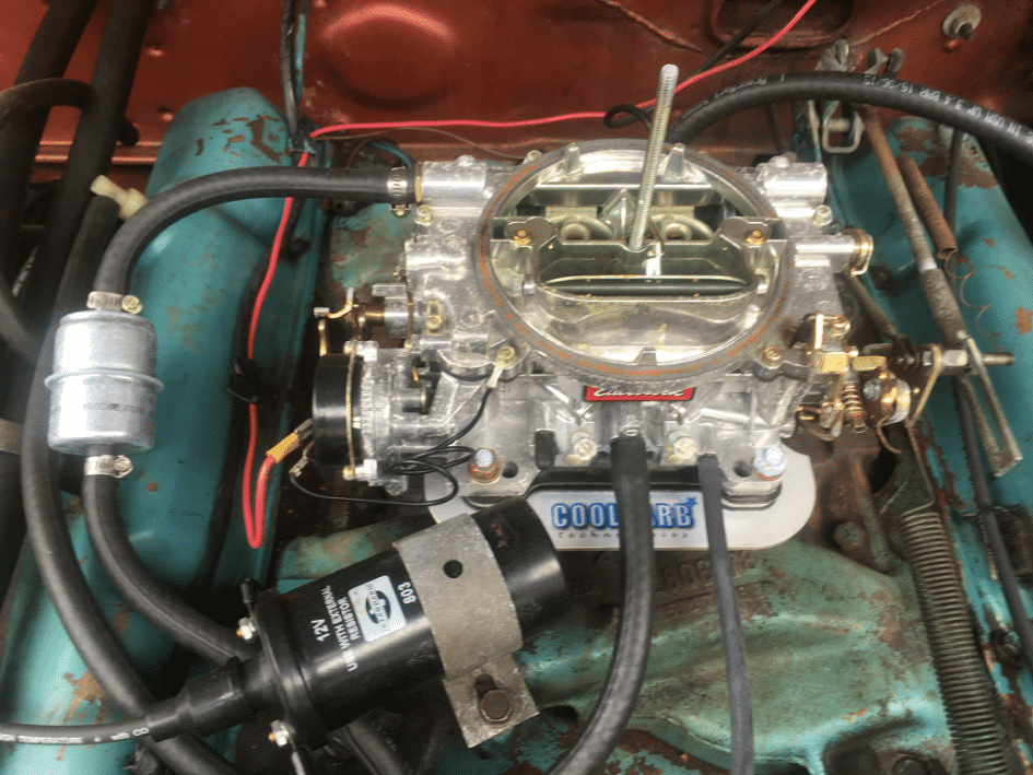

    I don't show the '68 300 at AACA or similar events so while I do try to maintain a level of authenticity I threw my hands up with the Holley carbs. I rebuilt that thing several times and it would run great then start getting stupid. Later I even bought a new 4160 but the same problems came about. WHen the car was relatively new I remember my dad fighting with the dealer about poor performance and turns out that on very first OEM carb there was a warped metering block from Holley. This was an industry-wide issue on those carbs, so we were told. Chrysler replaced the factory carb and then later troubles began. When the re-builder basically refused to rebuild the 4160 not too long ago and explained his take on the Holley, I left with his suggestion of replacing it with the Edlebrock.
    The electric choke, you're right, would NEVER fly at AACA. Blasphemy! When I do the Imperial I will try to hide the wire as best I can. The Imp and 300C are senior grand winners so I can so some tweaking in the interest of driving the cars a bit more than I have been. We also know that our current fuels are not friendly and depsite attempts to rebuild in view of ethanol, the gasoline just doesn't do these yachts justice. :mob:

    Thanks. Where do you pull the power from? Are you having to splice the factory harness?

    The choke is wired into the ballast resistor per the photos attached. All good, no problems at all. Works great, any time, all the time!
