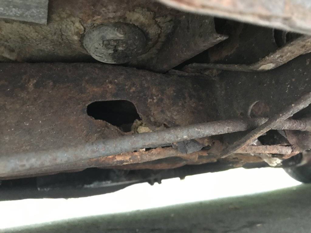

    Found this recently. Very disheartening. Under driver door area.

    A few more pics would be helpful, how large of a area? Depending on how large of a area you may have to find another stub frame.

    Replacement front stub would be best I think.

    It is under driver seat area. I thought stub frame was ahead of firewall? Am I missing something?

    I would replace the stub frame and replace all the suspension parts from PST while you have it apart. You'll never have to worry about it again.

    Yes, it’s a unit that starts at the rear of the torsion bars.

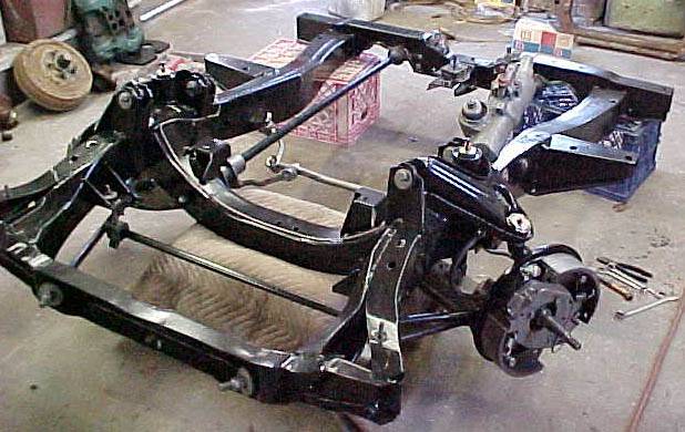

    This is for '69 and up but is a good illustration.
    Here's a shot of one, don't know what year...

    Frames are out there, and for a few hundred you can find a decent one. @Wollfen has a good tutorial on how to replace it without pulling the motor. @71Polara383 might have something.
    Start by reading this thread.
    1969 - 1971 C body Stub Frame (subframe)
    Different year but the concept is the same. I would be surprised if there was that much of a difference between 69 an earlier.

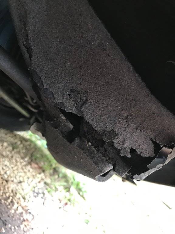

    The rest isn’t too bad except for the front cross member where a brace is bolted in. It is really bad.
    I may weld in new steel. Area is about 6” long.
    68 Sport Fury.
    That one spot is the worst.

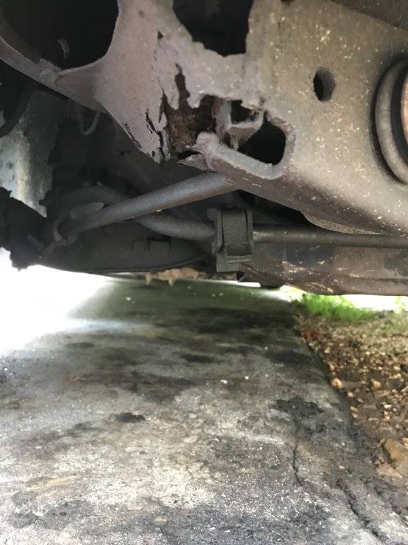

    But here are some pics of a bad place passenger side. A strut bolts in here and attaches below sway bar at other end. Pretty sure this car sat in a field for a while.

    The front cross member is pretty vital to maintain alignment and steering stability. If that is rotted out you need a new stub.

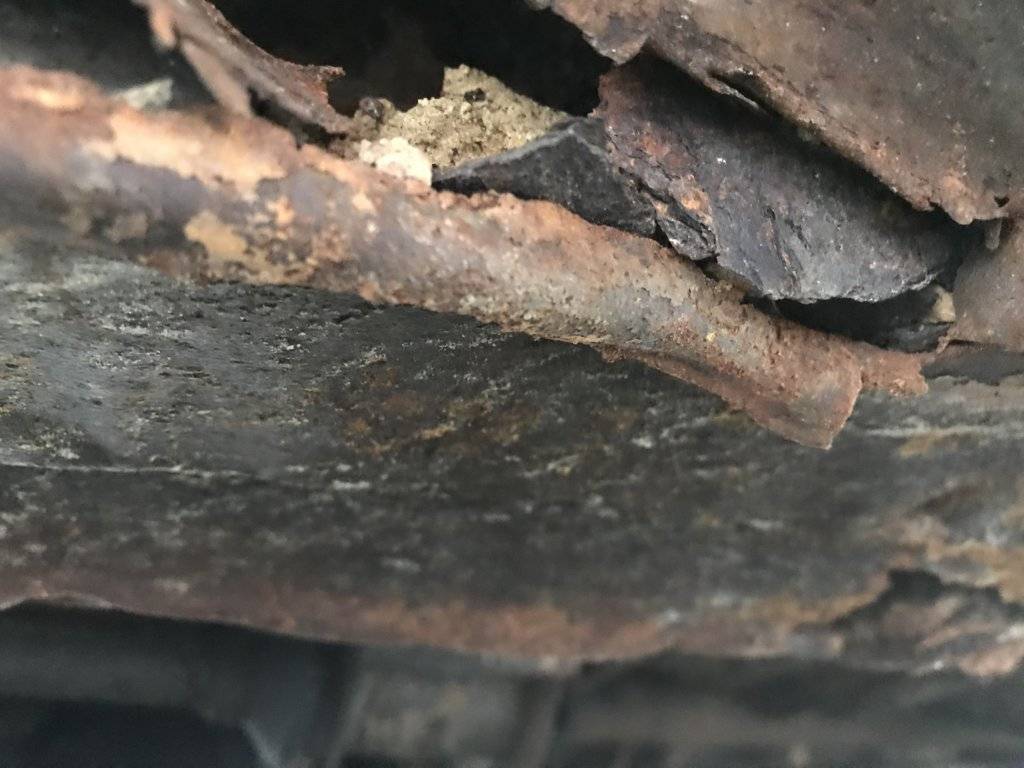

    See photo I just posted. Attaching one more.

    How good are you at fabrication? I would go after the stub frame with a hammer and knock all the loose rusty metal off and see what you really have to work with. See how thin it is and how far it goes.
