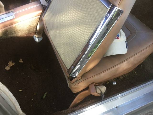

    Here is the pass side of my 65. These are original factory installed. Mine do not have the cover over the tunnel anchor bolt. 66 might have em.

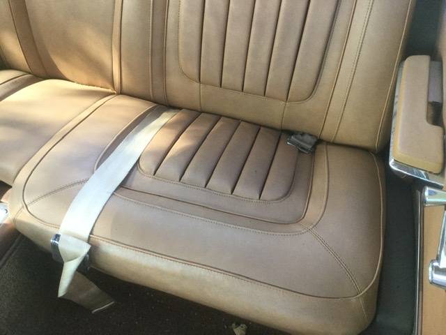

    Here the rears. Found under the seat and quite dirty. Cleaned up nicely soaking in Simple Green.
