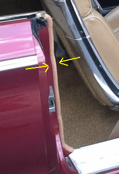

Can someone tell me what this part is called?

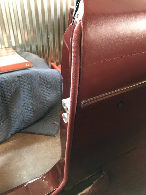

The ones on the 300 are frayed and I'd like to replace them. If you want to suggest a vendor to buy them from I'd take that info too :D

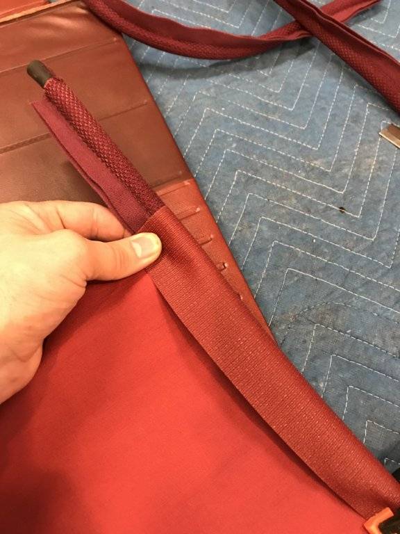

Best place for windlace is Restoration Specialties. You will need windlace with a cardboard leg (the bit you can't see that's held into clips under the edge of the door panel).
RS will send you free samples to match up.
I can’t tell what color it is. iIf it is tan you may find something. If red? I struggled finding the right color. SMS couldn’t even find it. I ended up using a scrap of my new headliner and sewed it around what they sent me. Matches perfectly now.
I recall having to clip my wind lace very tightly then popping the clips into the inner door skin.
It kept falling out otherwise.
Be sure to use some kind of fabric protector as it fades very quickly
