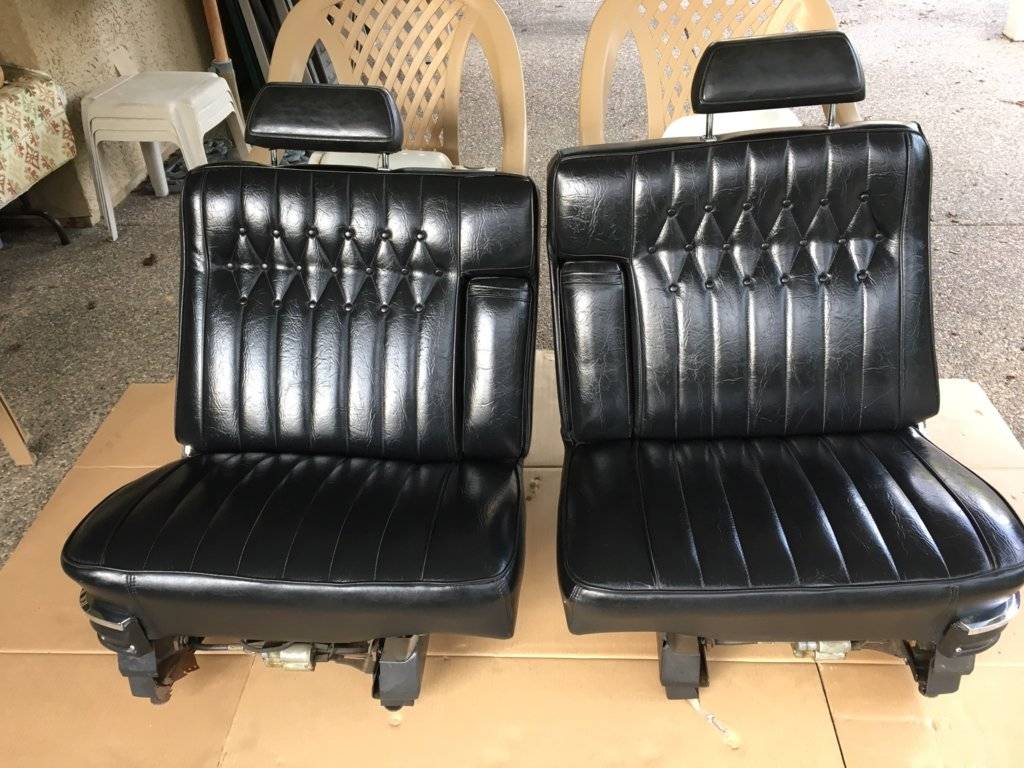

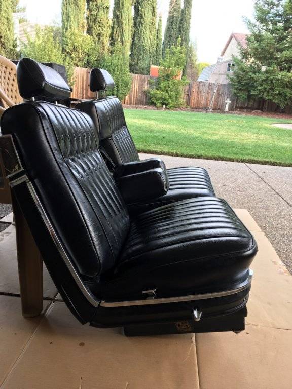

I bought some really really nice seats out of a `67 le baron a while back and am now installing them in my `69. I was really torn over changing the color they are so nice and in pretty much new unused condition. The burlap and button string are brand new. It’s weird to find burlap that’s not dry rotted and the string is snow white. The leather is super soft and the seats look beautiful in natural black but my ride needs to be red white & blue so I made the call and blue they will be. I’ll be following Big John’s advice and using SEM vinyl paint. I’m lucky to have an NPD in the neighborhood so hog ring kits and SEM are but a short trip away. Here goes...

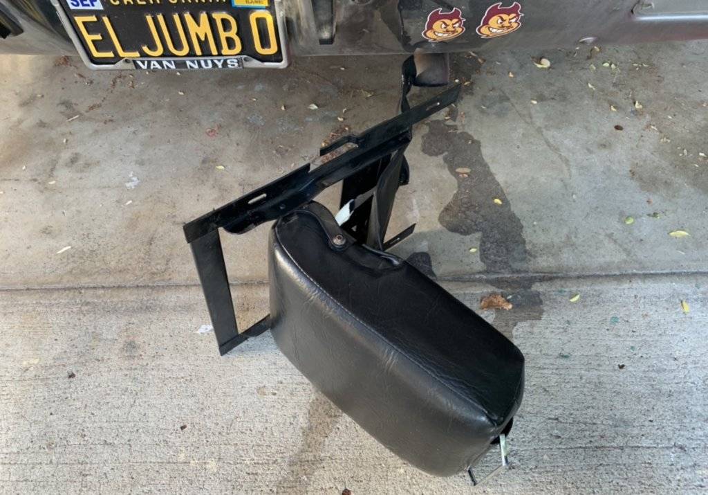

The fronts will pretty much bolt in and they will be exactly one inch wider overall. The height should be spot on and they will touch forming the all important front bench instead of separate buckets. I will drill the extra holes after I yank out the bent battered and broken old bench seat. I’m starting out with the back seat as it is way more labor intensive.

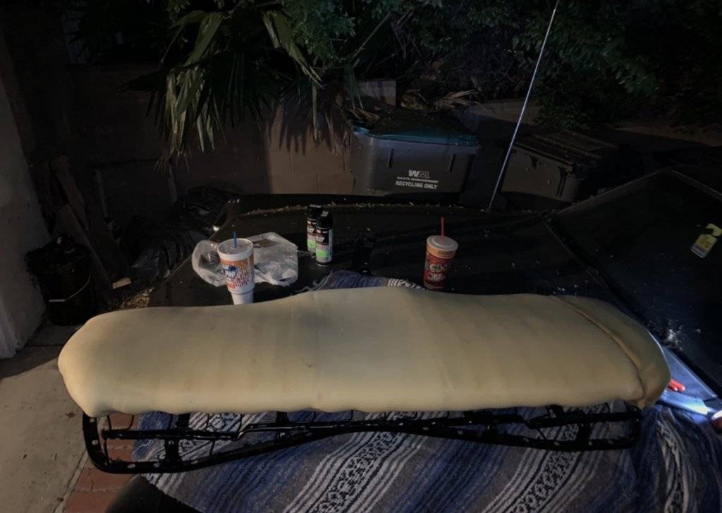

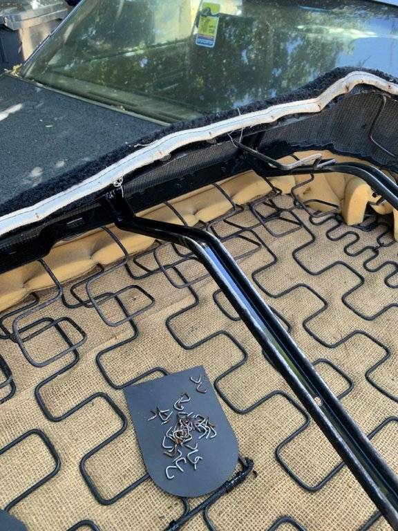

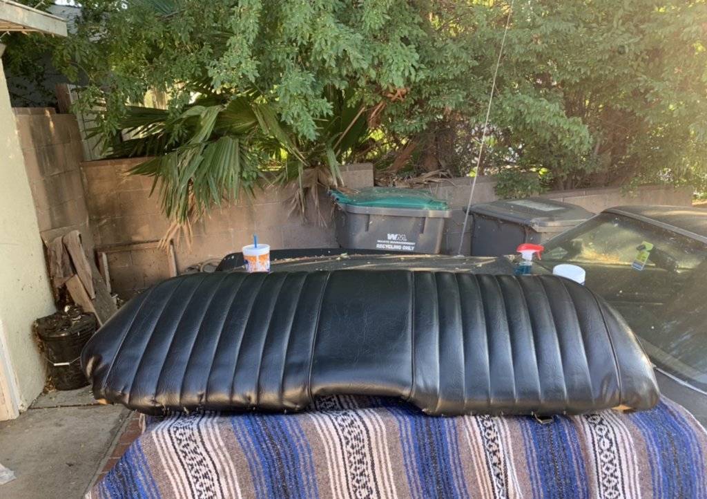

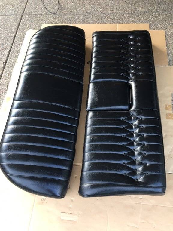

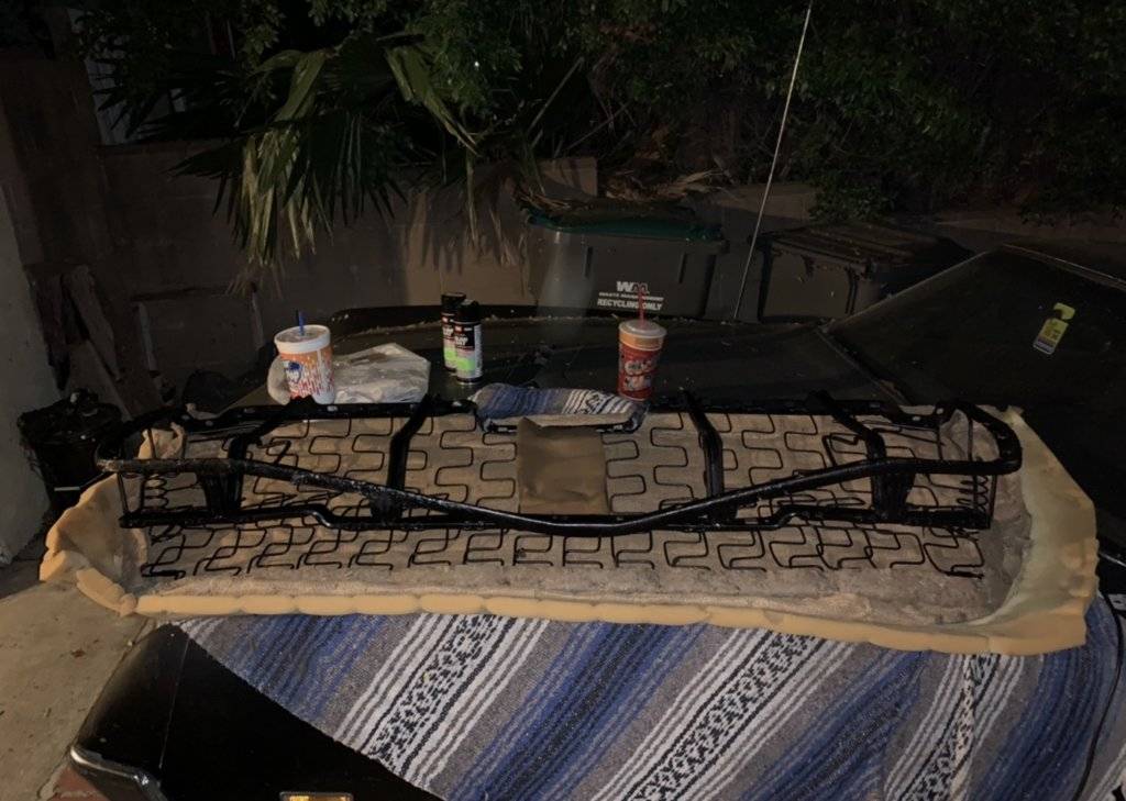

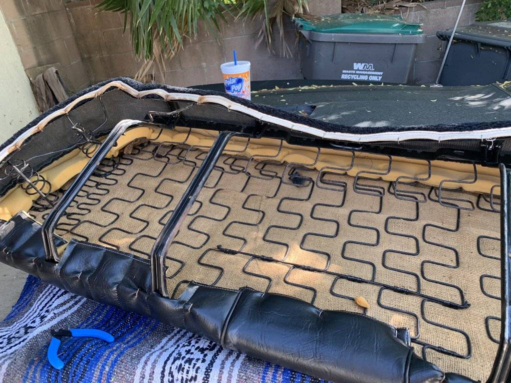

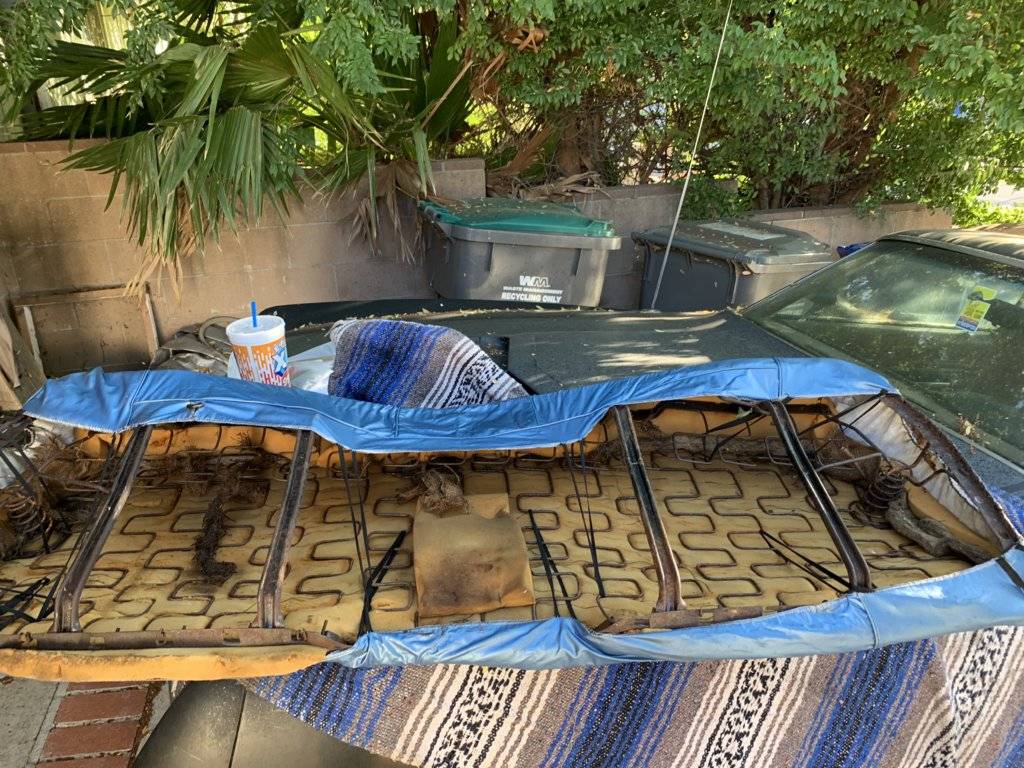

Got the workbench all set up and laid out the imp seat bottom for surgery.

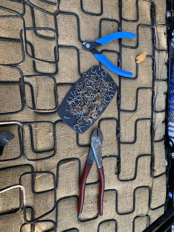

A neat trick is to have a sheet of magnetic paper handy to catch all the snipped hog rings.

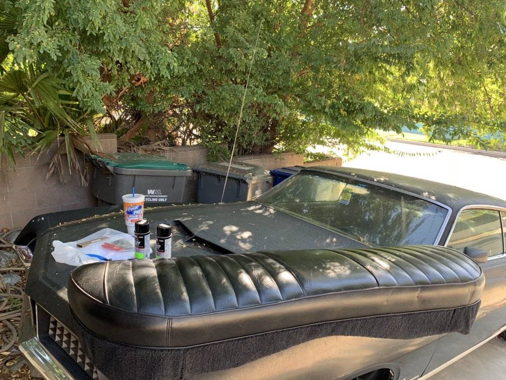

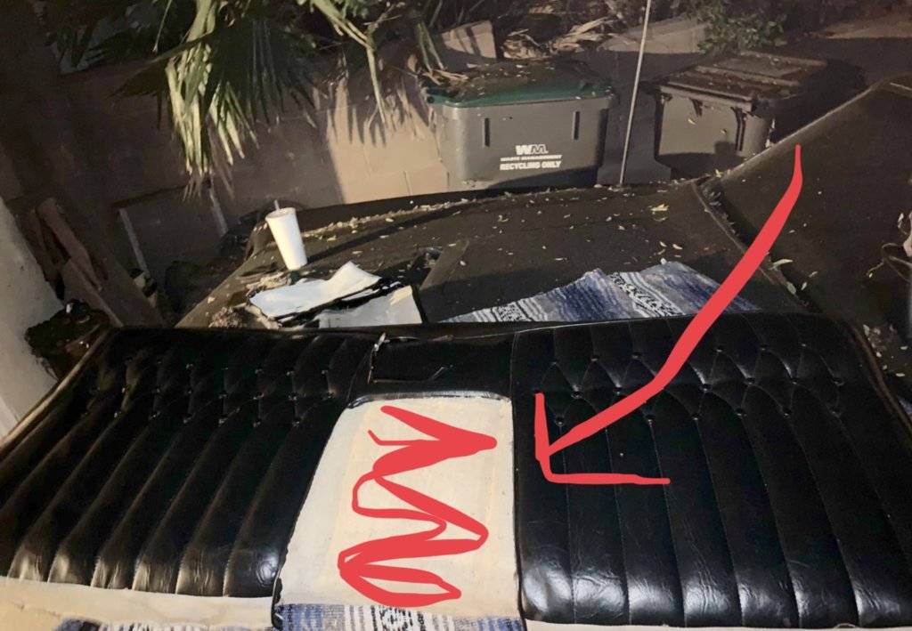

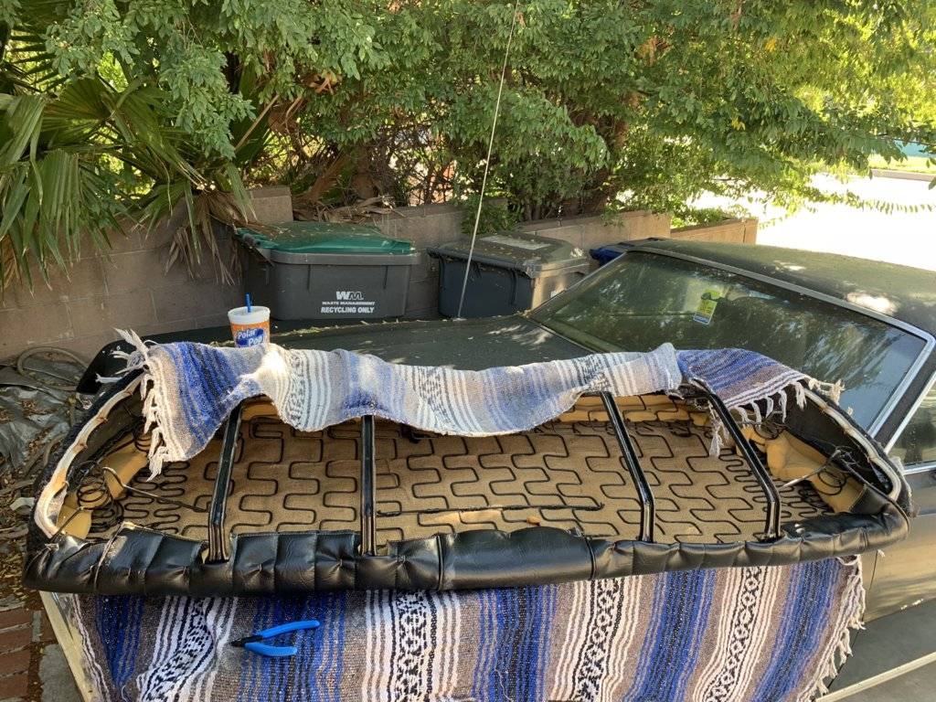

The seat hide was peeled off in perfect condition.
Looks like a piranha attack !

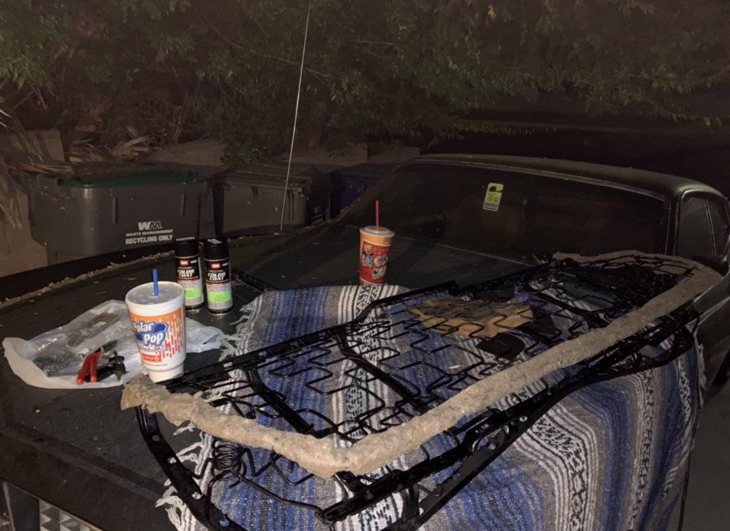

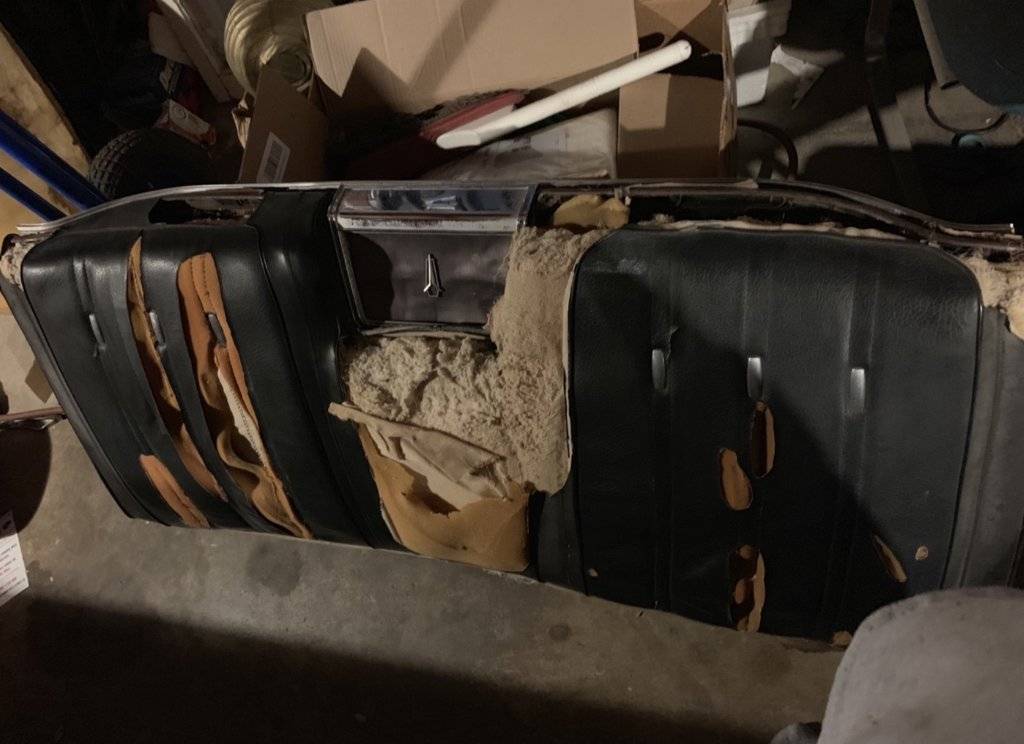

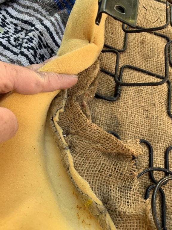

Now have to strip the nasty original back seat bottom.

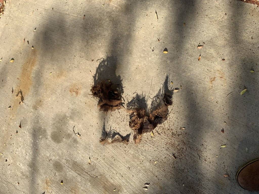

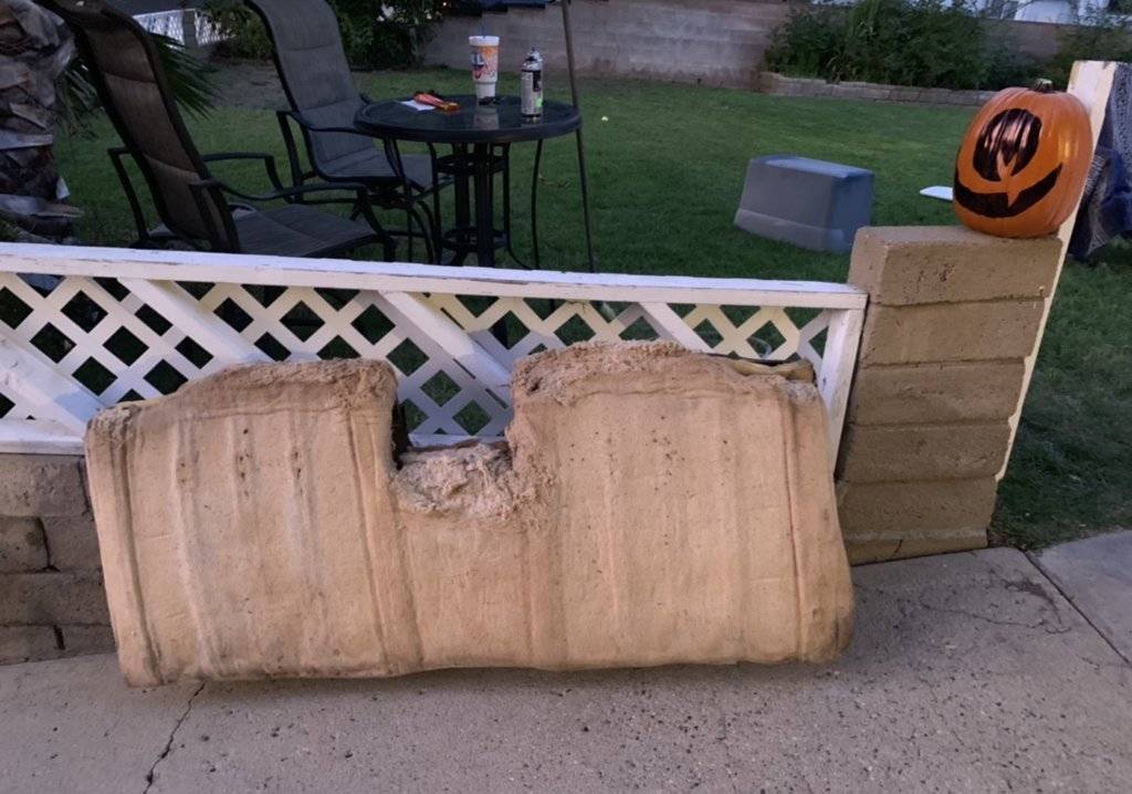

That’s all the surviving burlap. It just plain evaporated.
Remove the cool old school Monkey Wards seat covers. Good thing I saved that 50 year old box !

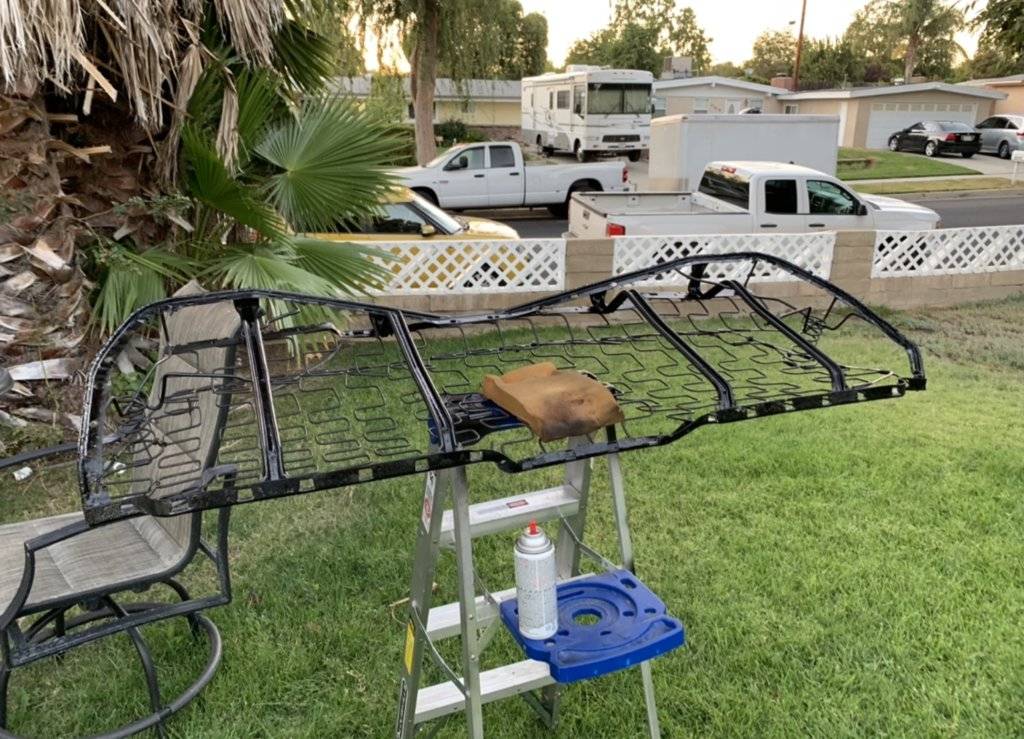

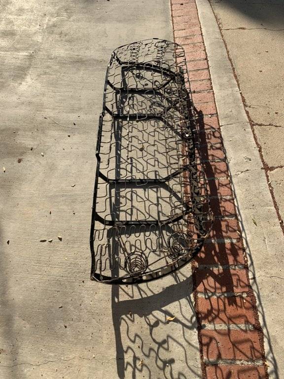

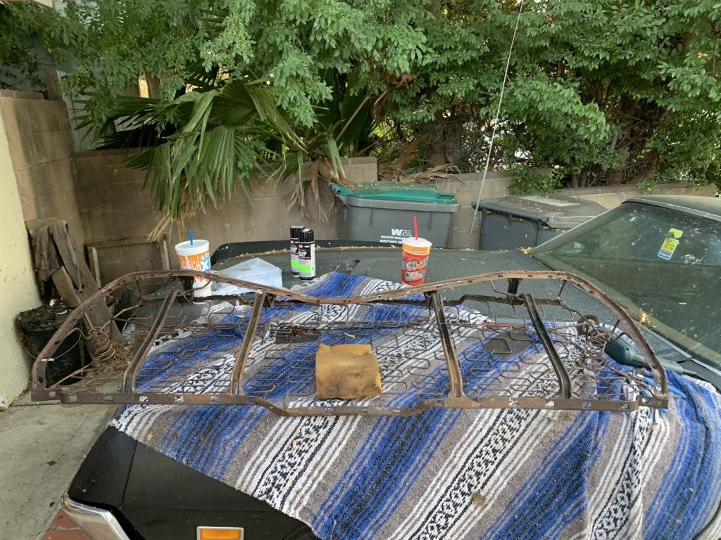

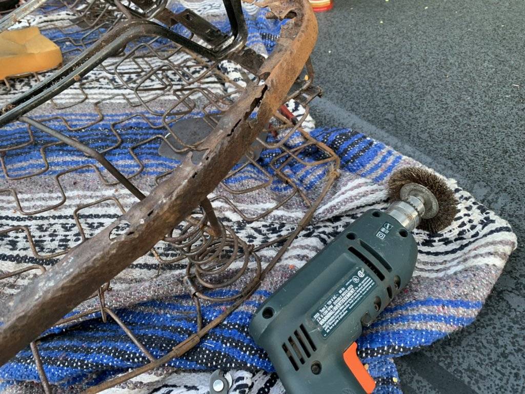

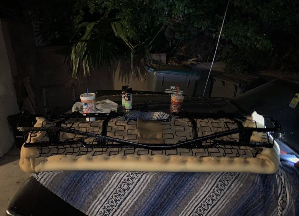

I couldn’t in good conscience build up a new seat with all that untreated rust. So...
I used a little bit of nature in the front yard as inspiration and painted the frame after a quick wire wheel job.
Came out okay not great but it’ll last my lifetime.

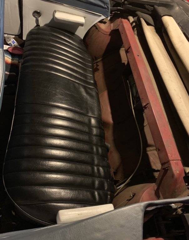

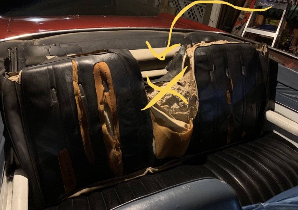

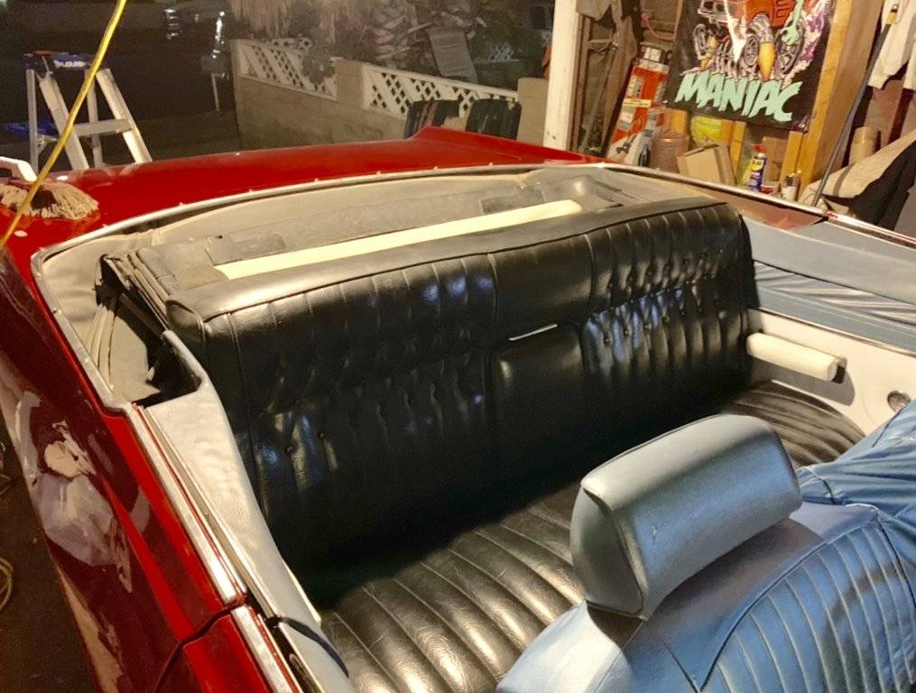

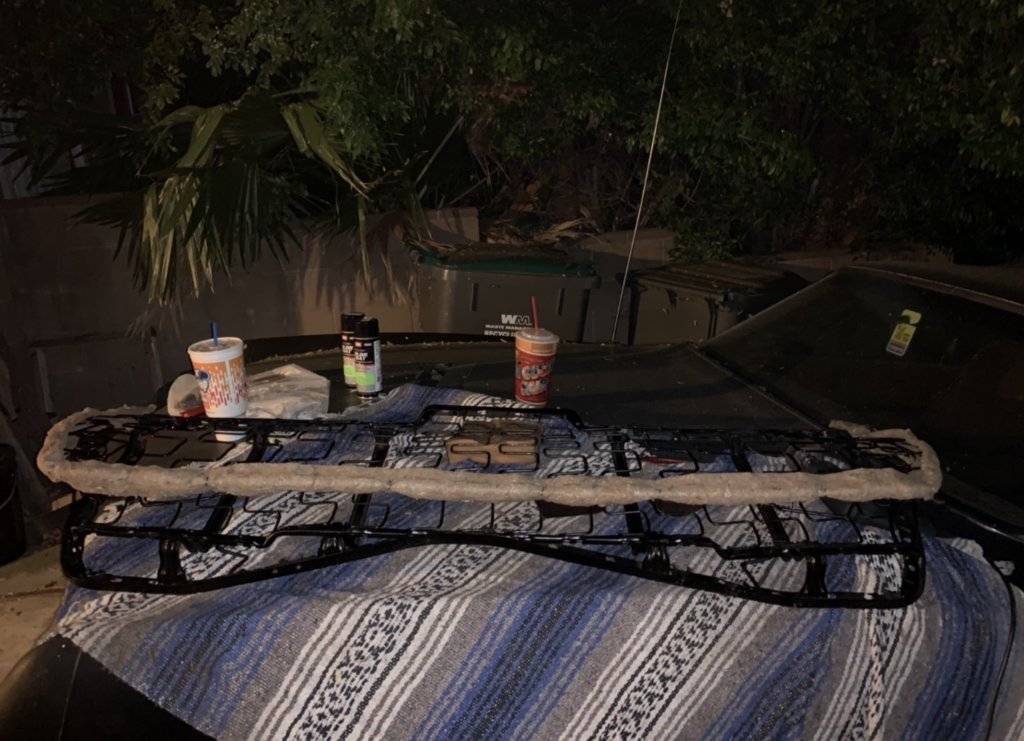

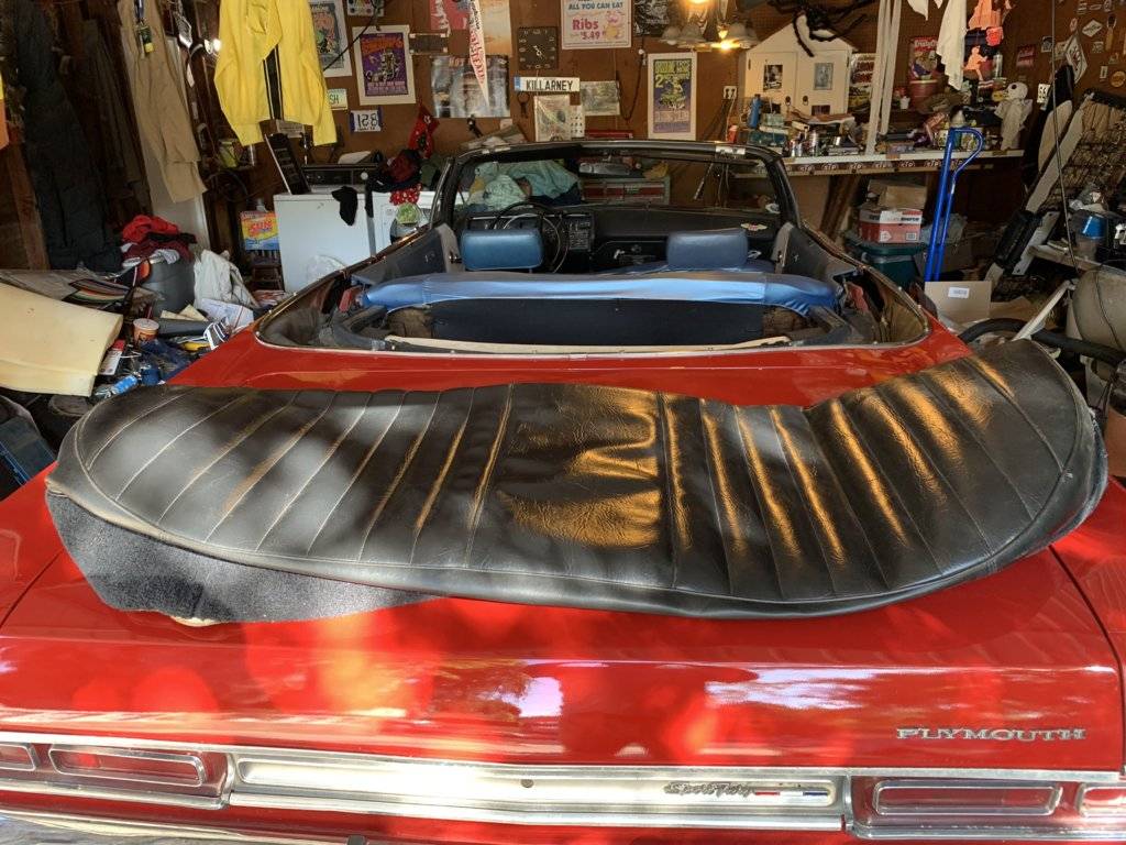

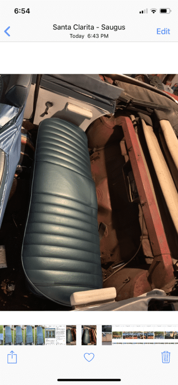

The le baron seat guts went on and fit pretty good. The two back seats are very close in size.
Looks pretty good and fits like a glove.

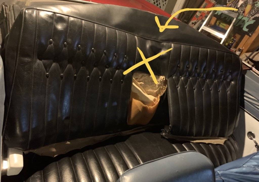

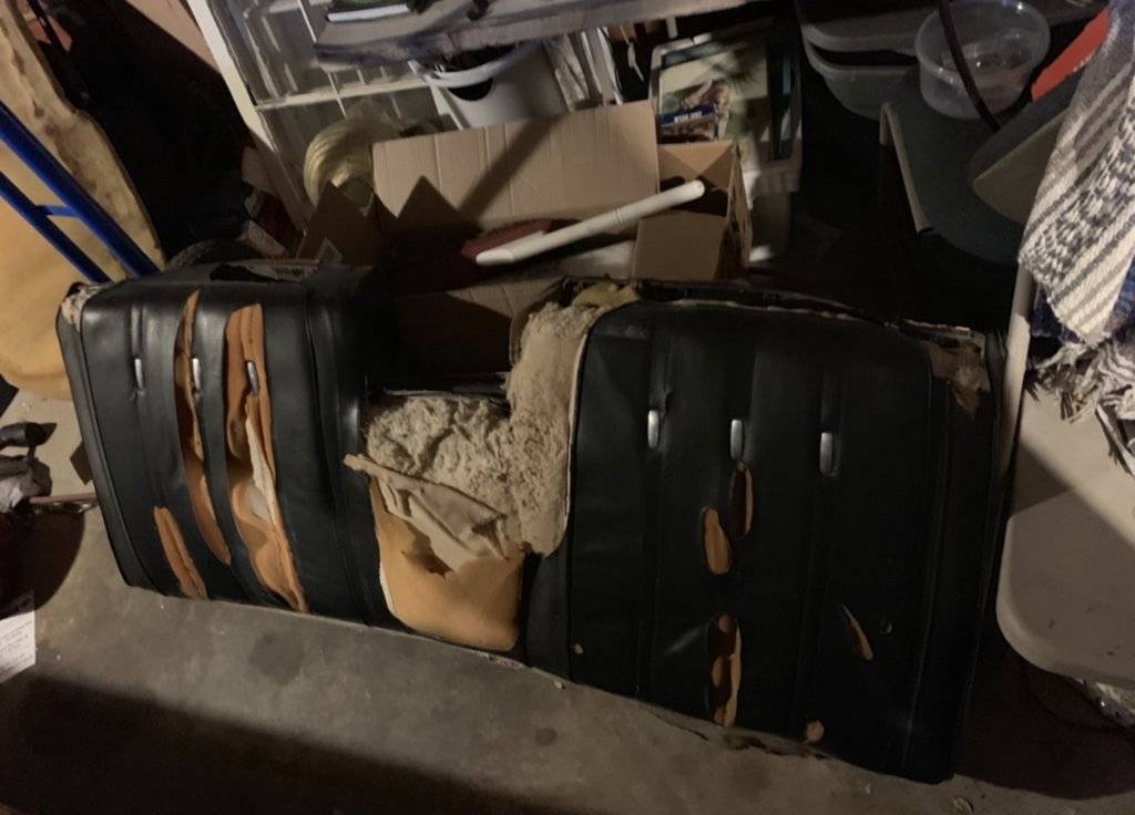

Just for a laugh I threw the seat back in there. It almost fits but it sure looks funny. I’ll strip the seat back tomorrow and modify it to fit the convertible frame. I’m pretty sure that stupid arm rest is gonna give me fits!!!

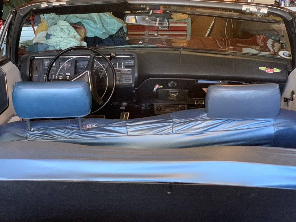

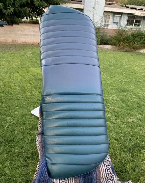

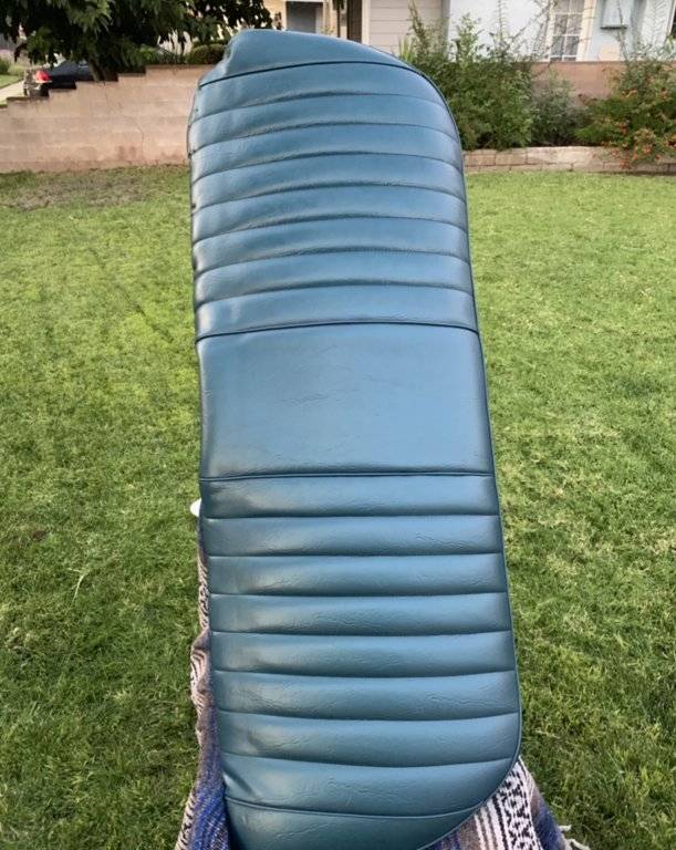

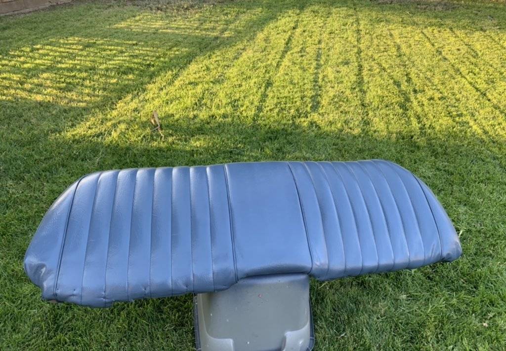

Here is a preview of the final seat color. I didn’t want a super dark blue and I think this will work out nicely. You can see the final shade on the driver headrest compared to the passenger that is just a dull blue primer coat.

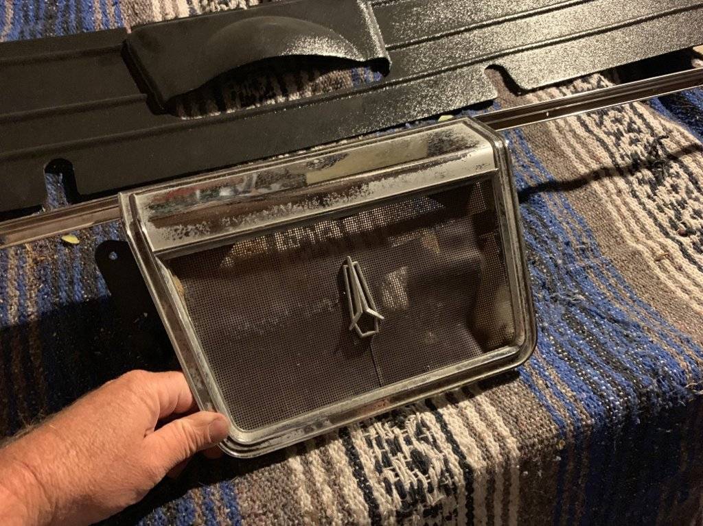

It’ll be nice to finally put this part to good use !!!

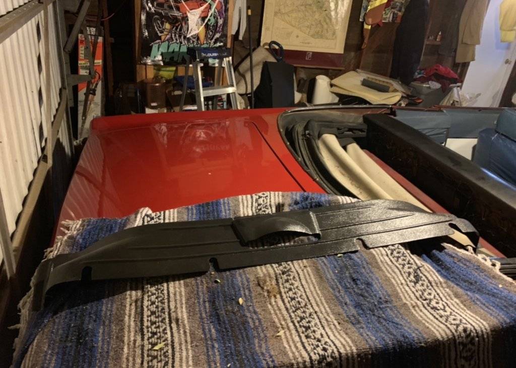

This seat filler panel from ABC has been waiting since last year to get bolted on the car.
I’m going to have to use some elbow grease on this poor thing.
It’s in pretty sad shape.
It looks okay on this mess but it’ll stand out like a sore thumb on a nice seat.

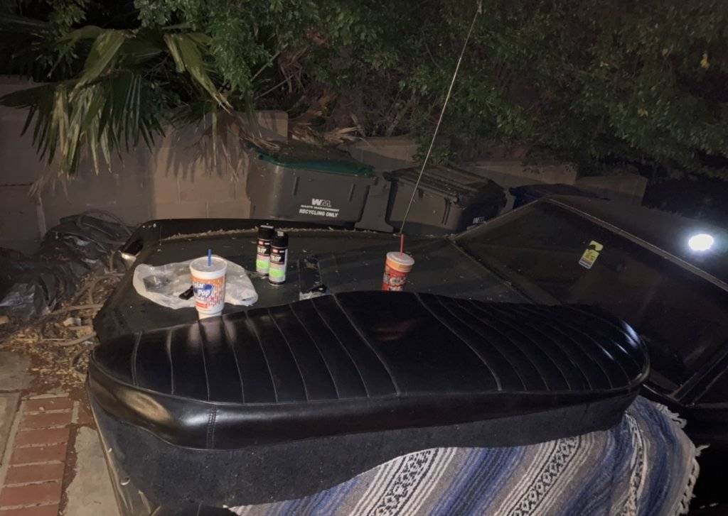

Seat bottom color change.
Abby did everything she could to stop any progress!

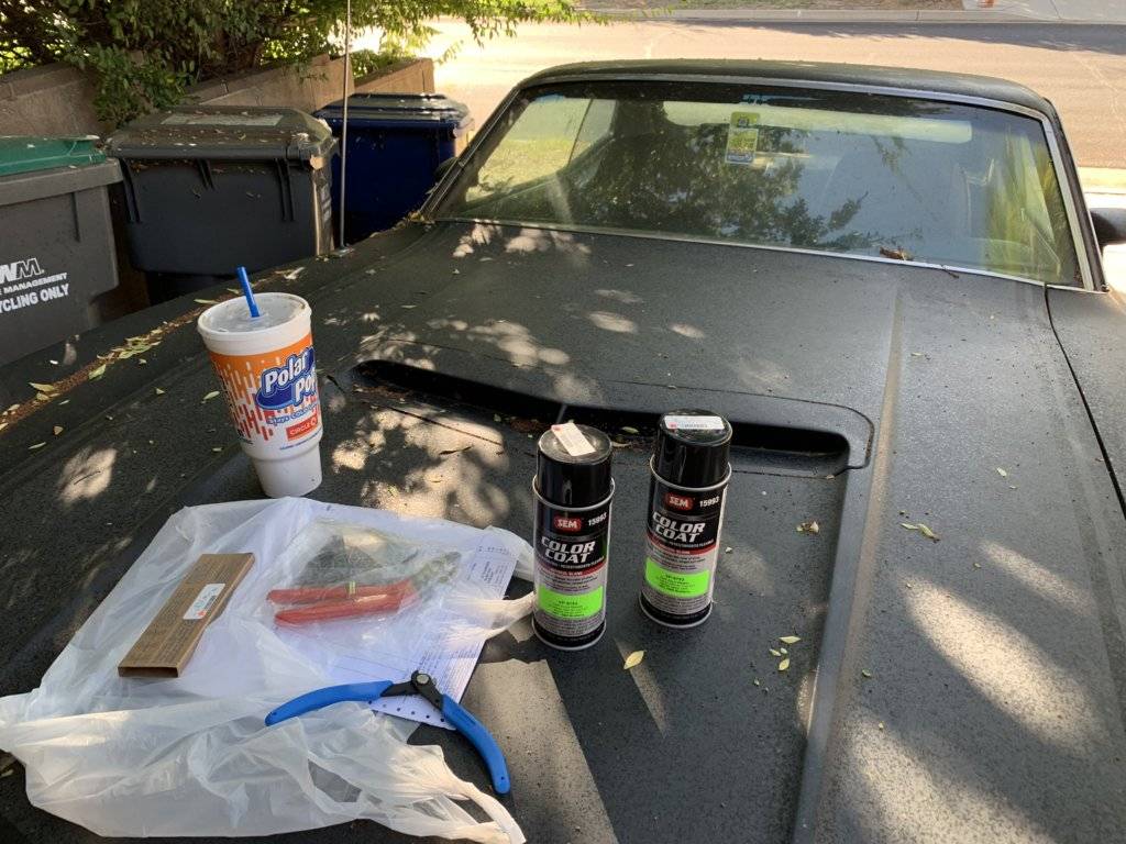

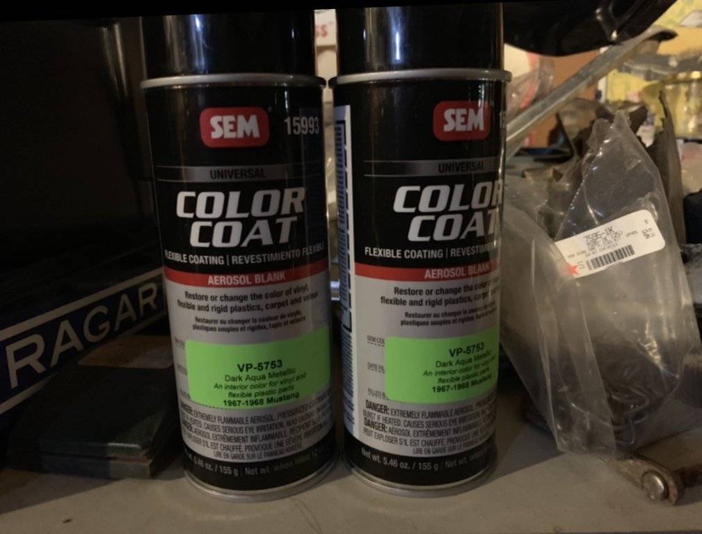

Big difference between the cheep pep boys blue and the SEM blue. At a difference of $10 per can I’ll primer coat w the cheep stuff.
Lookin good safe & sound.

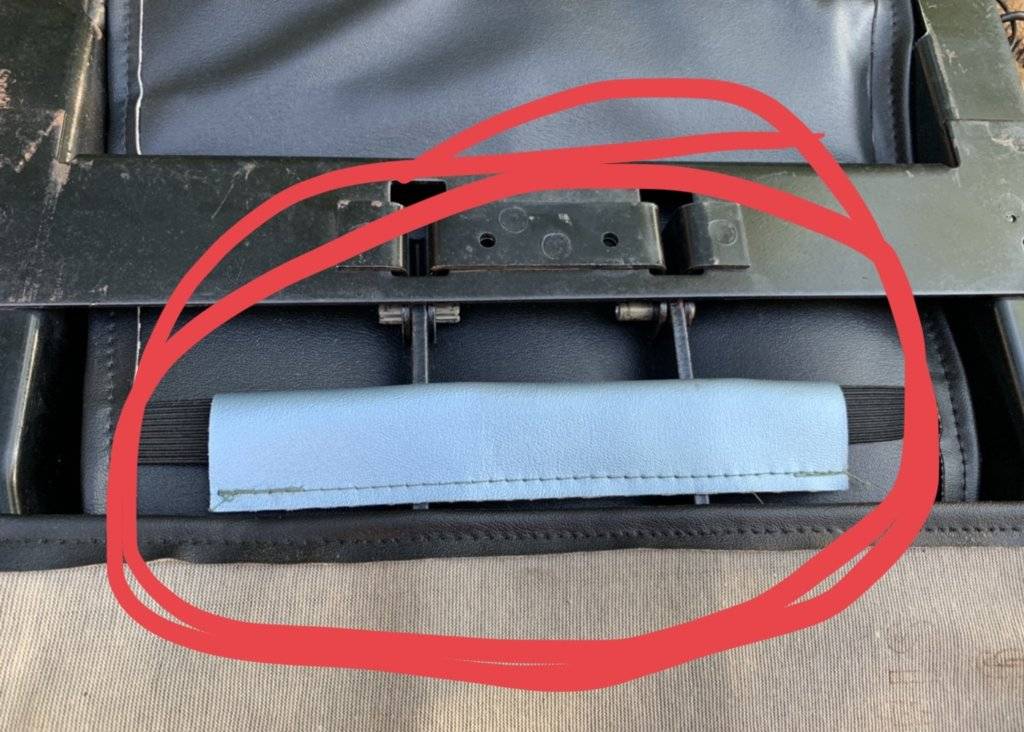

I removed extra the arm rest material and will have to replace this section w new material.
You can see the obvious issues w just slapping this on. I’m going to have to install a channel for the back seat speaker housing. Not the end of the world.
