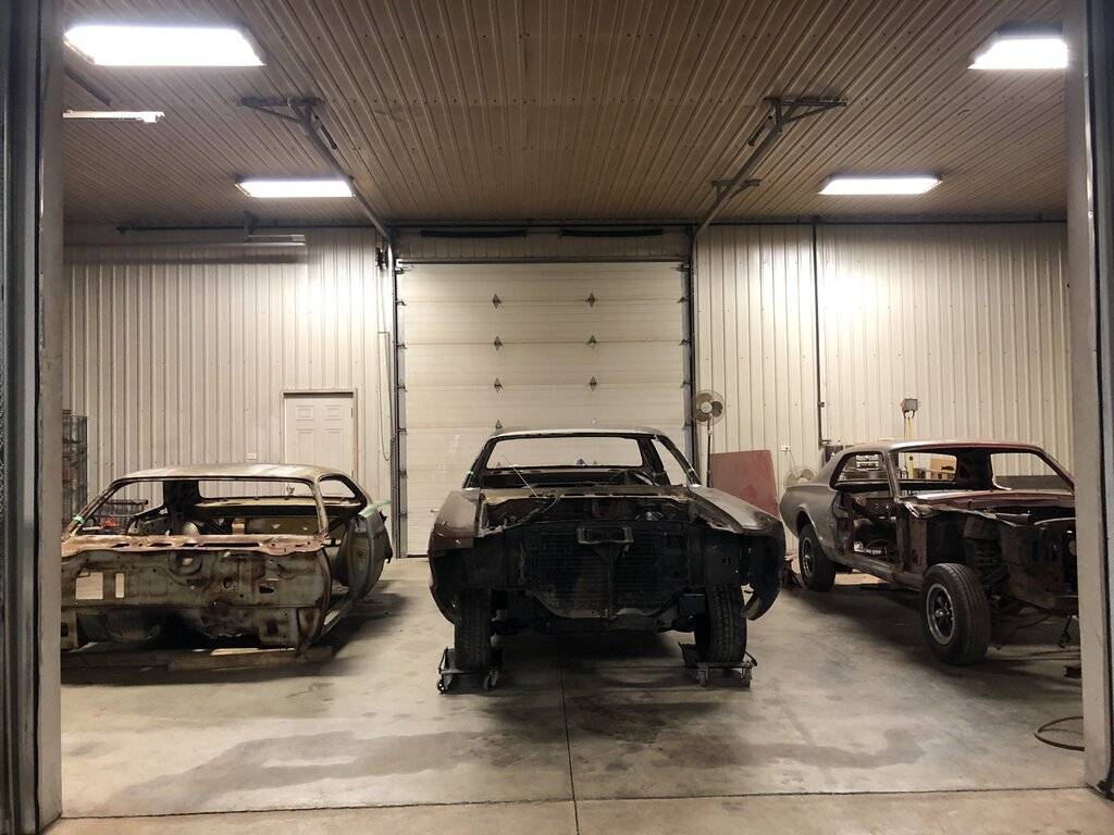

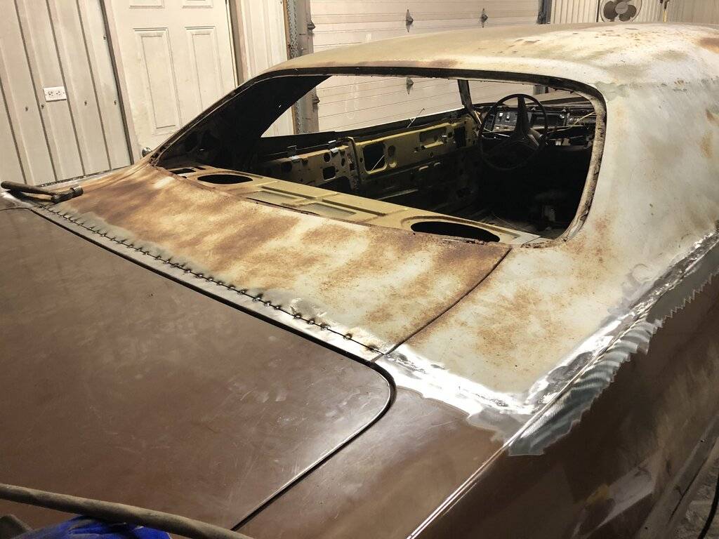

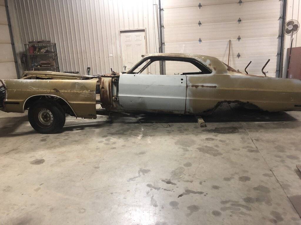

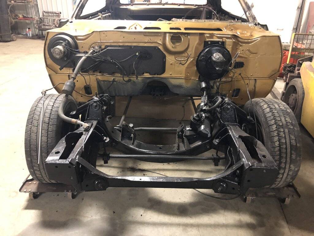

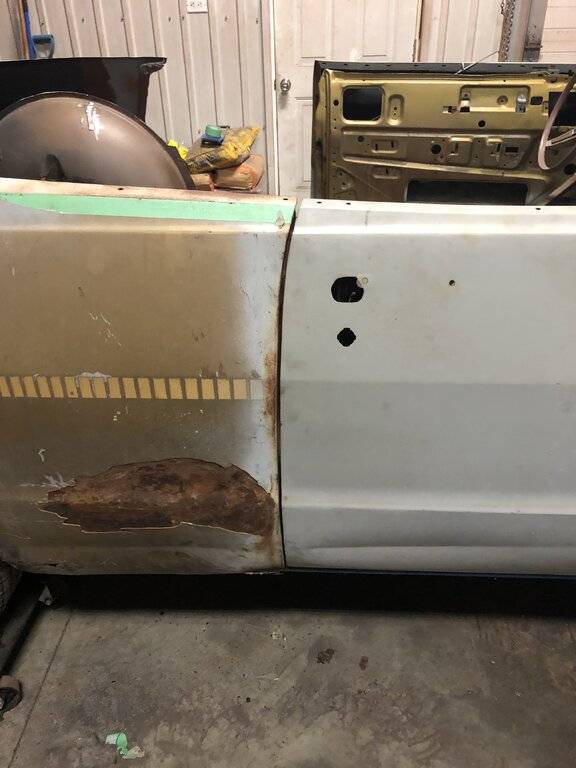

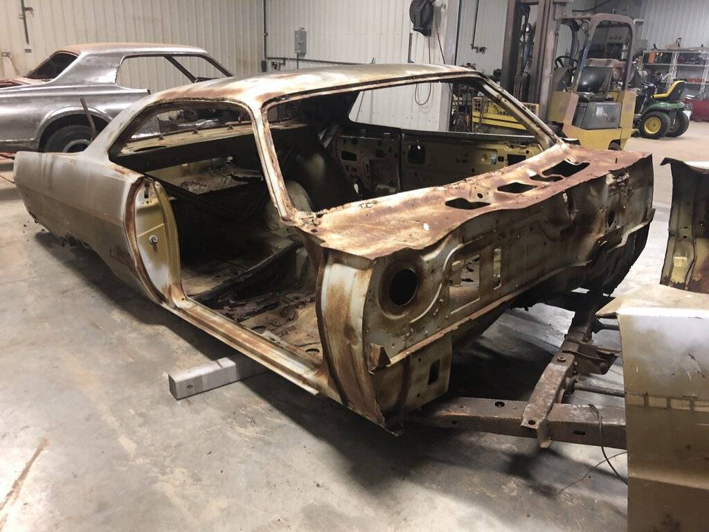

    I don’t get to post on here very often but recently I picked up a car I’ve been after for some time and I spent the last 4 weeks working on it. This is a 1971 Plymouth sport fury GT Canadian car, gold with green interior. Although it may never be original again it will for sure be on the road again soon with help from a 4 door donor vehicle.
    I saved as much as possible from the GT tub, doors, roof, entire interior, all the interior panels and supports... cut the roof and all 4 door components from the donor car and transferred all parts from the GT. The majority or steel work is done aside from a few patches here and there but overall I’m pleased with the progress made on the car. Ok decided to respray the car gold and the only thing I will be changing appearance wise will be the strobe stripes from gold to black.

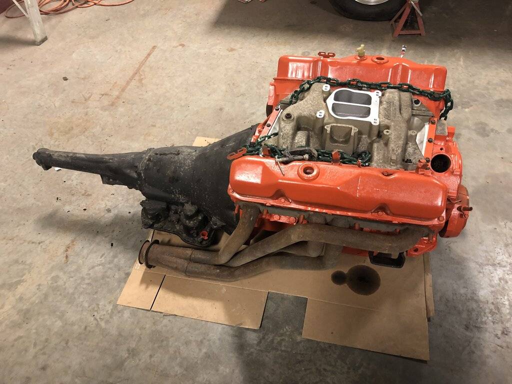

    Disregard the picture of the bench; that was not meant to be there’

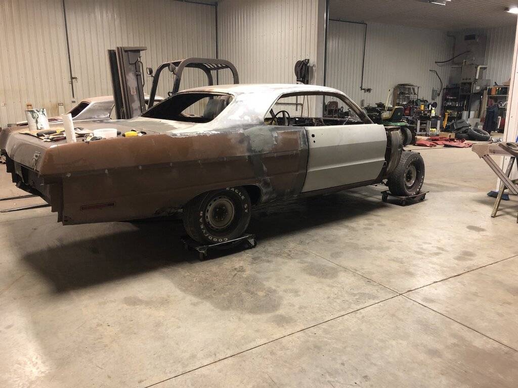

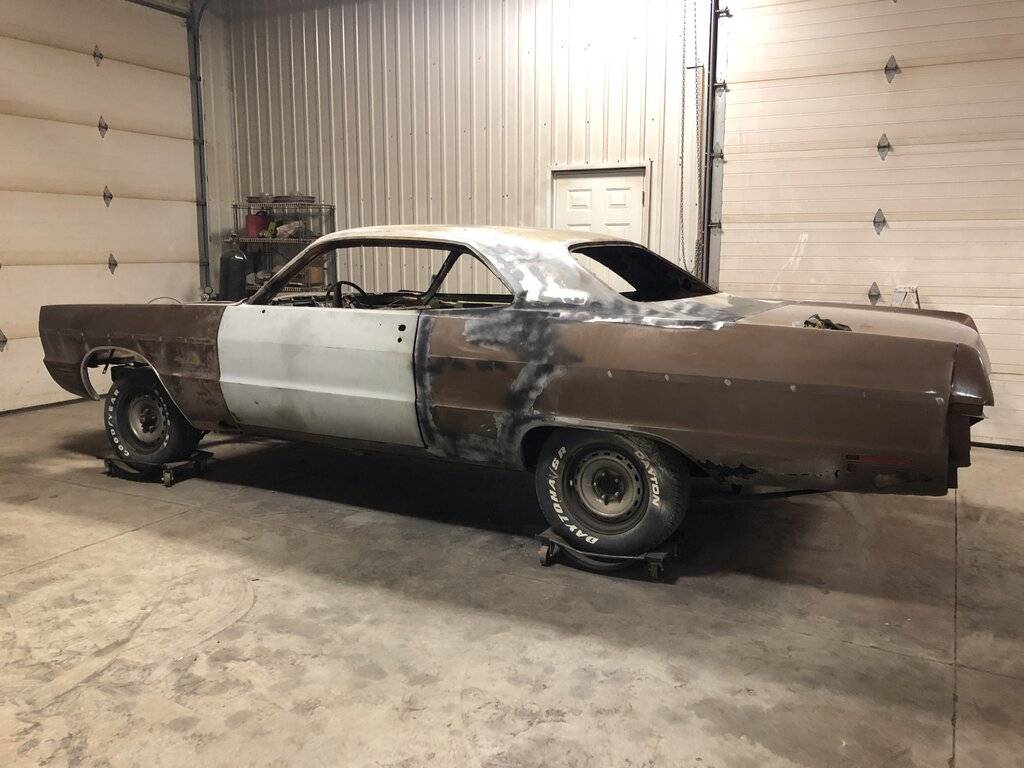

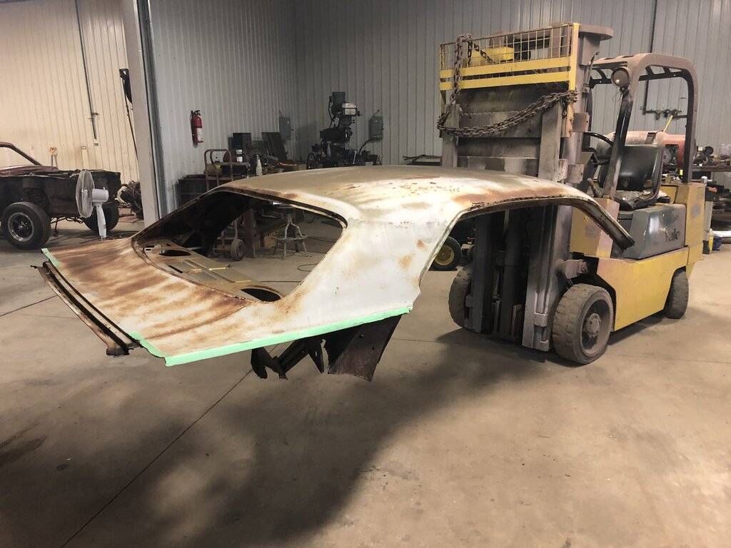

    More pictures of the overall; starting to look like a real car again.

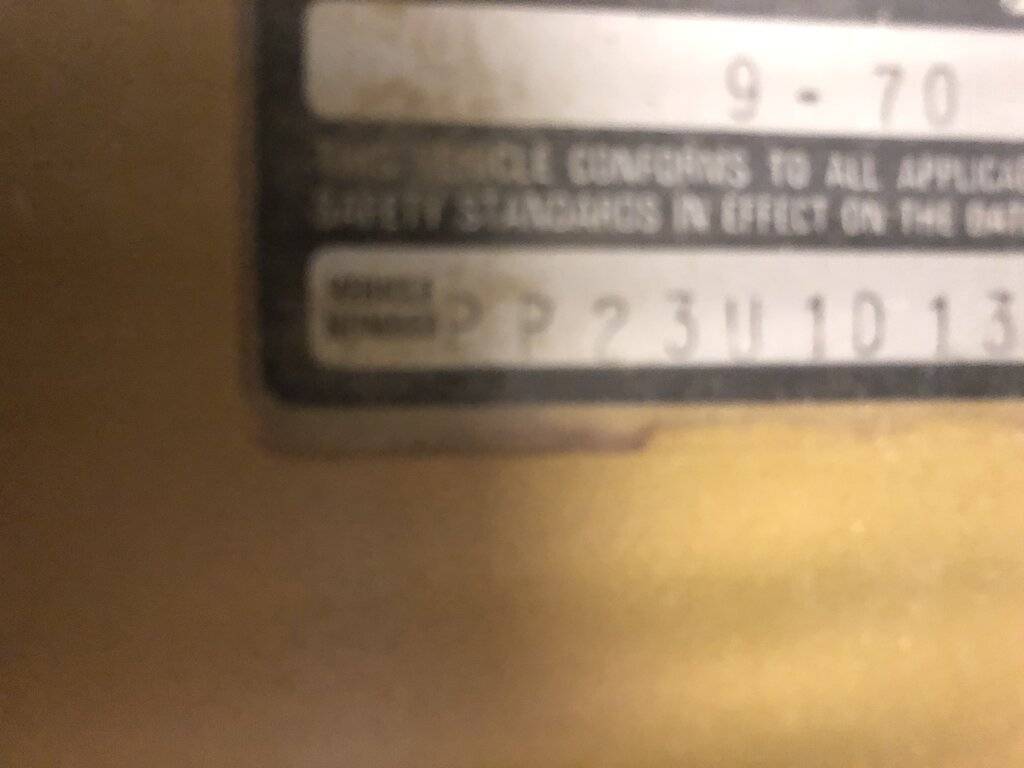

    If I really wanted to be anal about things I could cut them out of the fenders and firewall sections that aren’t completely buried in rust but the car was in a field for 30+ years and half parted out. This is my way of saving what’s left of it.
    It was originally from Toronto and sat in an underground parking lot before being bought, drivetrain was pulled back in the 90’s for Someone’s b body and they just cut the frame and brackets with a torch and left the rest to rot in a field. Other parts were torched off of it as well. It does still have a lot of the numbers; I kept the inner fenders, rad cradle, fender tags, part of the firewall and I have a copy of the broadcast sheet also. So it’s not a total loss.

    The vin is stamped in a couple spots. On the cowl and the trunk gutter, thats all gone now. But the car is saved and returning to the road. Thats what really matters.

    This is more of a grey area as there was nothing left of the subframe or floor pans to weld to. As stated it would have never been original again even if I were to attempt to work with what is there (the frame actually split when loading it)
    Let’s take all of these charger R/T’s for example that were rotted out beyond repair, have had every panel replaced and yet they are still considered a charger R/T.
    I used about half of both cars, what remains of the 4 door is the pans, subframe, parts of the firewall and the rockers. The car is being restored in a likeness of what it was coming from the factory using a good majority of what it had from the factory. It’s a far cry to call it just a 4 door swap.

    The only vin I can use; the GT vin that is on the fender tag, rad cradle, and drivers door sticker. The 4 door was someone else’s parts car as well. I got both vehicles second hand and the 4 door had no ownership as it was imported as a parts car from the states.
