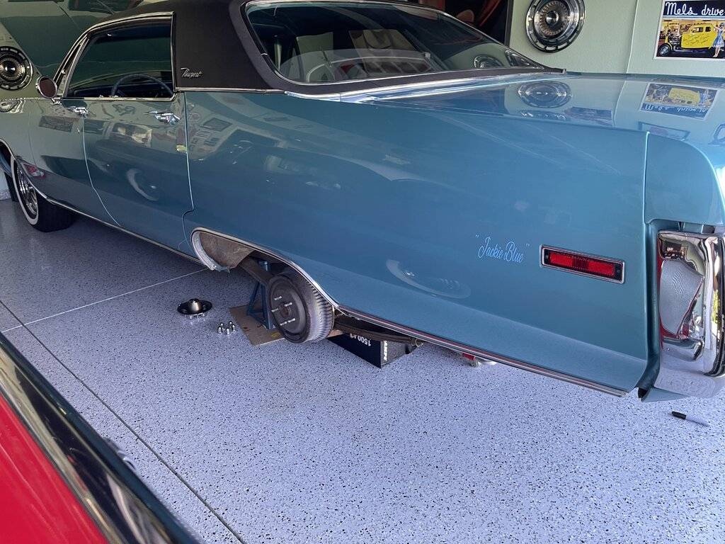

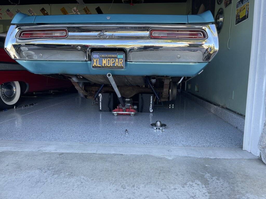

The way I like to do this is loosen your rear lug nuts first while the car is on the ground, then jack up the rear under the rear axle pumpkin high enough to put 2 jack stands underneath each side of the frame rails just in front of the rear wheels. Then once the jack stands are in place lower the rear end until the car rests on the jack stands, then slowly release/lower the jack to allow the rear axle to drop as much as you can to make more space in the wheel well. Then remove your wheels. Works every time :thumbsup:
BAD69FURY
Feb 21, 2017
324
495
ORANGE COUNTY CA
Forgot to mention, keep the jack under the pumpkin the whole time while doing this, you may need to raise or lower the axle up or down to remove the wheel.

By chance does the driver's side have less clearance? My '66 300 is the same way. I thought I was losing my mind when I installed my 235's.[/QUOU
yeah I noticed that too, my driver side had less clearance, had to lower the axle as much as I could and angle the tire to wedge it out .
