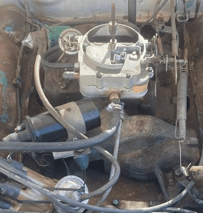

Greetings Esteemed Moparians!
While perusing the engine compartment pic for the Next Newport, I noticed the distributor control valve in back of the Carter B & B carb that indicates a CAP setup.
The current owner complained of the carburetor malfunctioning, but I now suspect maladjustment as much as possible inherent malfunction. The Burning Question arises as this thread is titled: CAP: Keep or Delete? THIS one, as a '68 WILL be subject to emissions testing, so IFF this setup can be made serviceable, QUICKLY and easily, then I'm all for keeping it. But I priced this valve, or the only one I could find, and I don't care for THAT at all!
I have PLENTY of new goodies I COULD install to this motor instead. Would THIS be the Best Option, with the Fart Sniffers after this engines excretia...?
I doubt that CAP valve would help significantly in lowering emissions on a smog check test. The smog check standards are probably set pretty high for older vehicles so they are not obviously running around with misfiring or non-firing cylinders primarily. The CAP valve was used primarily to help lower HC emissions during decelerations on new vehicles that had to meet comparatively more strict emission standards than on today's smog checks. If your car runs smoothly (and not too rich of a fuel/air mixture) and the engine is in good shape, you would probably pass relatively easily without the CAP valve.
Even with a sniffer, back in about 1968 or so, the Stromberg on our '66 Newport could be adjusted to the 14.2 idle AFR spec, so getting there should be a real issue, if needed. The key component was the slightly-retarded ign base timing. According to most of what I've read, the only dist advance curve alterations were in the sub-2000rpm range, with the total advance still being about what it used to be as there were no WOT emissions specs.
Make sure the engine runs cleanly and is not using oil and I suspect you might well be good.

I had the system on a '66 car (first year of CAP in California), so the below is assuming it is relatively unchanged for '68.
CAP system is both ignition system and a different carburetor (leaner idle and transition area I believe). There is a Tech bulletin and master-tech video about it.
Since it does not look like you have the original carb (?), you do not have a complete CAP system anyway.
The valve makes sure the distributor gets full manifold vacuum during engine braking. So no real use for it unless your car is tested during engine braking. As far as I have read, the valve was omitted on automatic transmission cars (and continued on manuals) after a few years, as they do not engine brake a lot and therefore were within emission specs without the valve.
I started out with the original CAP distributor. For a '66 is was supposed to have an initial timing of 5° ADC. This made the car start very poorly and a have a sad idle. If I set the initial timing to 12.5° BTC (as the cars without CAP per FSM), the car started and idled great, but it pinged at cruise. I think because the CAP distributor advances a lot. As CBODY67 wrote total advance is about the same, so from coming from 5° ATC it advances 17.5° more than a standard distributor.
Eventually I changed to the electronic conversion kit from Rick Ehrenberg.
The CAP distributors have a non-adjustable vacuum canister with a round "protrusion" in stead of a HEX. I can't make up from the picture if yours is HEX or round.
Maybe you do not even have the CAP distributor? You can check the part number and if it still has a green tag. Mine had green clips to hold the rotor cap.
And of course you can use your timing light to check how and how much it advances.

Thanks for your input. When I get the car tomorrow, I'll begin my tests and repairs/upgrades ASAP then. I reckon I'll remove the CAP valve, probably install that lovely rebuilt distributor I got from the Estimable Halifaxhops months ago, a new coil and my Stromberg carb, check the plugs and fresh them up if needed, THEN take it through Emissions and PRAY!

The fart sniffer will only detect hydrocarbons, carbon monoxide etc. It does not test the installed equipment, so you can safely get rid of the distributor delay and it will not make any difference on the sniff test. A lot of them plugged up with use and disabled the vacuum advance to where the vehicle got poor mileage and ran like crap. So much for clean air engineering.

Thanks Dave! I thought that would be so. I think the CAP just relied on that fact of greater vacuum advance variation, which, as you wrote, didn't work too well at all after a bit of wear. OK, OUT with the CAP, and IN with the '66 383 fuel system and ignition goods! I have THAT set up sweet and sure.

Right on! I reckon I'll make this a regular setup instead of diddling w the CAP stuff, especially if its giving trouble as I was told it does when starting. I MIGHT just yank that distributor control valve and dial the timing to -12.5 degrees right off, then put it through the paces. Compression check will likely be this Saturday, as I'm apt to be busy Friday.
Stay Tuned!
If you remove the distributor control valve, the lower rpm centrifugal advance curve is a bit slower than normal, but it pretty much back to normal past 2000rpm. SO, you'll need a normal (non-CAP spec) distributor BEFORE you alter the base timing. The CAP distributor and the control valve and the timing setting are something of a matched set. Check out the tune-up and distributor specs in the FSM for CAP and Federal-spec engines, for good measure.
