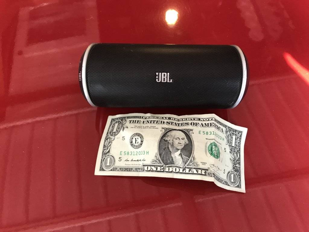

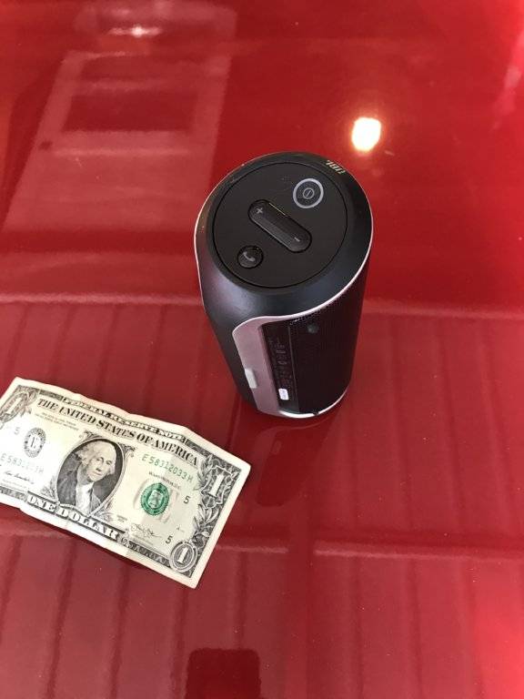

  20. The Goose
    The Goose Well-Known Member
    My Photo Garage
    Messages:
    898
    Likes Received:
    1,145
    Joined:
    Nov 21, 2016
    Location:
    Santa Clarita ca
    That just might be the ticket. I got one of them when I had to upgrade my work phone. My daughter immediately stole it. She used it one time we drove the convertible and wanted to listen to music off her phone. Not sure exactly how that all works but this thing is louder and clearer than any of the pep boys radios I've ever installed. Works perfectly no wires & it's chrystal clear and way louder than you'd actually ever need. Just turned it on and threw it in the backseat. Worth a look...
