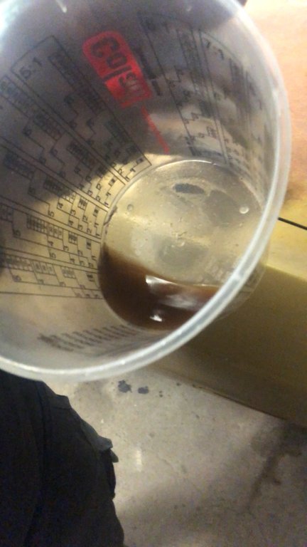

What I did when I was back home yesterday night : new Fuel pump I had on the shelf , new pushrod (old one was still at 100% but put in a new hardened one from Hughes anyways . I also changed the fuel filter and you know what came out ?
This dirty coffee like stuff came out the fuel filter . So I changed the filter .
