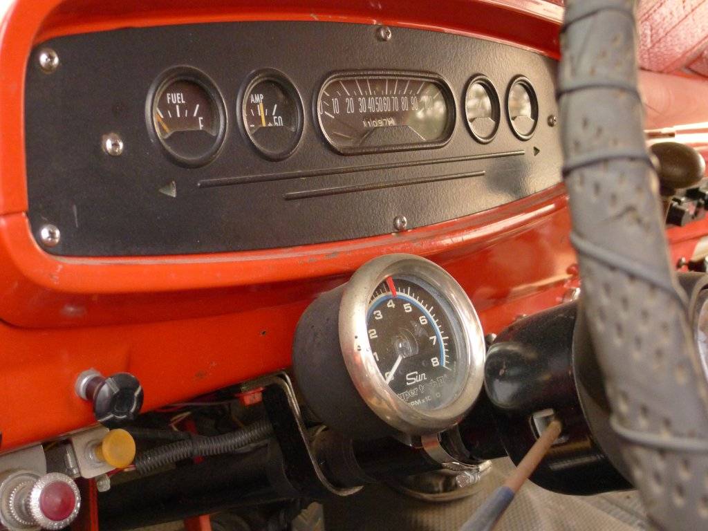

My preferred weapon of choice for vintage tachometers on a budget, the old Sun tachs that used to be everywhere. They usually work quite well, forever apparently, fairy simple to mount on old Mopar steering columns to be seen well.
