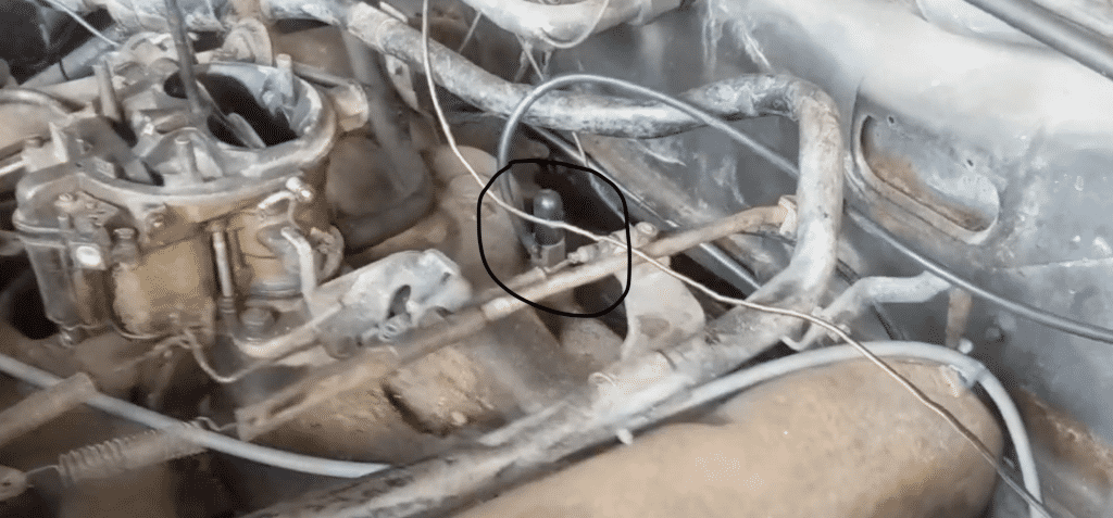

UPDATE THURSDAY 6:30. I hooked up the vacuum gauge. The car reluctantly started, but when it got warmed up, it seemed to idle OK. AT IDLE in park, the gauge indicated ZERO inches of vacuum. As I throttle it up to say 1500-2000rpm, the thing is pulling steady around 15". Higher throttle get me up to 20", again steady needle. Once again I did the vacuum leak test of spraying carb cleaner around possible leaky areas, and nothing was found.
COIL: with the car at idle, the voltage at the + side of the coil reads around 15-16VDC. What do you make of this? It's weird.
Sound like you plugged your vacuum gauge into a ported vacuum source and not a manifold vacuum source. Ported vacuum works as you described, there's little-to-none at idle, and the vacuum begins to rise as soon as you open the throttle. Manifold vacuum on the other hand will be highest at idle, and drop off as you increase the throttle. You'll need to find a manifold vacuum source to get any useful readings from a vacuum gauge at idle. Ported vacuum sources are generally located above the throttle plates, whereas manifold vacuum sources are located below the throttle plates.
If you can't find one on the carb, you should have a fitting at the rear of the intake manifold with rubber hoses or caps on it, you can remove a cap/hose and plug in there.

You don't measure engine vacuum using the tube going to the distributor vacuum advance diaphram. The vacuum in that line is ordinarily zero at idle, it only kicks in later during higher rpm operation when you're driving around.
Most carbs will have other ports that will be capped that will give a good / correct manifold vacuum reading. If you can't find one, then look at your brake booster - if there's a nipple port on it for a small hose (it could be for some interior vacuum operated gizmo) then pull off the small hose and attach your gauge to the port. Be careful, it's going to be a plastic fitting, don't break it. Or - follow the big line from the booster to where it connects to the intake manifold. Sometimes there's a small steel nipple coming off that port.
A really good vacuum at idle (idle being 600 rpm if you can manage that) is 20 inches if you're at sea level. If you're at a higher elevation, drop 1 inch for every 1000 ft. A really good vacuum is 20, an acceptible vacuum reading is 18. Your distributor timing setting will play a huge role in this. Set your idle timing to be 10 degrees BTDC. Make sure your timing marks are clean and readable. Next will be the idle screws mixture setting. Normally you start by screwing them in all the way (not hard! don't tighten them with force!) and then back them out 1.5 full turns. Then when the engine is warm, at idle, back them out another 1/2 turn and see if that improves engine vac reading. If you turn these, and the vacuum goes up and the rpm goes up, then that's the right direction.
