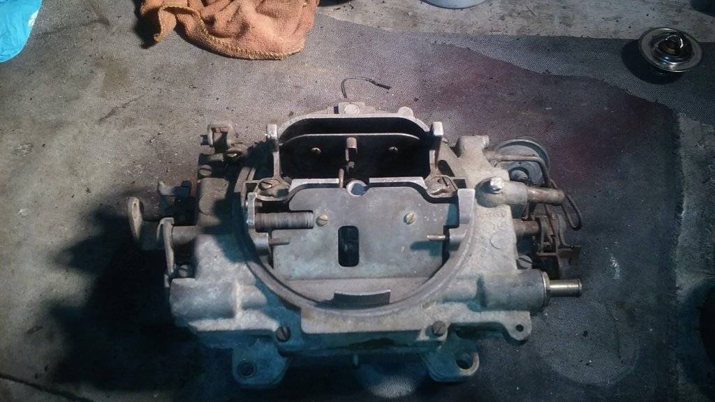

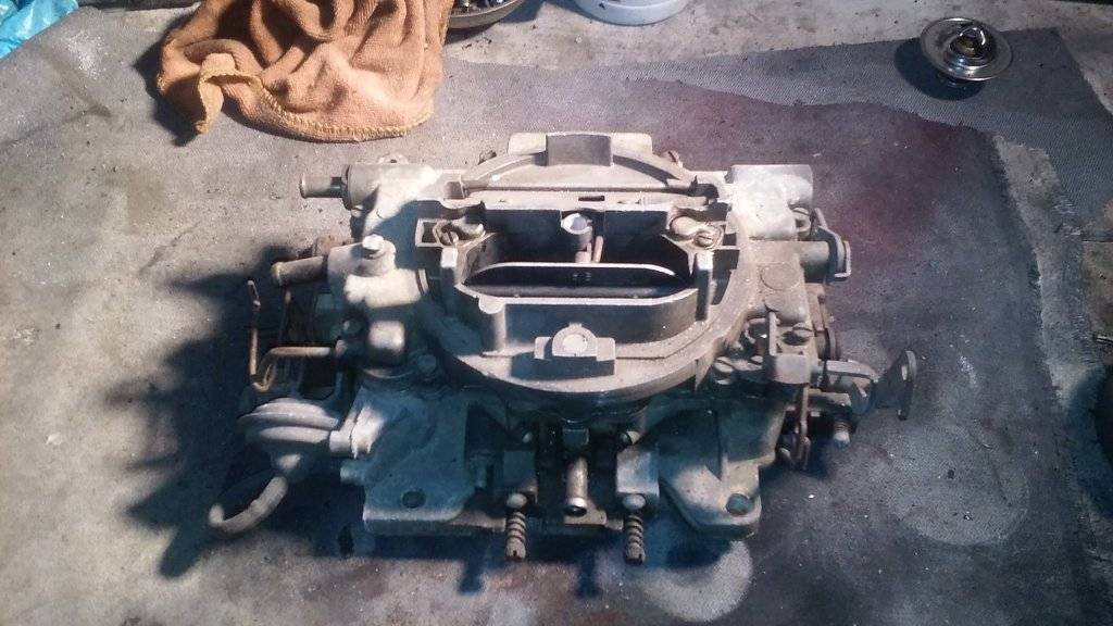

I have an AVS 4966s carb that needs to be gone through. It worked but has shelved for a few years. Make me an offer and come get it.
