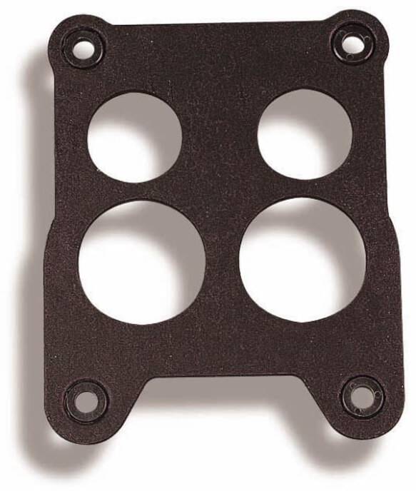

Over the years, there have been various types of carb base gaskets/insulators which were SUPPOSED to help hot re-start issues, NOT only on Chrysler products, but also Chevrolets and such, too. Some were more heat deflectors of aluminum with soft gaskets on each side. Holley sold some like that as there were also some OEM GM items, too. The MIGHT deflect some of the heat crossover heat from the carb, but whatever heat is not deflected is caught by the air cleaner assy, I suspect.
Mr. Gasket also had some insulator stacks, alternating aluminum pieces and soft base gaskets for a build height of about 3/8" or so, or basically the thickness of the normal OEM insulator base gasket. EASY to crack a carb base, even if you are careful . . . which I found out myself on my '70 DH432N AVS. Looks good, but "not good".
There used to be some wood insulators that the racers used.
My best experiences have been with the OEM-style thick paper gaskets with plastic or metal bushings in the carb stud holes (to prevent uneven torque on the nuts). Available in Holley, Edelbrock, or possibly other brands. Open center, divided center (as is OEM on my '70 383 "N" Monaco), or 4-hole versions.

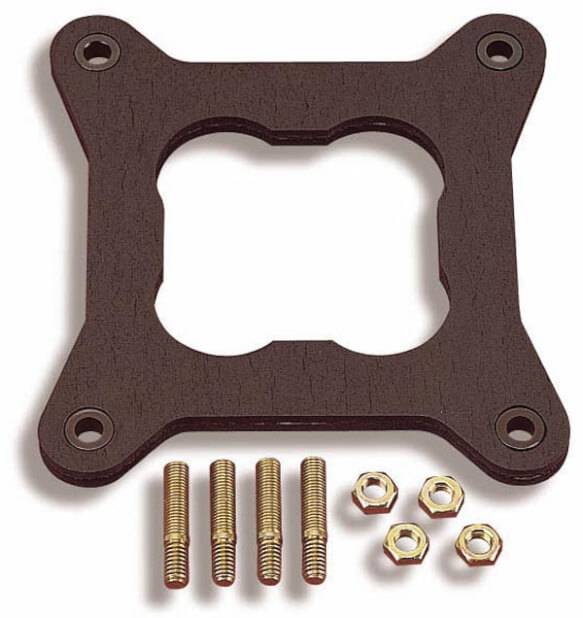

Phenolic spacers worked for me. 1/4" thick. About 15 deg cooler carb temp (with a IR heat gun) than before. I would have gone to 1/2" but it didnt fit under the hood. But I have the unusual luxury of a big air cleaner that holds the heat around the intake. Like the other guys are saying there are probably other reasons you and I are having heat issues that should be solved but until it gets ironed out you can certainly try a spacer. If you cant find a premade one you can make one out of a small sheet. That's what I ended up doing for 1 of the carbs. You can paint it if you dont like the brown edges. And you likely will need longer mounting studs.
