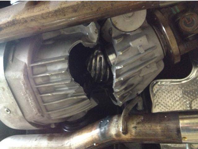

Pretty tough to get enough traction on a street car to break one. That's not the weakest link anyway, the axles usually break first. Or, in my case, the differential case just snapped in half.

Were you running stock diff?

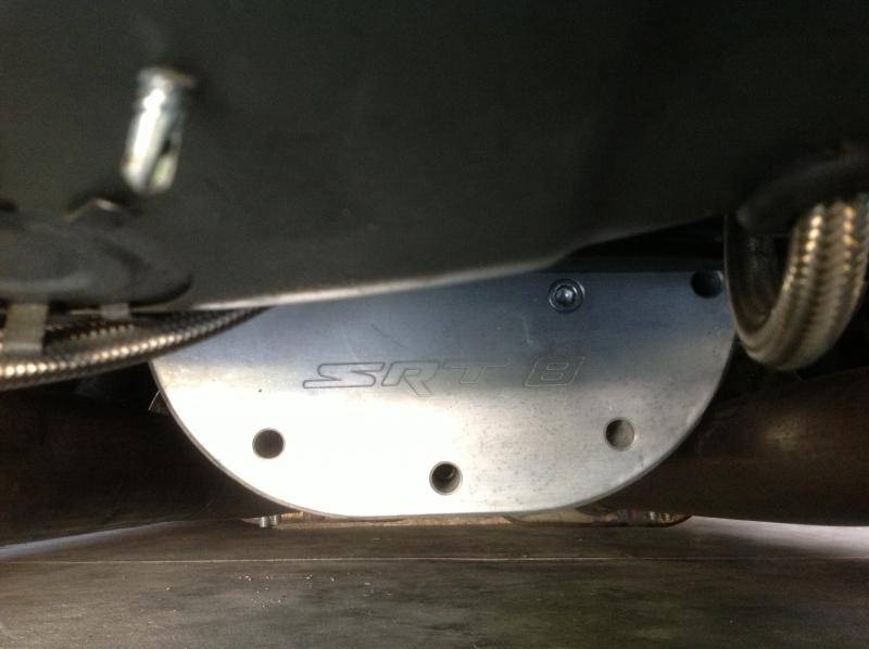

Nope, aftermarket 8.8 in an aluminum case. Very first attempted pass on a 200 shot. Had to go to a billet case.

Here's the new one... A bunch of passes in already spraying 200 right out of the hole with no issue.
