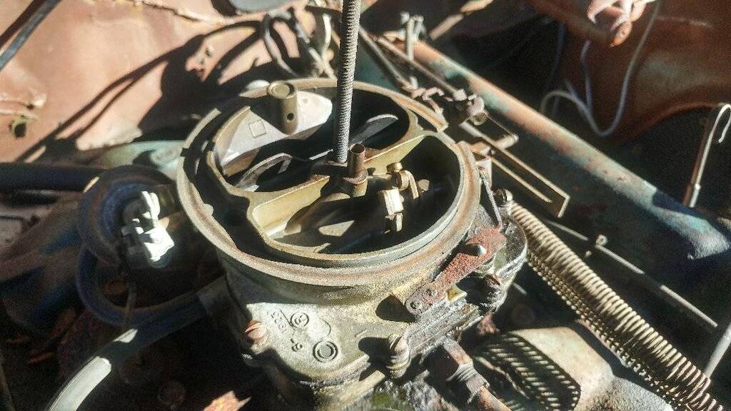

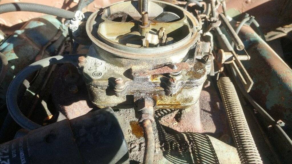

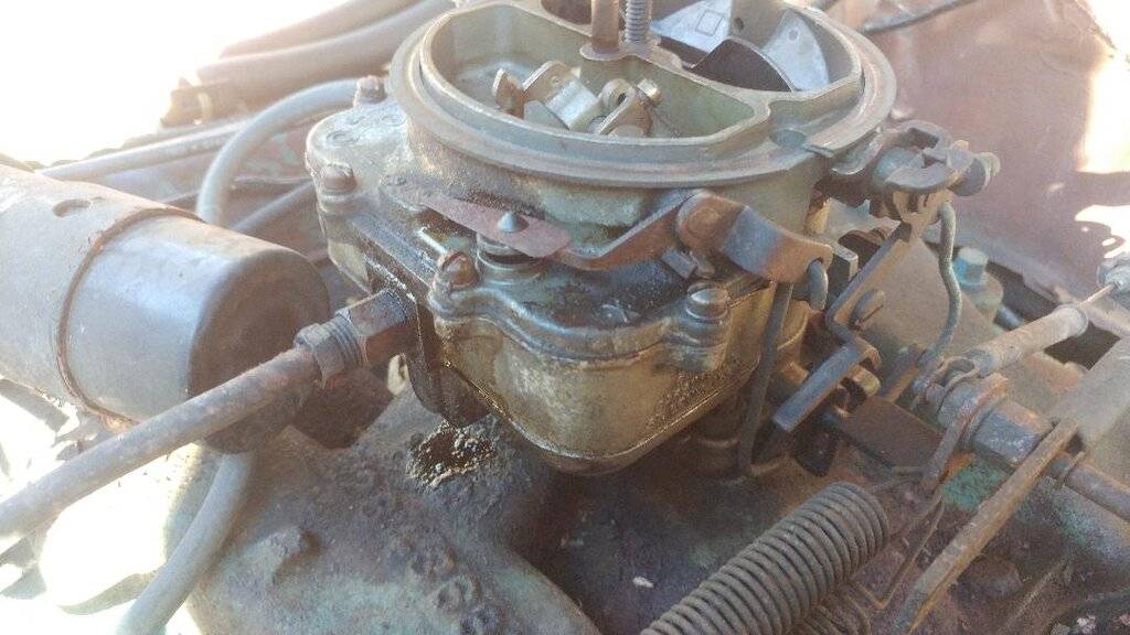

It isn't puking fuel. But there was a fair bit of grime around the vent. I'll post a few photos I took earlier. Maybe they'll mean something. Maybe not.
EFinMD
Nov 1, 2021
15
3
Maryland
These photos help?

There is a small puddle of fuel below the fuel line connection, probably a bad gasket between the fitting and the carb body, Carb should be taken off and soaked in carb cleaner, disassembled and a rebuild kit installed. Modern ethanol blend fuels pick up moisture and leave a lot of residue as the fuel evaporates. These fuels also eat up the leather accelerator pumps found in these older carbs and corrode the lead seams on the carb floats. I think this carb, once cleaned up will be good with a new float and kit.

I would say, if you're feeling adventurous, take the carb apart and put it in some acidic soaking agent for 30 minutes or so and see how it cleans up. Reassemble with a new kit, accelerator pump, and look at the specifications if any of the carb's linkages or choke equipment needs adjusting. If you can, also adjust the idle mixture, since that looks like the BBD design that had the blocked off idle screws - those were set lean for emissions purposes.

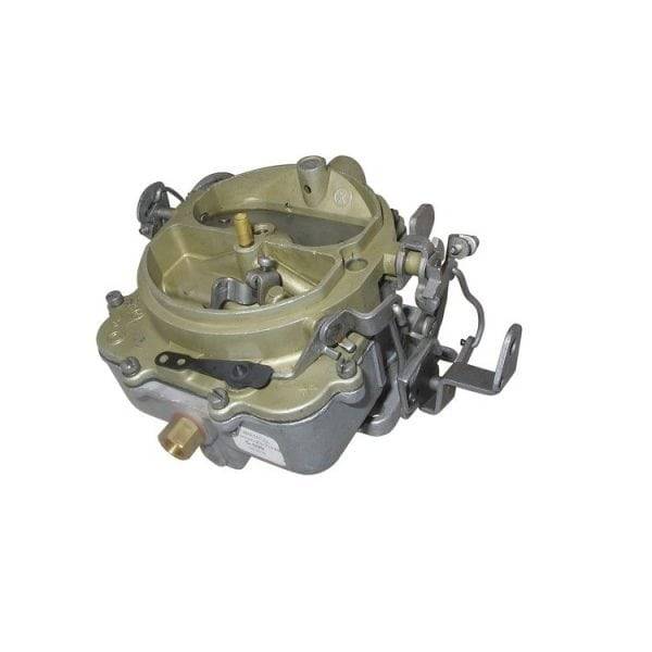

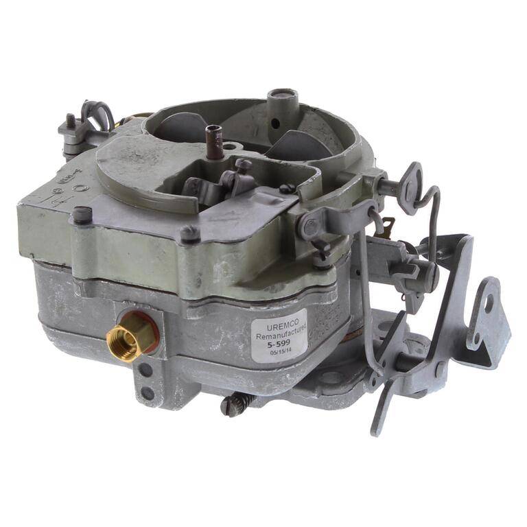

Okay. Really last question for the night. (Maybe) Still looking at Uremco options. When I look at that Uremco replacement, I get different pictures depending on the site. The top photo is from their site - and this looks pretty much exactly as the Carter. The second photo is taken from an eBay auction. The difference there seems to be the silver button where the vent is. The third photo is from Summit Racing. When I called Summit they couldn't account for the discrepancy.
