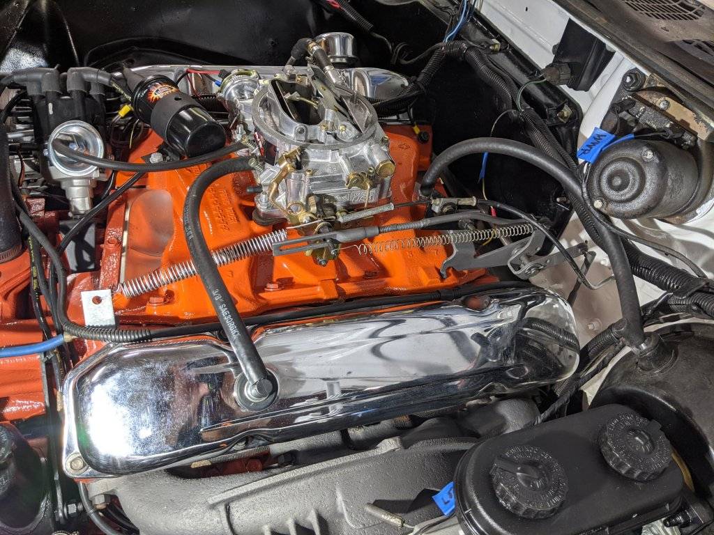

Having a 440 built. Bored.30 Promax heads, mild Melling cam. Looking at carbs and wanted some expert advice. Here are the two i have been looking at:
Suggestions or other options? Thanks-

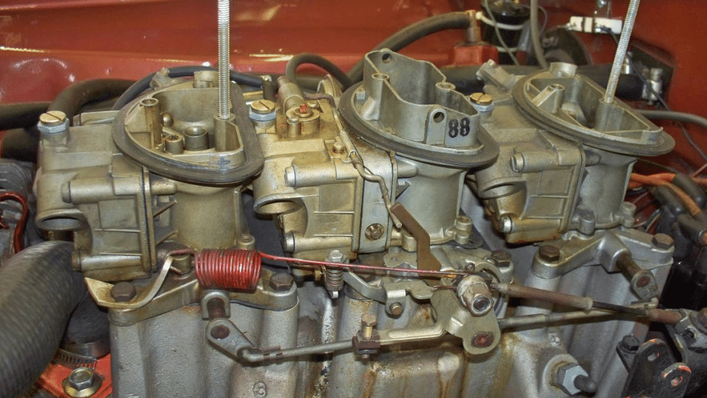

Chrysler's best C body efforts yielded the 440-6 pack setup in the 1970 Plymouth Sport Fury C body models and you could duplicate that package for your car for around $3000 plus possible rear end ratio, torque converter stall speeds etc. changes. It all depends on how much money and effort you want to put into your car..........

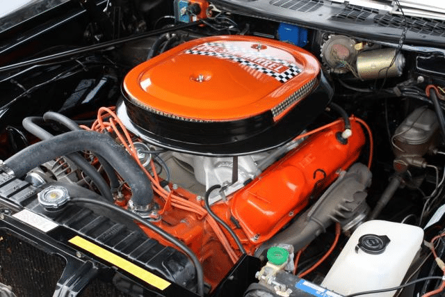

Here is a photo of that 440 6 pack setup in a Sport Fury GT:
I also have that set up in my 1970 Cuda and although that car is some 600 - 800 lbs lighter than a C body, it does run excellent with its progressive throttle linkage and vacuum operated secondaries as shown in more detail above.

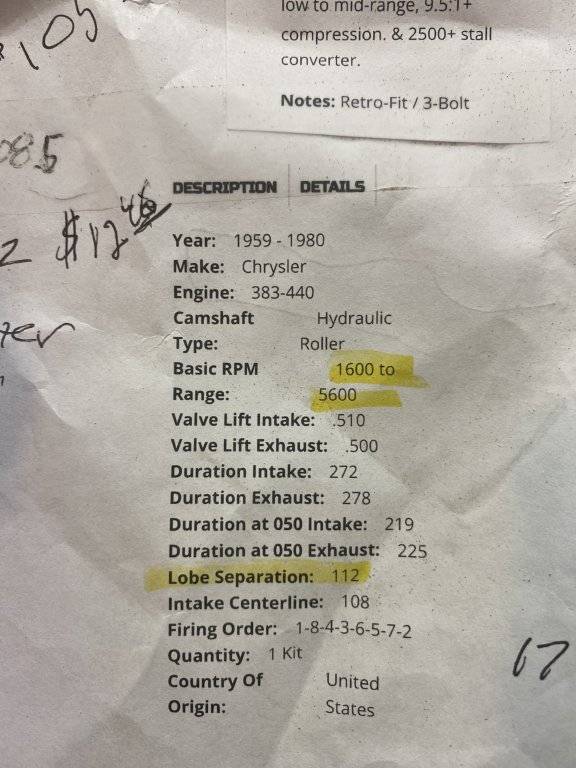

I lied that cam above wasnt available. I ended up getting The Melling MTD-2 is a 1200-4700
I came within a pubic hair of buying that cam for my own project! It's very good for low end stuff. You needn't trouble much over a big gulping carburetor with that cam either. Calculate the volume of air you will need at 4700 rpm if you will...... I chose Summit's SUM-6400 for this particular job, as it comes VERY close to the stock 1966 specs. This I want, using the 915 closed chamber heads. These RV cams do well with closed chamber heads in general, which are ideal for popping lots of torque at the bottom end of the revolutions, good idle vacuum and such. Keep us posted about that MTD-2, as I might yet want one for my 400.
