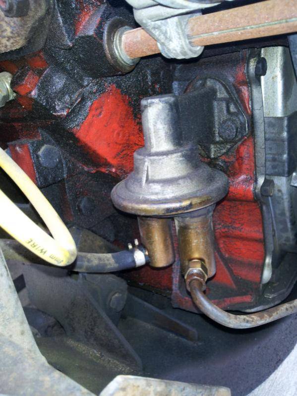

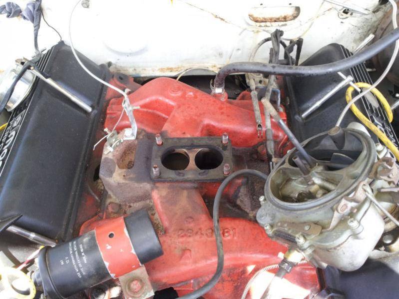

Todays project - R&R the fuel delivery system from the mechanical fuel pump to the carb, including installing a reman carb.
Standard issue carter 2bbl 5-599. going on top of a stock '68 383 motor.
So the one I took off has a manual choke, on a wire, to a control under the dash - all addon stuff.
The new carb has a vacuum choke (I think,, its in the spot where the manual choke wire hooked up before - a little round diaphragm thing with a hose going to a carb vacuum port).

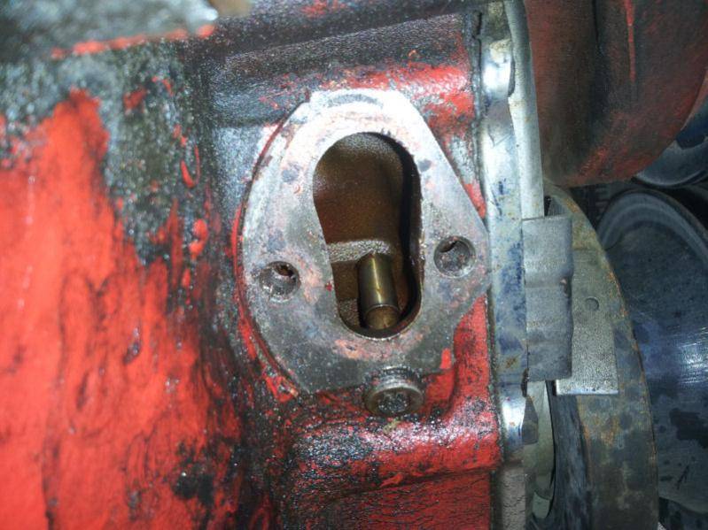

inside-fuel-pump-housing.jpg this is where the fuel pump goes... is that thing in there the pushrod? how on earth do I get the fuel pump arm under there? im not 100% sure that's a pushrod... I need some advice-for-dummies level advice please. it didn't feel like the old pump was under that thing,, old unit removed easily, and I didn't hear anything clunk or move or anything...
ok after a bunch of study,, that maybe is the pushrod. remove allen bolt, and pushrod is supposed to come out. check for wear. I expect mine is gonna be wore out. airtex PN # FP1021 and mopar MP P529569 pushrod ( 3.242").

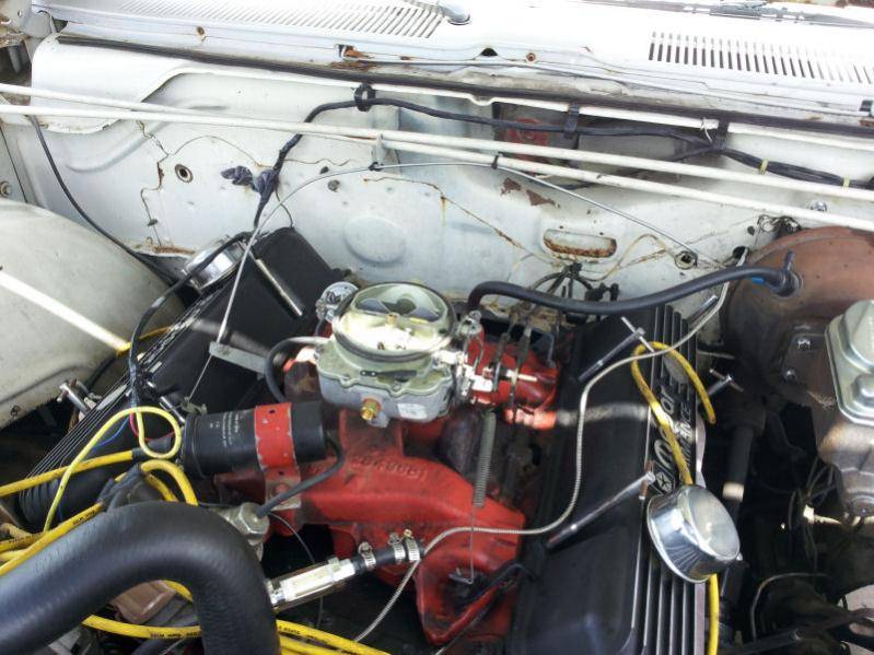

carb is on, fuel pump is on, lines are run, no leakys.
For the fuel pump pushrod - it does not lift 'UP' vertically - it slides on the horizontal plane. dont ask how long i tried to pull up on it....
i was able to catch it with my thumbnail and slide it back, fuel pump dropped right in.

right now im trying to learn about the 2bbl carb adjustment - it wont idle. it will run rough-ish, starts alot easier, but wont hold a low idle.
which screws do i start cranking on ??

another something I learned. we were trying to make our idle and mix adjustments with an open carb. then for whatever reason my helper says 'what if we put the snorkel on?'
it revved up 1-2k before we even got it totally on there... who knew??!?
so we started adjusting the carb screws with the air cleaner and snorkel on the car. got it a lot smoother, but then it was surging for fuel,, and we packed it in, figuring that I needed the fuel pump pushrod.
with it surging we couldn't get it to keep an idle, and we were trying to set the damn idle screw, so we punted.
