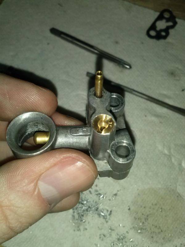

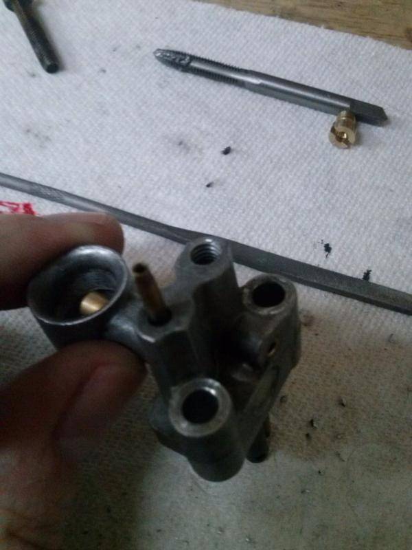

My standard air Bleed size was about 0.058" and the wire I used was 0.021. I got me a 10-32 Tap, took the primary Boosters out and modified them for changeable Idle air bleeds.
The problem was, that there was not a lot of material to have them nicely sourrounded by the Venturi... and having the Air bleed sit on top wouldnt work because the Top of the Carb would cover it up. I went ahead and used the dremel to cut away the rest of the material and it turned out pretty nice, after that i realized i could have just used some brass set screwes with a hex and drill them my own:BangHead:. I had ordered some 0.070" Air bleeds which turned out to be too big but with the wire still inserted gave me a very good sensitivity on the Idle Mixture screwes and it got my off idle to almost 14.7:1, right where i wanted it. So now I have to figure out how to calculate the right air bleed size the right way without using the wire. I figured I need some 0.054" Air bleeds or so...

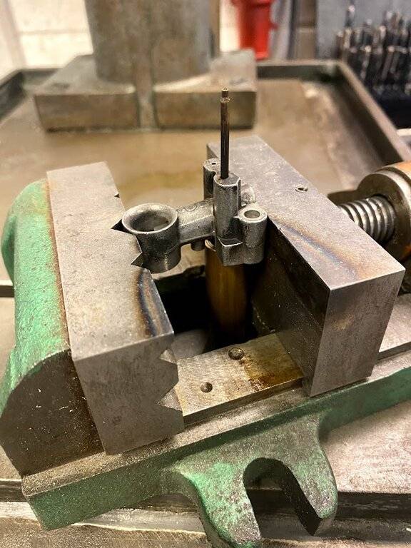

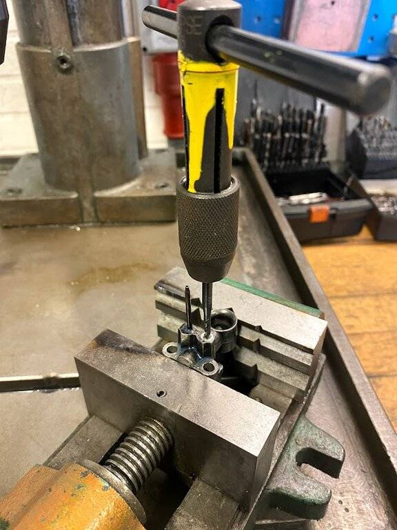

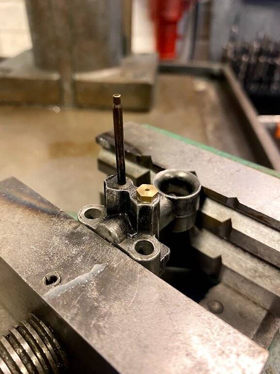

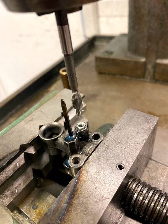

I went ahead with the mod yesterday. Ended up making my own air bleed jets. Since my secondary air bleed was already 0.053" (as you ended up with), I made mine 0.047" (Ø1.2mm). Testdrive hopefully this evening. Pictures will follow, if it is not a fail.

This is just "kissing" the surface with a step bit (unsure of this is correct english word), to make sure it is perpendicular to the thread and flat.
