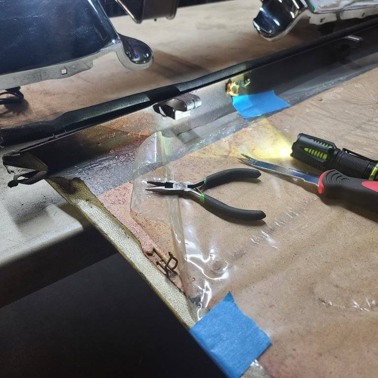

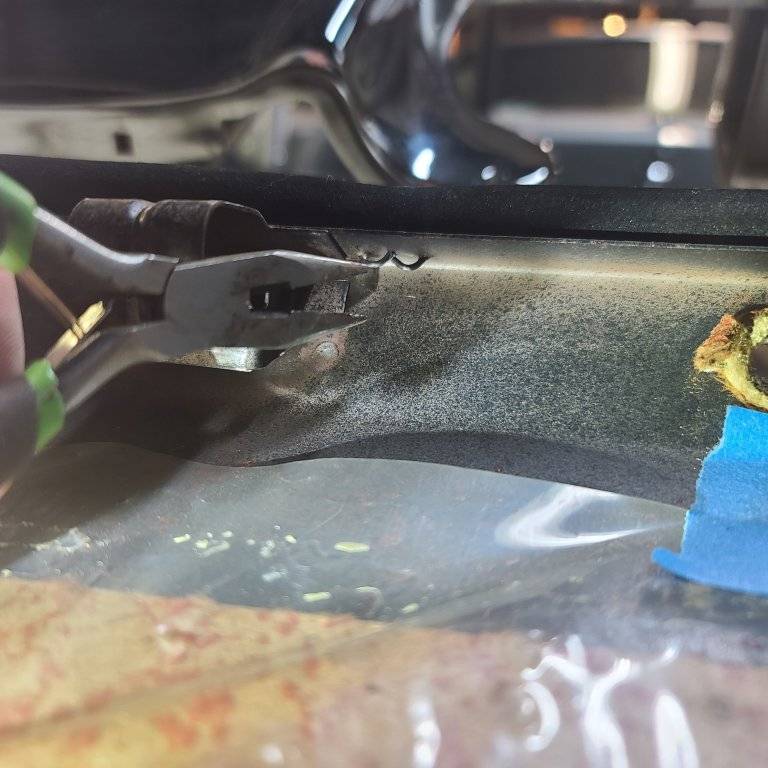

Since the re-pops don't have the staples, what I did to make the new re-pops work was first, gently pull the staples out of the door card.

Besides the staples not being on the re-pops for the 71, there are other noticeable differences when seeing them side-by-side.

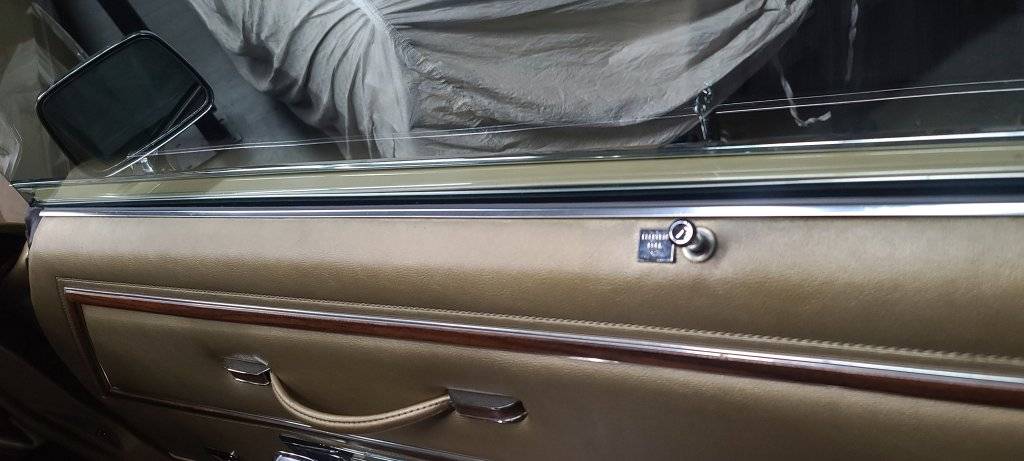

The new whiskers turned out to be a nice fit, and the Shoe Goo is still working fine.
