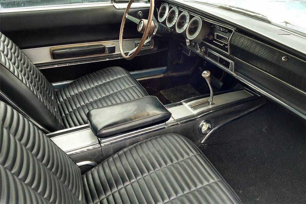

Thanks Jer but I got my answer. The one in question is for ‘66-‘68 Polara & ‘67 Charger.

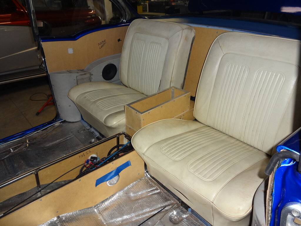

I used a 67 Charger rear console arm rest on a custom built rear console in a 57 Chevy built for a customer.

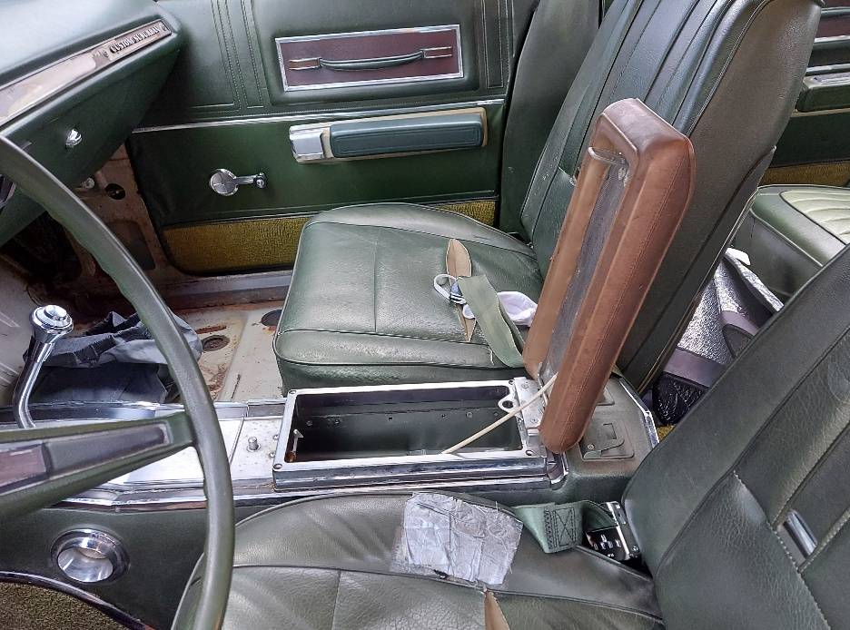

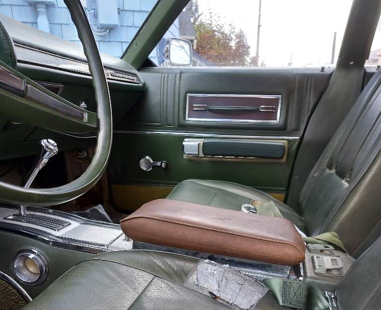

It’s this one that I had a question about.

Mines a 67 and it opens front to back. My buddy’s 68 was the same.
OK, those pics really edum'cate me on how they open - I can see how much the rear hinge is raised up to permit the lid to clear what's behind it.
The back underside of the padded piece also has an upward indentation in it which allows for the extra clearance. There’s a single spring wire that serves as the hinge pin so when you hit the button (just in front of the lid) it springs up in the front. Then you lift it the rest of the way open.

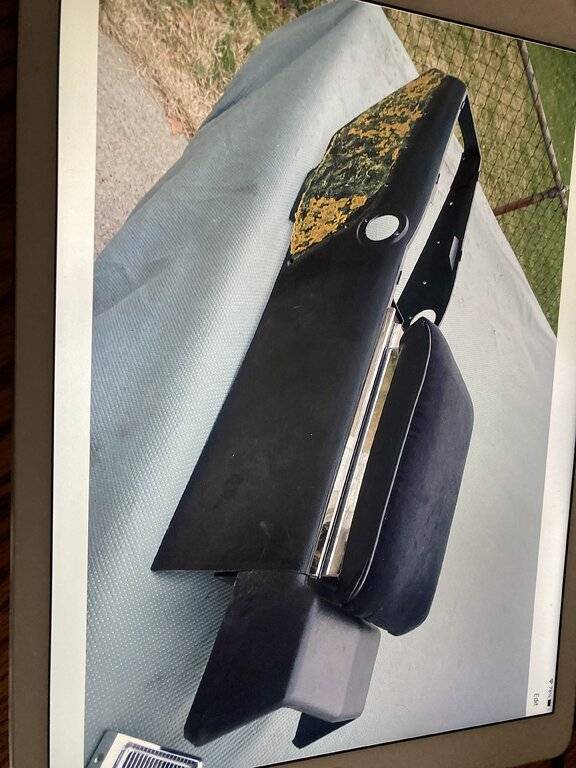

I just finished redoing mine and it’s not on the console or I’d take better pictures.
