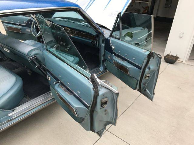

Do you know if there is an SEM paint color available for the pictured door panels?
I’ll bet you a soda they do. I bought mine at National Parts Depot. I think there was 20 or 30 types of blue in the Ventura store to pick from but I’m sure they have more than that you can order on line. I didn’t do a color match I just picked the best teal blue for me.
