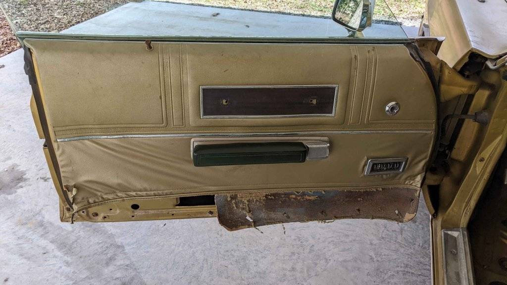

If I found a 71 Fury door panel, electric windows, any recs on how I could change color to correct gold? Thanks, Ben

Thanks for all the responses.
I watched the prep video.
Paint mixing is going to be the real challenge to match H5Y5 High grade cloth and vinyl bucket seats, medium gold interior trim.
Any idea how much the paint mixing costs?
Do I need to buy a spray gun?
