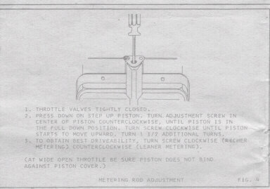

The Carter ThermoQuad is not a difficult carb to rebuild, IF you know what you've got. Many people consider a "carb rebuild" to be a generic labor operation that anybody can perform, unfortunately. AND those things are not inexpensive, either. Obviously, if the original problem still exists, the "rebuild" did not fix it OR discover WHY it is there in the first place.
IF the "bogging down" happens just off-idle, as the throttls is opened, like it accelerates then falls flat on its face, so to speak, that CAN be because a prior rebuilder left out the power piston spring and the second rebuilder did not know it should have been there. An easy check, though.
With the engine stopped, remove the air cleaner and then look to the center of the carb air horn, just behind the choke plate, to the driver's side from the picec of linkage that attaches to the choke plate there. You will see a triangular-shaped piece of thin, flat metal, secured with 2 slotted-head screws. From the side of that plate, there should be a thin "arm" extending from each side of the barrel that plate covers. With the engine off, the arms (attached to the power piston) should be level with the top of the air horn, such that they can be depressed, both move together as one, and then spring back up to their "zero vacuum" position. IF they are sunk down, there is no spring under that power piston, which means the primary metering rods are in the "full economy" position and stay there all the time. No power enrichment with higher engine speeds or anything faster than hot base idle.
It will be your task to check this and report back, when you can, with what you found.
Withi the metering rods in the "full down" position, the car should still start and idle as normal, just that when you throttle into it from idle, it does not respond as it should. IF you take off from a red light, all acceleration stops as soon as the accel pump shot is used. IF you go to WOT and hold it there, the engine rpm will build slowly until the secondary air valve will open. At which time the rocket thrusters kick in with more fuel.

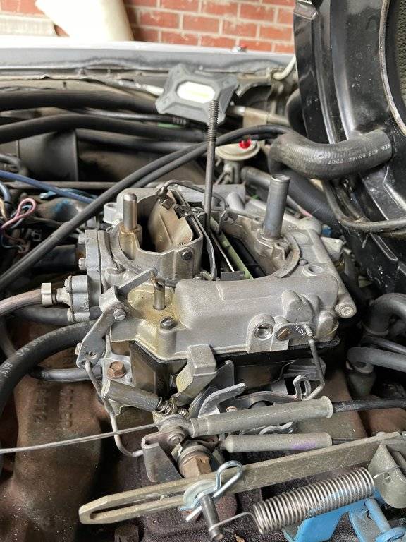

Take a picture of the carb from both sides and post it if you can. I have seen general repair shops zip tie/ wire open the secondary air door. I would also like to see what carburetor you have. I leaning to push rod and tune. Here is a diagram of the step/power piston set up.

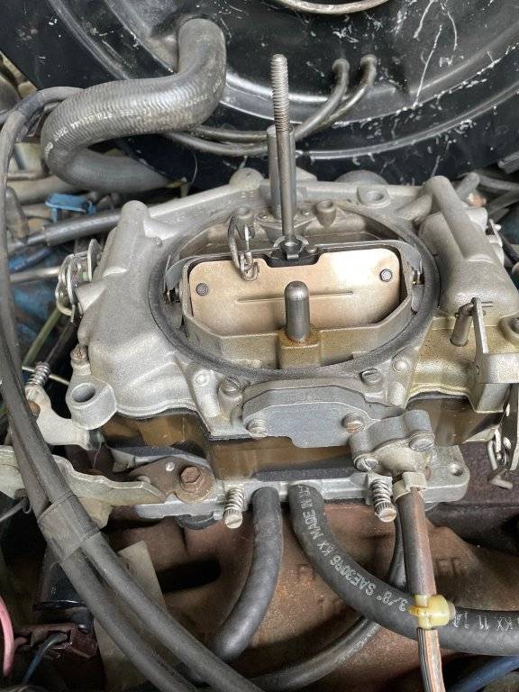

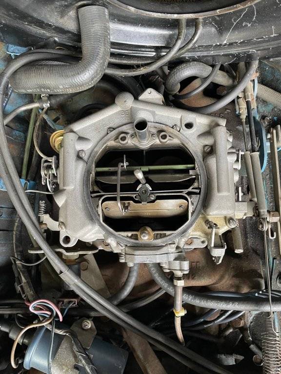

Pictures of the carb is added. I notice that the secondary is open until I actually start the car and then it closes. It feels like there is no tension on the secondary. It dangles until the car starts.
Your secondary air door is too loose. Do you know how to adjust the door with out unwinding the spring?
