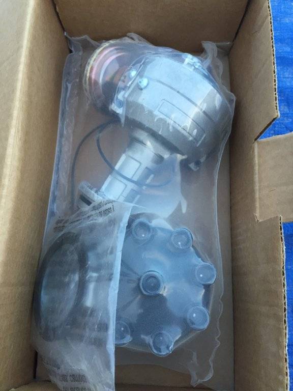

A quick question. I have a new distributor that came with my car when I bought it last year.
I did not install it but swapped out the distributor cap and rotor (it was running poorly and I was trying to help teach my daughters, who are getting near driving age to learn basics like changing plugs, wires, etc but one thing at a time to see how each individual thing would affect the car’s performance).
Yes, it took a lot longer than I would have liked and some tears (like when one daughter broke a spark plug off trying to remove it).
Oh right, I did say quick question... (preamble aside)
Q: Can I just remove the old distributor and install the new one (without finding tdc first and using a timing light)?
I don’t have a timing light, no one I know does, they’re more money to buy than an electronic ignition here. No dwell meter.
The car is running poorly and it seems like it’s the points (never changed those) and since I’ve got the distributor instead of buying new points I’d like to install the whole distributor assembly (since I already have it!). It was a nice find in the trunk of the car, the seller never mentioned he’d bought it.

Check the point gap on new distributor before you put it in (easier). I would just bump the engine over (screwdriver across starter relay) till the timing mark reaches TDC, then make sure rotor is pointing to #1 on cap (if not turn crank another 360°). Now pull the distributor, yes it takes a few seconds more but if something is wrong at least you know you started in the right place.
You know your timing will still probably be off. You can time by ear and pinging and be okay.
Assuming your car is a chrysler product, the short answer is yes.
Just pop off the distributor cap to see where the rotor is pointing. Pull the old distributor and put the new one in with the rotor in the same spot. With a mopar product it will only go in 2 ways. Correct, or 180 degrees off.
Absolutely check the point gap on the new one before it goes in. Much much easier.
That is my quick answer to your quick question. But yes, you can bring it up on tdc first if you wish.
other stuff to consider...is this distributor actually new? is it factory mopar?some parts house "rebuilt" distributors are pieces of crap built out of mis- matched parts and could result in something that has a completely screwed up timing curve...so at the very least i would check the part number on it, figure out what it came out of , and figure out where the timing needs to be set....i dont know what engine you have but a 383 and 440 distributor look identical but the shafts are longer on the raised deck blocks...if you dont have a timing light i'd be more inclined to swap the points and condensor out of it and leave the distributor position alone....down here timing lights are like $20 used as nobody really needs them anymore...do you have a parts house that rents tools?

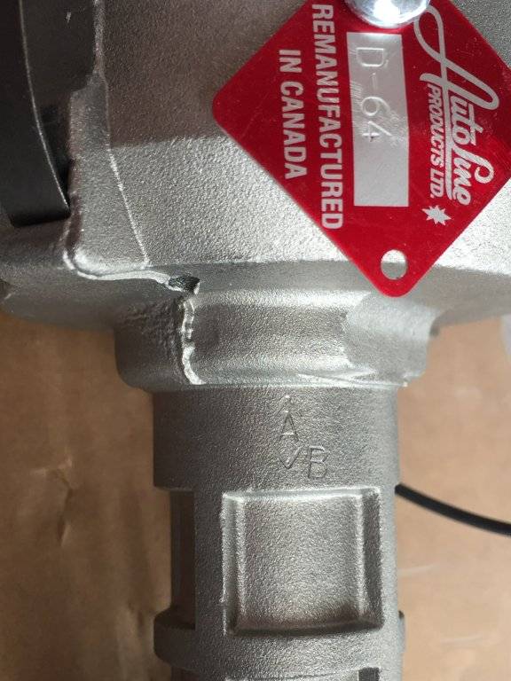

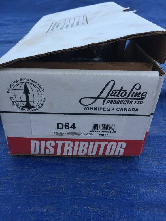

It’s an Autolite, says reman. But done here in Canuckistan. I guess it may be remanufactured Mopar. (Will it be stamped Mopar if it is?).

The only marks on it are an ‘A’ and a ‘B’ on the upper shaft.

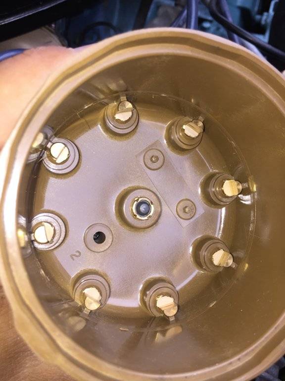

The black distributor cap IS well machined and marked ‘Made in USA’. (Brown would be better but I am impressed with the machining and casting.). Isn’t black pre-66 or something? There shouldn’t be any problems, should there? (The one on there has a black inset on the top, while this does not.

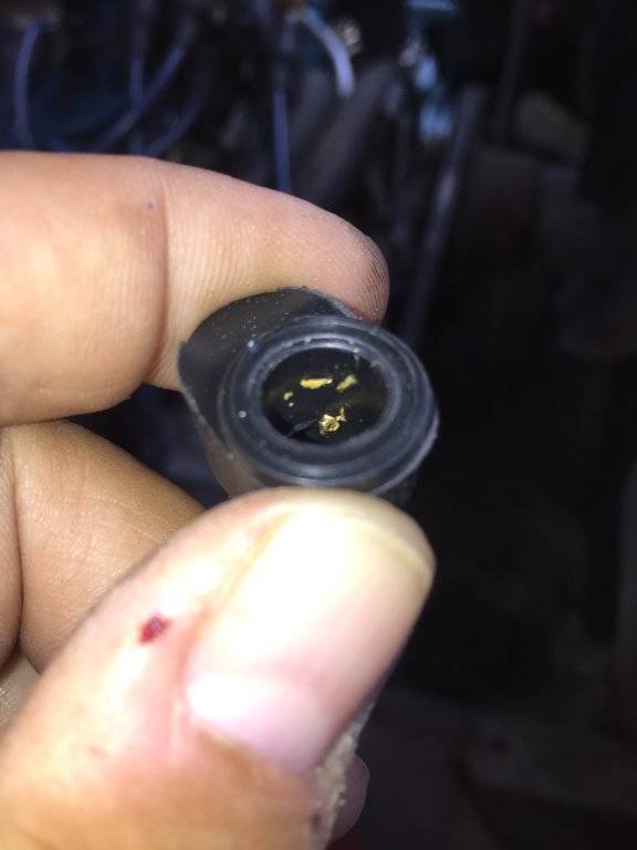

So I pulled the rubber cap off and it’s full of brash shavings from the part store (Napa?) distributor cap...
